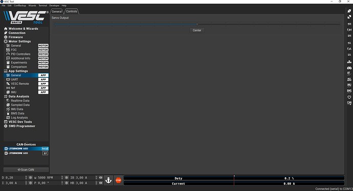

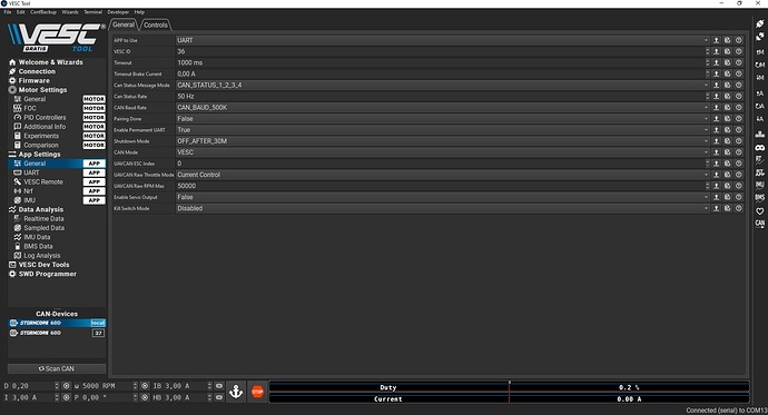

can u post some screen shot of ur current setting? mainly the app config section

Was this what you wanted?

I got it working, I has on the vesc tool messing around and I remembered to go to the App Settings- Vesc Remote, and saw that my Control type was set to Off, I switch it to current and now its all good.
I don’t have any idea why this happened, since I didn’t mess with this setting before, my best guest is it charged on its own…
