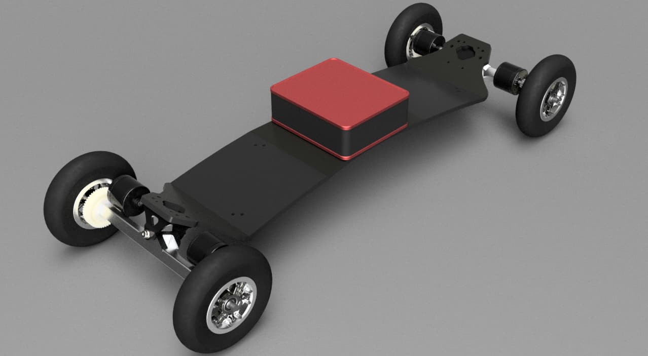

Another big idea moment.
I had started to realise that having upward facing drives means that end mounted ESC cases just wont work. They would have to be mounted so high to clear the motors that they would look ridiculous.
I really wanted the option of swappable battery so that i could have a big pack for long rides or a small pack for race events. This rules out the option of ESC’s in the battery case.
The solution seems to be a low profile quad ESC case that sits below the battery. Some quick testing showed that it may be possible to get this down to less than 20mm height, which is less than the spacer below most battery boxes anyway. Even with a 90mm tall battery mounted on top, the overall height is still less than the peli 1200 which is commonly used.
This also fits nicely with the idea of keeping all weight central and balanced.

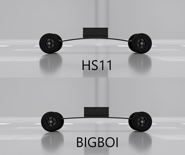

Trampa had just released the BigBoy deck which seemed to match my ideas for this board perfectly. there’s a few small geometry changes they made which i think make a huge difference over the standard deck.
Firstly, its wider. no need to add extra wings to stop your toes falling over the front edge.
Secondly, the deck is flatter. This means no more footache from the over exaggerated arch found in the old decks.
Finally, they moved the bend closer to the trucks. This seems small but its kinda important. It means that you get more flat space on the deck, allowing for a wider foot stance without increasing the wheelbase. It brings the weight of trucks and motors closer to your feet. It means there’s more space between the bindings for a bigger battery if needed. It also means you get more ground clearance near the deck tips.
Got one straight from the first batch. Initial impressions are good. really like the shape. shame it looked like they played football with it in the warehouse before shipping it, but i guess i was only going to trash it anyways.

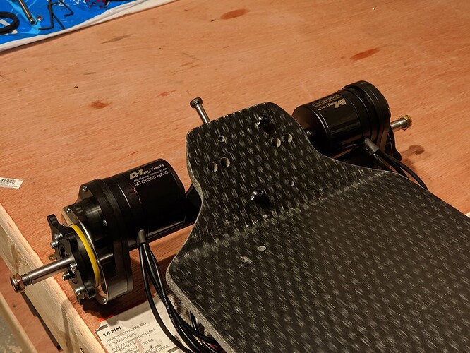

‎04 ‎March ‎2020
Very exciting day. The @3DServisas parts arrived for our group. A lot of design, planing and organisation finally paid off.
I couldn’t wait to get my parts unpacked and assembled.
Quickly got a set of drives mounted up on a hanger, with some motors fit loosely in place.
That assembly got put straight on the BigBoy.
Suddenly its starting to become a reality. Its still early but im really starting to get a feel for how slick This board will look once its fully built up.
But also a reminder of how much further there is to go. Its clear that the deck is going to need modifying to avoid clashing with the motors during turning. And precision modifying a trampa deck is no simple task.
