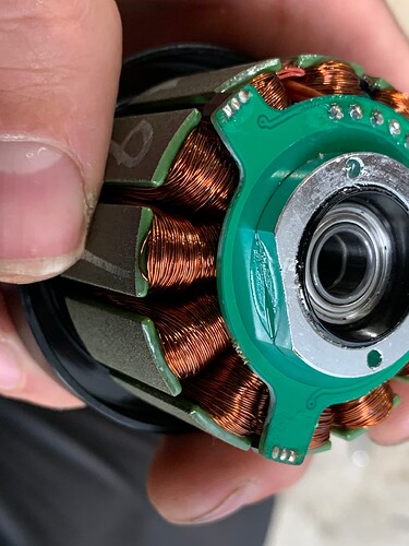

Unfortunately one of the d100s is bad and tried to kill one of my motors. One side of the front d100s cogs and overheats on one motor only. The issue switches sides when you switch phases so it’s definitely the esc. I maybe cooked a motor figuring this out. I sent @YUTW123 a message on WhatsApp so I’m hoping I can get this repaired/replaced fast.
So all in this board has been ridden about 10 feet inside the @Skyart new shop. Feels like a monster.
This is the motor that the d100s cooked. It got hot enough that it smoked a little. It still works and doesn’t look like it has fried windings, but it’s suspect for sure.

Turns out the d100s is totally fine. It was just accidentally set to control mode “bidirectional current” on the cogging motor, instead of “off”. If you ever seeing weird cogging on a motor on can, check the control mode…
Im might replace the motor anyway because I overheated it a bit before I figured this out. It appears to work 100% fine, but it smoked a little bit.
Shoutout to @zero_ads for letting me borrow his d100s to diagnose. It was only while setting his d100s up that it dawned on me to recheck the can side control mode….
