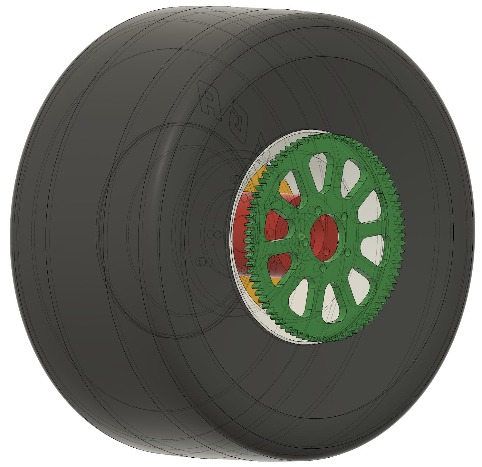

I started by making CAD designs of everything

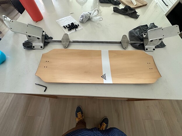

The first issue I ran into was that when I ordered from Send Cut Send for my Truck “Towers” I was told they could not bend them like the picture since it was too “deep”
So I had to alter the design to be separate pieces.
I was initially pretty worried about strength on this, but it is pretty solid, so it ended up being a non-issue.
Once I got parts in from SCS and Xometry (wish I would’ve taken a bit more time, and had everything made from SCS (cheaper and faster).
After getting my family to weld some parts for me since I medically can’t anymore (stupid pacemaker), I was able to test fit some stuff.
I Love when things go according to plan or at least close enough.

Got the hubs mounted up onto the wheels with another (not pictured) spacer.
Fitment seems good, and has just enough clearance for my 80t spur gears.

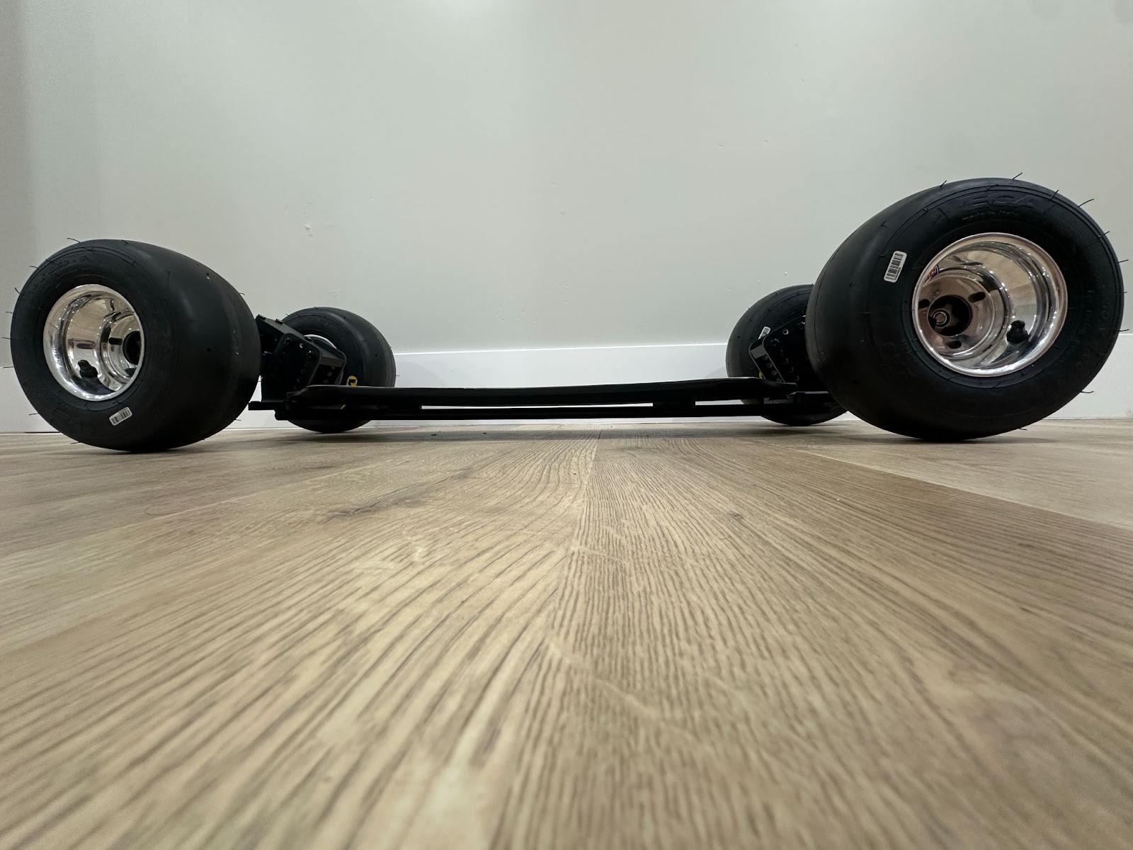

Got to mount everything to have a “rolling chassis”
I was personally pretty concerned about the ability to turn when the standing platform was about 2 inches (50mm) below the pivot of the trucks. But the exciting thing about it is it still turns amazing!
I had the chance to take @dskate Snappy build (SNAPPY | 12S6P Barrel on Duality trucks) for some laps and loved it. That was when I truly fell in love with Duality trucks! Thank you @Titoxd1000 for perfection.
Even being so low, this still turns like absolute butter.
