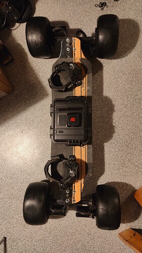

So, how do I start. Over the last year or so, since I finished the first iteration of RaceBro, I’ve been taking racing fairly seriously, been constantly upgrading my setup, trying to make it out to as many events as I could, and practice a lot. I’ve improved my riding skills heaps along the way, with just recently making it to the pro finals at esk8con on the most recent iteration of RaceBoi:
This journey of racing and building is well documented in the thread RaceBoi, which has by now grown itself to over 600 posts. That thread has also shown my lack of self control skills for building esk8s - I’m always striving for what I consider at the time the best thing that I can possibly have. And this brings us to the name of the board: PROJECT: ENDGAME. Firstly, this is so far, just a project. That has been going on for some time now and will continue to unfold over the rest of this year. Secondly, endgame. I’m hoping that by getting ahead of where every other setup is now, I can finally make a setup, that I just can’t upgrade anymore, because there’s absolutely nothing that can be upgraded on it, everything is top notch, even by my ever-evolving standards.

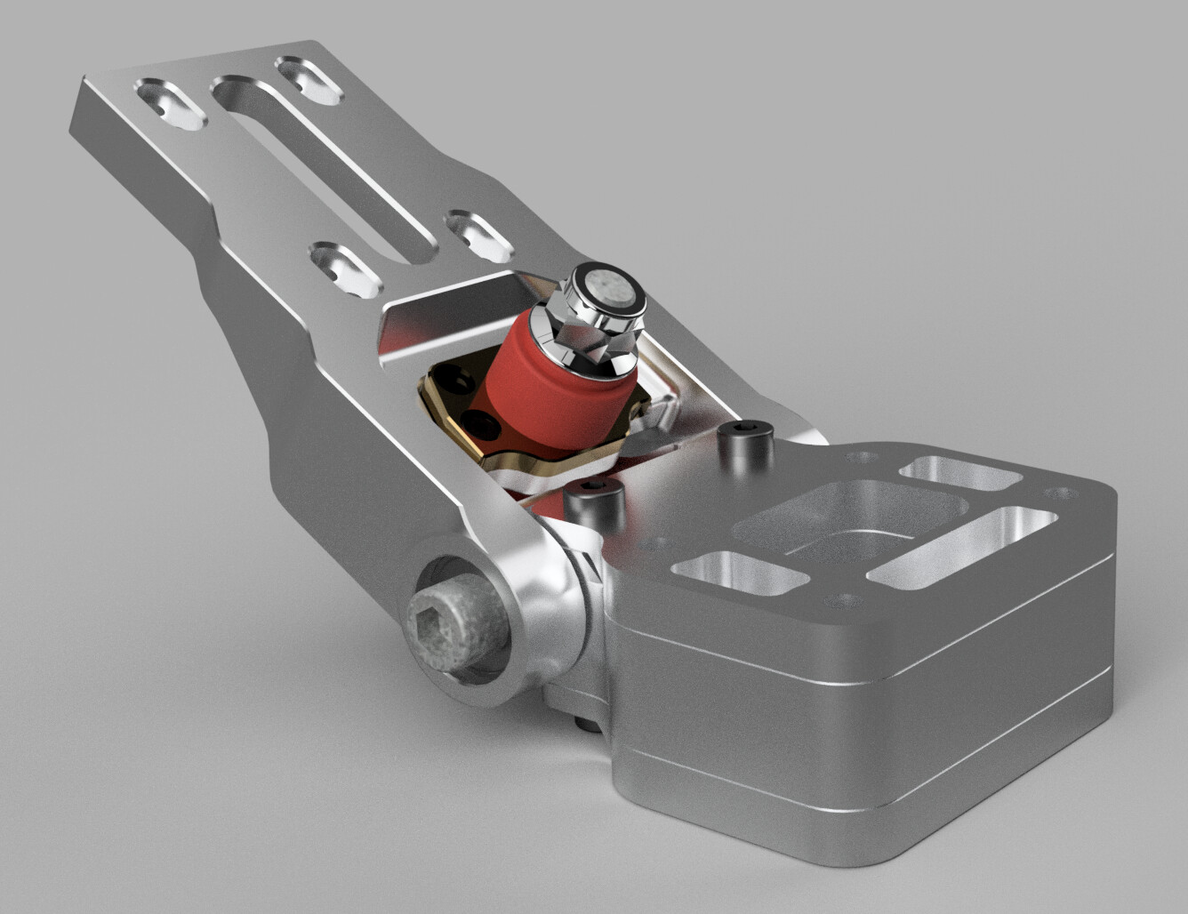

Trucks
First a little bit about trucks. I’ve tried all kinds of trucks over the years, and Dualities by @Titoxd1000 are the best ones that I’ve ridden on so far, hands down. They achieve a precise zero slop feel, they take any regular skate bushings (including WFB), they are easy to work on and can change bushing setups within minutes. So Dualities it is. But what width? Well, the kart wheels are so wide and so offset, that I want to minimize hanger width, so I went with 240mm for now. And tried to design all clearances around that.

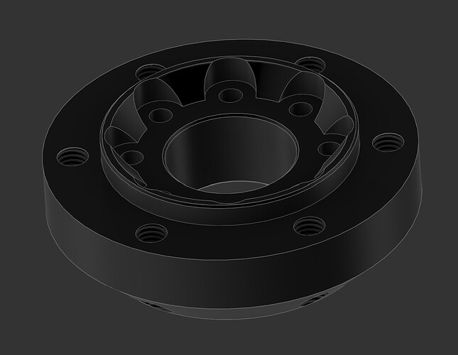

The custom MBS pattern BRP hub development from @Ac53n has given me a good start with a wheel hub - the original plan was a chassis that can swap between BRPs and kart wheels in a fairly short amount of time, so I went for these. If you stack these fully with bearings, you end up with an insanely wide bearing spacing, and they are adaptable to many setups. More about my exact bearing setup a little later, but for now the important part is that the sheer size of these wheels require me to run a very wide bearing spacing, which these do support. Afterall, they were designed to run on 17-20mm shafts, not 12mm.
At around the same time these were being designed, I found a set of kart rims which have a fairly rare 55mm centering bore, instead of the much more common 40mm centering bore of 5" rims. This is important, because this is what we needed to be able to have the BRP pattern and the kart rim pattern on one part. Meet the Righetti Ridolfi KC70AL125-67. 5" wide, 5" diameter, 55mm centering, 3x67mm M8 bolt pattern.
So, these obviously don’t just bolt together, what’s up with that? Tommy designed up an adapter for me, which gives the rims the least amount of offset possible, so they stay supported as much as possible, while still having a little bit of the bearing left for the wheel spur. Huge thanks again! I’ve got two sets of these machined, hoping to be able to swap between different tires (for example practice and race tires) within a reasonable timeframe. Or for example if I get a flat mid race I don’t want to swap tires on rims between heats, I can swap them with the BRP pattern screws.
In the middle, this can also take bearings for extra support.
So a bit about that bearing spacing now. From hanger to axle nut, this is the plan:
hanger - 1mm speedring - 28x12x12 wide double row angular bearing 3001 - 6001 regular bearing - 22.2mm spacer - 6001 regular bearing - 6001 regular bearing - axle nut. There’s 1mm extra left after the nut for perfect nylock engagement, and the Tito Dualities 68.5mm axle length is pretty much fully stacked with 58mm total bearing spacing.
Another idea that I had just recently, but might require 270 hangers, is to mill a 30mm or 35mm bearing mounting interface for the 22^2 R6 motor mount part which would take an oversized gear bearing, and shift the wheel to the insides a bit, freeing up axle length on the outside of the wheel which could be used for extra bearings for an even wider total bearing spacing (including the spur’s bearing).
Everything was test printed when the tire arrived, and it went all together, signaling that these parts are ready to be ordered from metal.

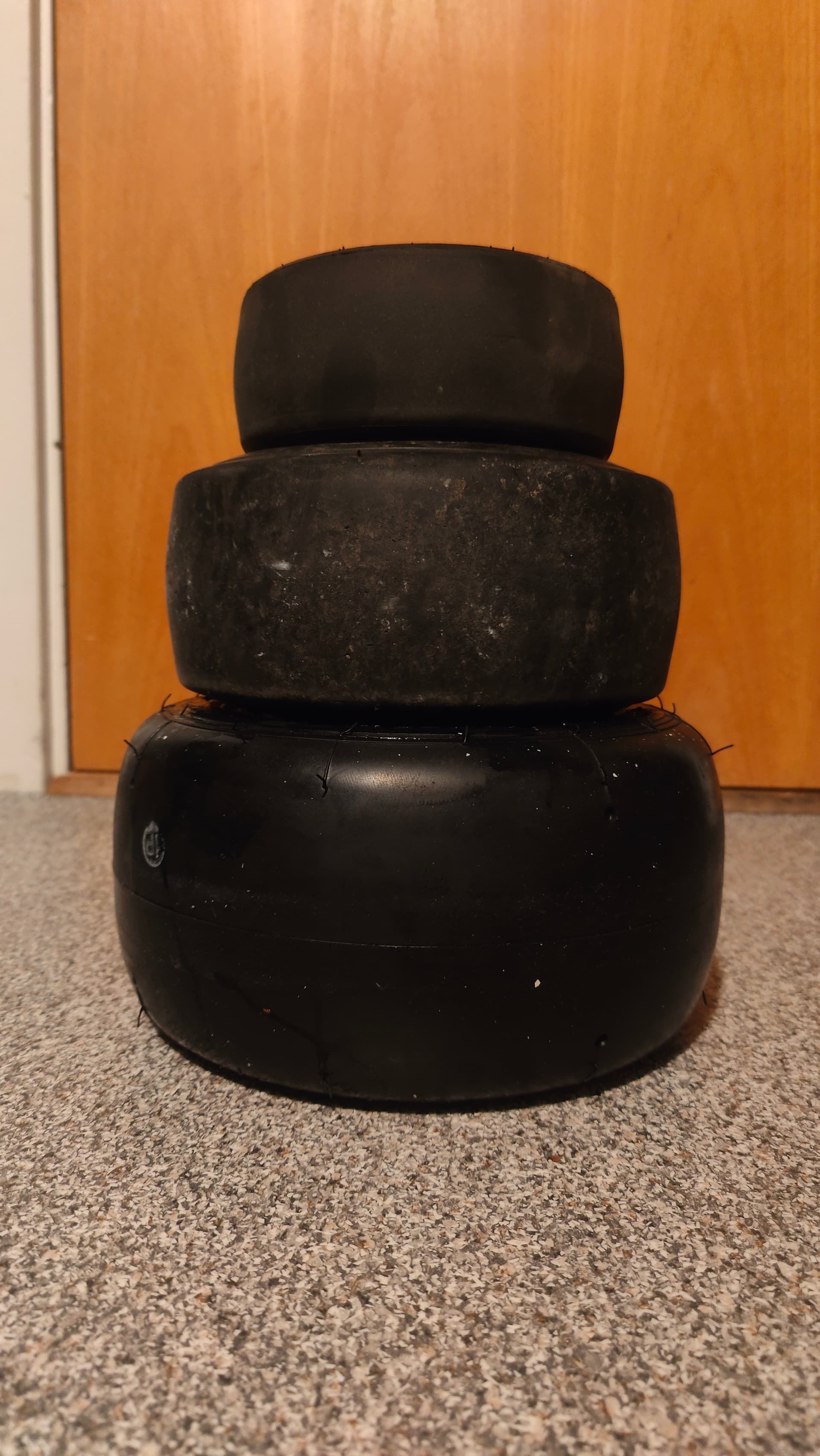

Tires
Well, I have to talk about these too, even though I am yet to ride them. The main goal of this project was running top notch tires. For now I’ve got two sets of discontinued Bridgestone YPB softs to go through, as I’ve got an 83% off deal on them. These are close to what I’ve wanted to run anyways, but not the final tire choice. Given that my board is not as heavy as a gokart, and that esk8 racing is harder on my body than karting, I decided to go for super soft compounds, as I probably wouldn’t be able to overheat them anyways. The tire that I really want to try later on are Lecont LPM, they are the grippiest tire in karting right now, and they have stiff sidewalls, which I think is what we want in an esk8. Oh and I think this is the perfect place to throw in a size comparison to more normal tires:
Linnpowers (6.5") CST C190 slicks (9x3.5"), kart setup (10x4.5")
These kind of super soft compound tires are specifically made for the higher power karts, this one is for the 50hp KZ category, as they are known to bog down rental engines too much. Another reason for an electronics upgrade.

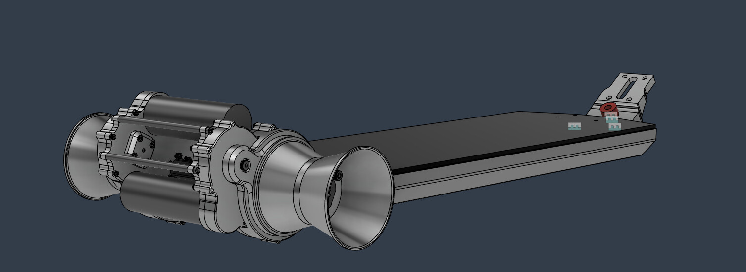

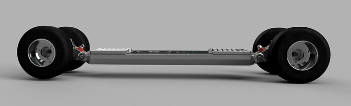

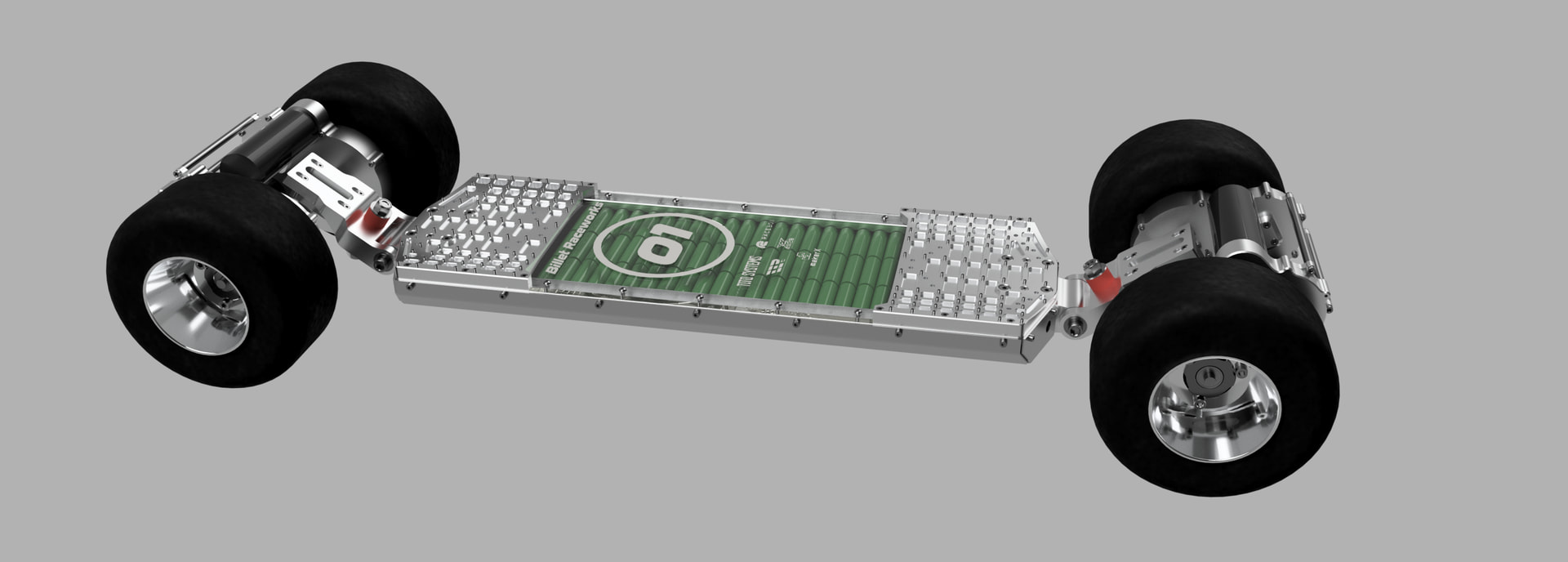

The chassis
Well, a raceboard has to be stiff and rigid so that the inputs by the rider are translated directly to steering. That calls for an all metal chassis. Also I’m not super experienced with welding, but I can weld somewhat. This made me want to avoid the V5 style tubular steel chassis. Let’s come up with something new, what are cars made of? Sheet metal. Let’s see if I can make that work. I can design for the parts to be able to take most of the load without welds already, and then the welds just make sure everything stays in place and add strength - they aren’t as critical in my design as in a V5 or something like that.
The design work for this chassis started months ago already. I set out a couple goals in the beginning: adjustable ride height, by a large range, being able to go down as close to the ground that I can scrape. (Mostly) top mount, with space in the frame for a few components - ESCs, and a small part of the battery. Standing platform length that suits my stance. Then as time went on, I also added the goal of an adjustable standing platform length, which can be used to shorten the total wheelbase by a fairly large amount. This last goal might be scrapped if it turns out not to be strong enough in FEA (finite element analysis). Early stages looked something like this:
Then I realized how I can make those ugly square towers look better:

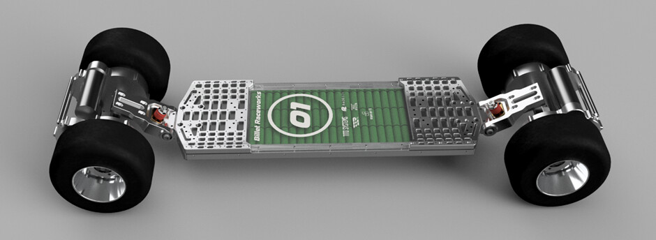

Then recently I decided to get rid of that ugly pelican while also making the standing platform adjustable length, and making the bellypan capable of taking the makerx G300 ESCs:
That’s where I currently am with the chassis, I want to confirm a few dimensions part fitment wise and get it through FEA, other than that, I think I’m happy with it. Oh and possibly trying to shave off some weight if I can. It’s gonna be HEAVY, enough so that it justifies an electronics upgrade.

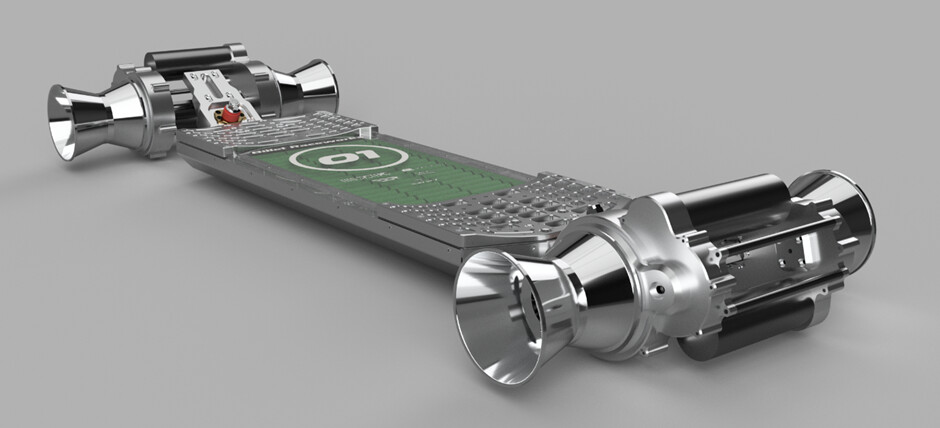

Regarding weight saving, have you considered just using conventional wood and composites for the deck? The weakest link for your steering response requirement should be those mounting towers, so throwing tens of kg of metal at the deck may not be the best use of that mass.
A regular flat deck can be made to have substantial torsional stability by layering composite fabrics at 45 degrees, and an integrated deck can be work as a torsion box in the same way as your metal rendering.
There were several other confounding factors in my case ofc, but as I made my 2-wheeler boards heavier, the mass of them was really dampened the feeling of being able to throw them around aggressively. Hopefully this doesn’t translate to a low slung esk8, but I see a bit of my own thought process in this project :joy: and wanted to throw my experience out there. Best of luck with the build!
For some reason those tires make your board looks like it’s wearing clown shoes.
Uhhh, you might be totally right. But I completely despise working with composites (after having tried it once and failing spectacularly partially due to my stupidity)
To be honest, my plan was to try to get FEA to run and then take off a little bit of weight from spots that don’t need it, and call it a day hoping that the extra total weight won’t be a big deal. And then hope to prove it during testing that it still handles well. My experience so far with esk8s where the axle is more or less inline with the axle doesn’t seem to suggest weight being a huge deal, but this would take heaviness to the next level. While also being sub axle quite deeply, which might introduce other weirdnesses that I potentially have to tune out. So you might be right.
A carbon tub should be able to do the job better, but I just refuse to work with composites. Another reason for this kind of construction is that I’d want to make this repeatable, I want to design something that I could potentially make more of in the future without an expensive and also hard to modify mold, if I want to make adjustments to the design. But also without necessarily having to put down 2-3 grand for each with CNC milled parts, like for a psychoframe.
Honestly, I do have a couple cool ideas if I were to redesign the body part of it, but it remains to be seen how much weight I could actually save.
One thing is for sure, I could make the most weight saving by giving up the adjustability. But this being a first of its kind prototype, I am not sure if giving that up as weight saving is a good idea or not.
If I don’t figure out something else then perhaps the solution to weight is just to make one heavy but adjustable frame, test the hell out of all the options, settle on one setting, and make a lightweight frame around that geometry.
