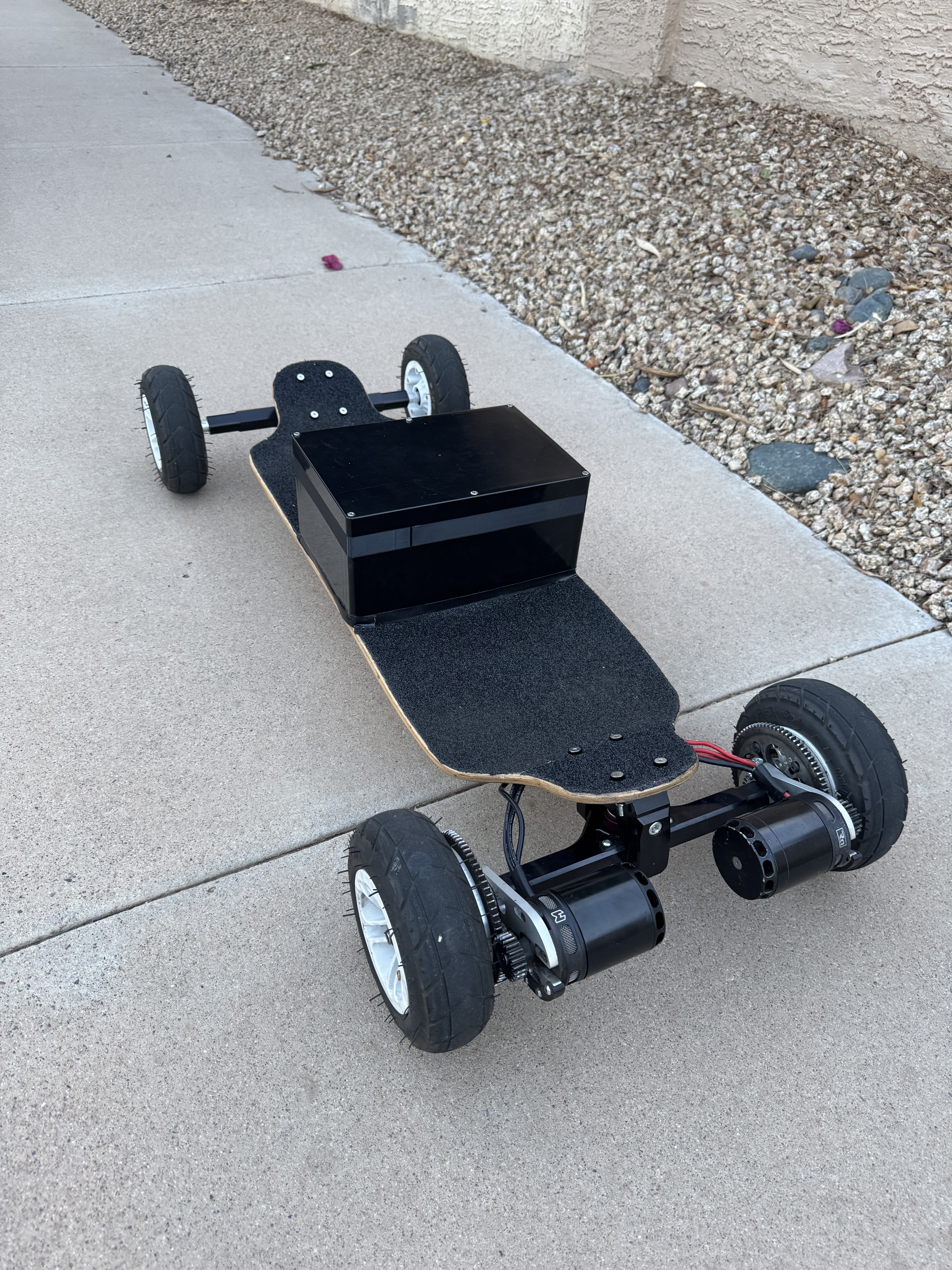

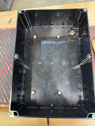

I decided to go with a top mount box on this build, something I havent done before. First reason was to make sure there wouldn’t be any clearance issues when leaning as the dualitys seems to lean a lot. Secondly in all honesty I was concerned with the shortness of the barrel deck so this way in the future if it’s just too short a deck transfer isn’t an impossibly difficult task.
I wanted as small of an enclosure as I could use, dont we all, and had seen @rafaelinmissouri ’s builds using these junction boxes. I figured this would fit the bill and snagged the 10.4” x 7.2” box off amazon
Here are some photos of testing the size of the enclosure on top of the deck. It just barely fits width wise but it doesn’t hang over!

I built up adhesive backed foam on the deck where the enclosure would go. This helped fill the void in the middle of the deck created by the concave when laying a flat box across it. If It could do it again (maybe I will) I would print a TPU cushion for this instead of foam for a cleaner look.
Once that was done I decided on where my pass through hole was going to be in the enclosure. With the VESC in place I marked the location and drilled through the enclosure first.
Placed the enclosure on top of the foam and marked the center point of the hole. Removed the enclosure and drilled first with a pilot bit and then all the way to size with a stepped bit.
Top and bottom
I then drilled through four holes for the bolts that will hold the enclosure onto the deck. I used flush mount washers on the bolts.
I taped the hole to create a bit of a gasket on the sharp edge of the plastic.

The loctite still need to set so this first ride was a simple around the block. All I can say at this point was it felt loose, stable and short. With more time on the board I’ll report back but Im thinking she’s a winner.
Im super happy with how it all came together and am looking forward to having a compact carver in the stable.

Long story short it’s super fun and a unique feeling being on this length of a deck with angled tips.
