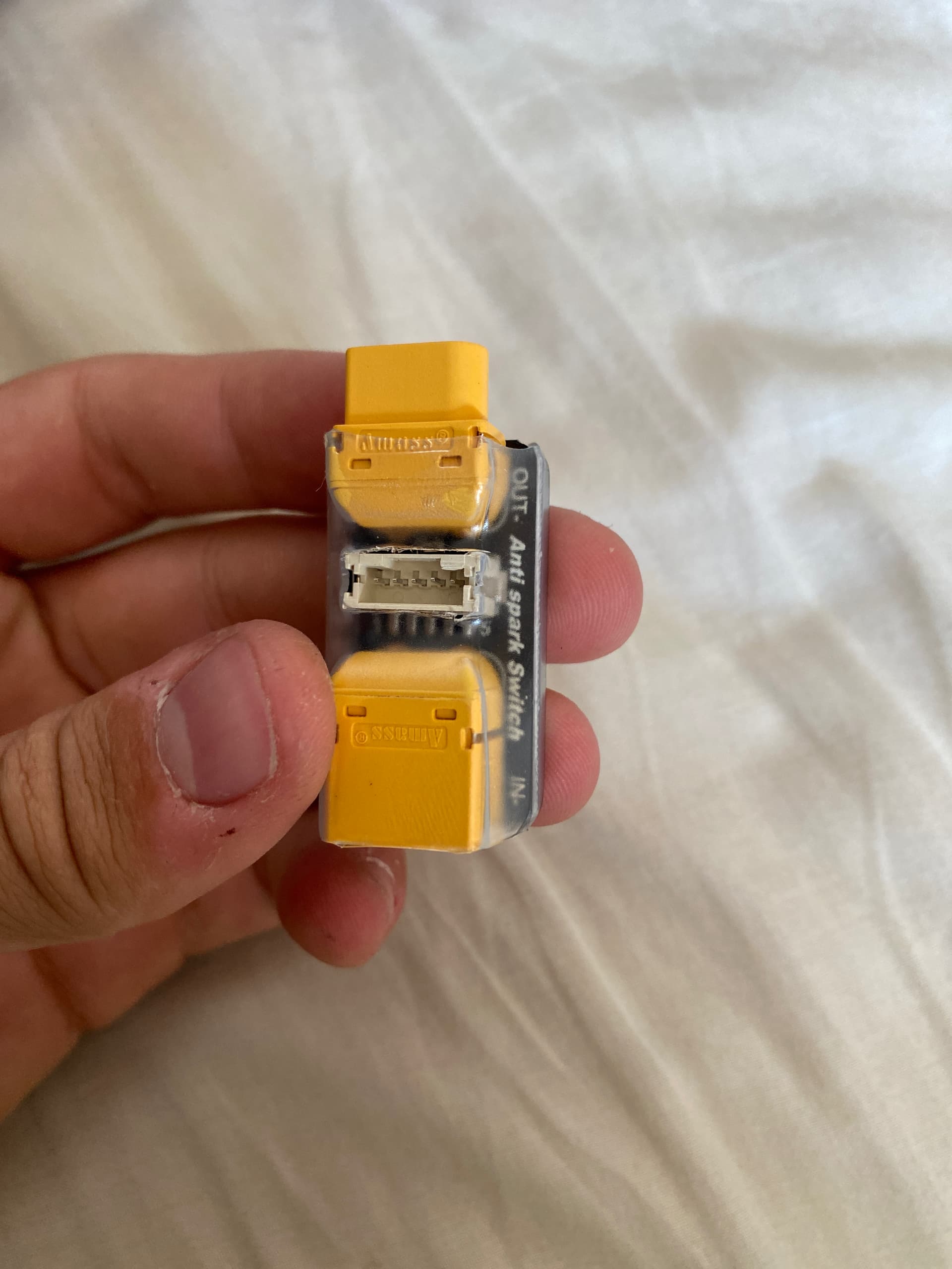

Anyone know this anti spark
makerx
You know if it’s any good
personally have not use that one before, but u need a latching switch for that
“official” claim: 12s 100a
but u know how the math work
Thanks
Anyone know what is considered a reliable anti spark these days
Maybe 100 real amps
Whenever I ask this the main answer I get is “Amass XT90s”
And if it’s well over 100A then I guess Amass AS150
Reliable?
How about a loopkey for $10?
Fancy?
Now you’re talking about active electronics and added cost and maybe increased failure rates

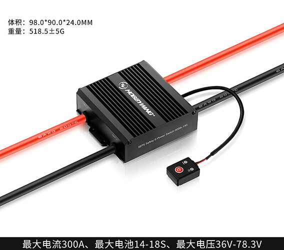

I have a solution if u stay less than 18s, but it’s fucking massive
Let’s hear
biggest mofo
300a tho dang lol
Never fully trust numbers coming from folks who profit from sales
Unless it’s a “number of motors” specification :rofl:
True dat.
