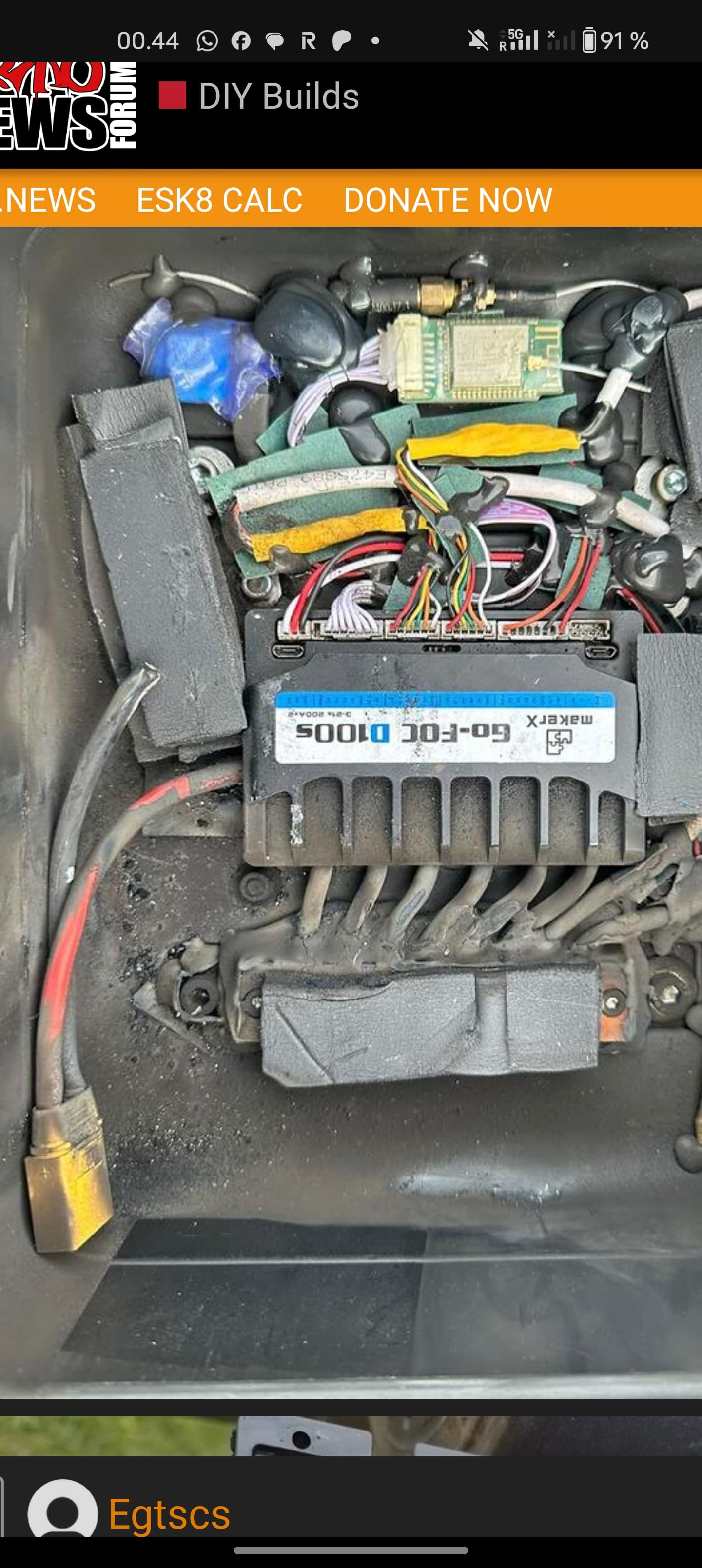

18s 190kv on a d100? I was told that was a good way to shitout your stormcore
I believe that would be your problem there.
That would definitely be the first thing I checked. I like to splooge hotglue over any/all connections to reduce the chances of such disconnects

Unless there’s a version of the stormcore 100D that I’m unaware of none of them are categorized with an S.
I’m pretty sure he’s referring to the D100S from makerX which does recommend <130kv and <20s as operating limits but I have some doubt motor kv is the problem here.
This is also the first thing I’d check.
Yes makerx is what I was referring to. And I’ll give that a shot, how do you remove the hot glue if you need to service something? Does it peel away pretty easily?
I use neutral cure silicone for the same purpose, it’s inconvenient but not unserviceable. I suspect hot glue is pretty similar but can’t confirm myself.

Not really, it doesn’t conform to anything. You want to bond the wires and add some strain relief
Both work well, hot glue is easier to remove and doesn’t last as long imho but that is preferable in some places. My power button - silicone. My buck converter xt30 - hot glue. My phase connection or receiver - silicone. My bms balance wire - hot glue. The bms header connector - silicone. I use both so often switching between the two isn’t an issue for me and i usually have something handy.
I glue all the things down, i have no patience for having to pull things apart because the vibration messed something up :grin:

Just hot glued the electronics down as well as the connections, I’ll let you know if it improves!
That fixed it! Hot glue securing the major connections in place and electrical tape around the xt connectors

Any idea what happens if I keep it on 190kv? I don’t have any other KV motors and budget is kinda spent on the rest of the board, I don’t plan on going above like 30mph, and I can’t go anywhere near the max setting on this board, it’s terrifying.
(Obligatory not an expert)
I believe the primary risk is based on excessive Erpm
(Which is different from RPM)
I believe @Dinnye has ran (and blown up) several D100s’s in his Raceboi build.
Do keep in mind that this board is also constantly pushed to all of it’s limits. The majority of riders (me included) don’t push their controllers as hard as @Dinnye does.
His build is insane, ya I think I’ll be fine with the 190kv then. Appreciate you explaining all that, I may need to switch to a lower kv eventuall though.

I only blew up one personally. It’s not just ERPM they don’t like, it’s also spinning unloaded. If you spin them up unloaded, do burnouts, or go over a large crack with throttle, they sometimes just blow up. This is because ERPM changes too quickly and the ESC can’t keep up.
@Perrystevens Going lower KV is a good way to minimize the chances of it blowing up. It wasn’t fun cleaning up all that mess :smile:
If I open the box it still smells awful half an year later.
