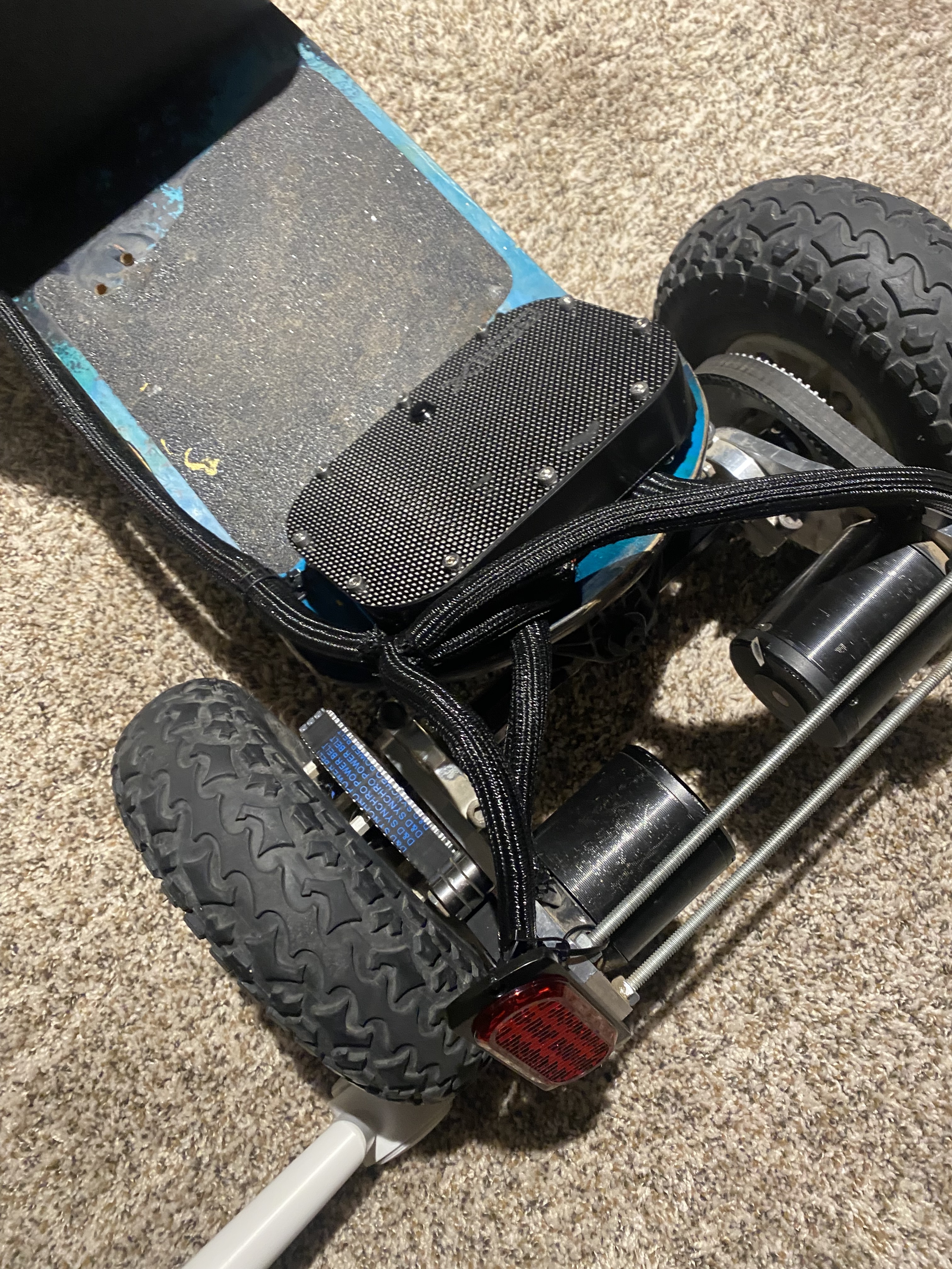

Ya I think a good power train may be the next step, luckily I don’t go with too much power while I’m ridin. I don’t full throttle and I don’t usually go past 20 mph so a couple idlers with my current setup might keep me ok for a while. I only have 40 amps per motor, it only really slips of I brake hard.
I am using matrix 2 trucks, 9” MBs tires, 190kv 6374, 15 tooth motor pulley, and 72 tooth wheel pulley. Any recommendations? I could get away with spending a few hundred.

Woof, ya I don’t want that to happen, any way to place some setting limits to prevent it while I use my 190kv? Can’t afford to put 2 brand new motors just yet after buying the new battery and new esc
If this were my board I’d be considering 2 options
1: wait it out, a bit of belt slippage on hard braking is generally to be expected, plus a lot of people are currently swapping over to @Titoxd1000 duality trucks which means you may be able to find a good deal on a used truck+drivetrain bundle if you just wait around a bit.
2: if you’d like to limit the amount of money you spend while still improving your board.
@Facko makes an excellent M2 chain drive setup that I believe you could reuse your motor mounts for.

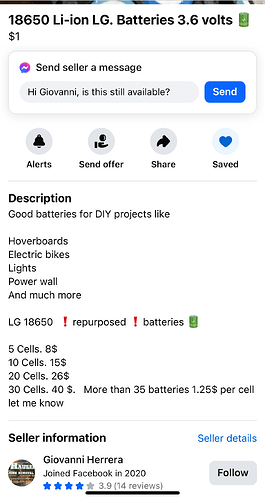

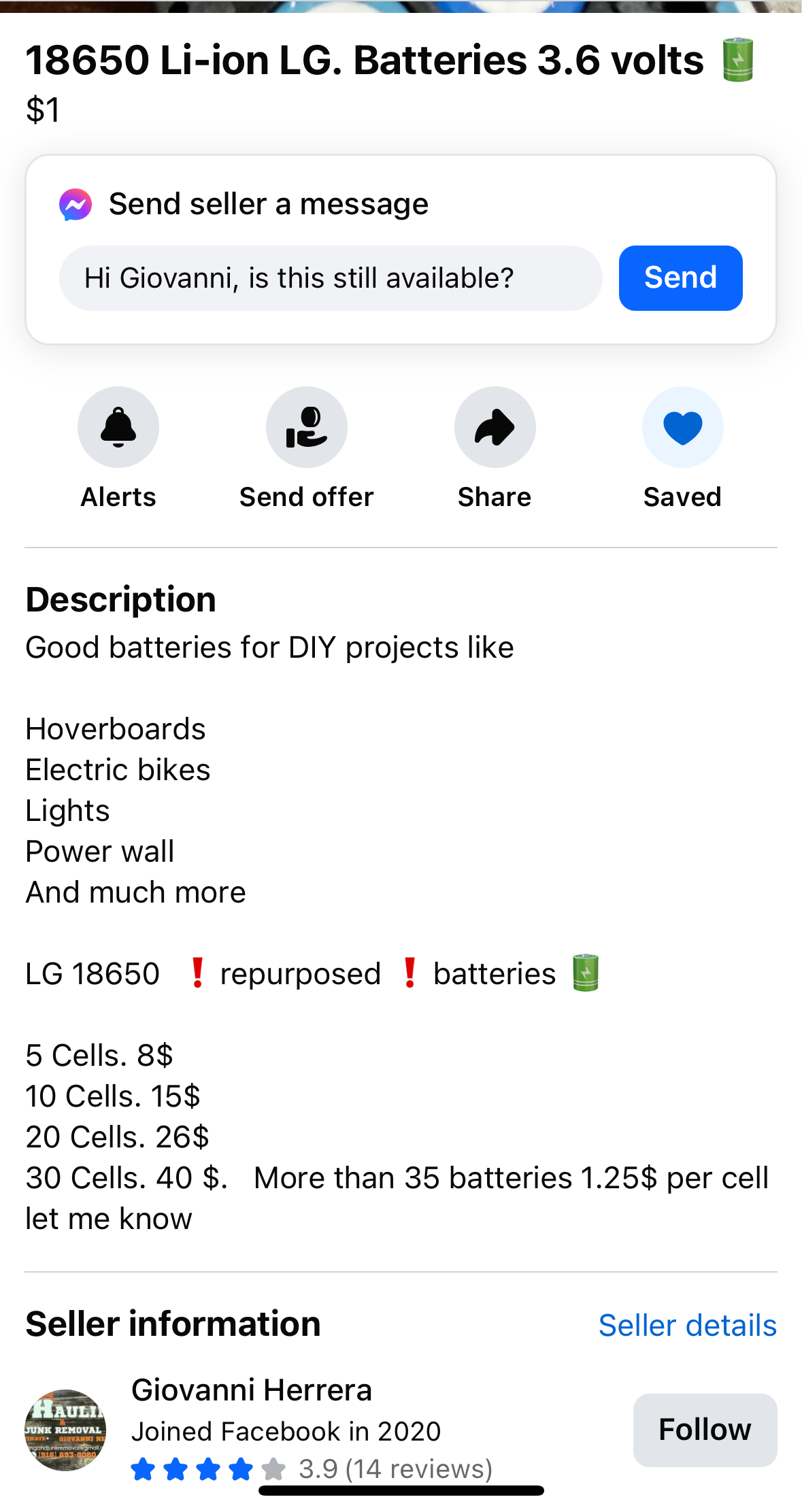

What do you guys think? I really have no idea how to judge cells, if you guys could give some input that would be great, I’m looking to build a Bigger battery.
Buy them new, from a trusted supplier.
18650 battery store
Nkon
Liion wholesale
(I’m pretty sure)
All of those are trusted sources for batteries.

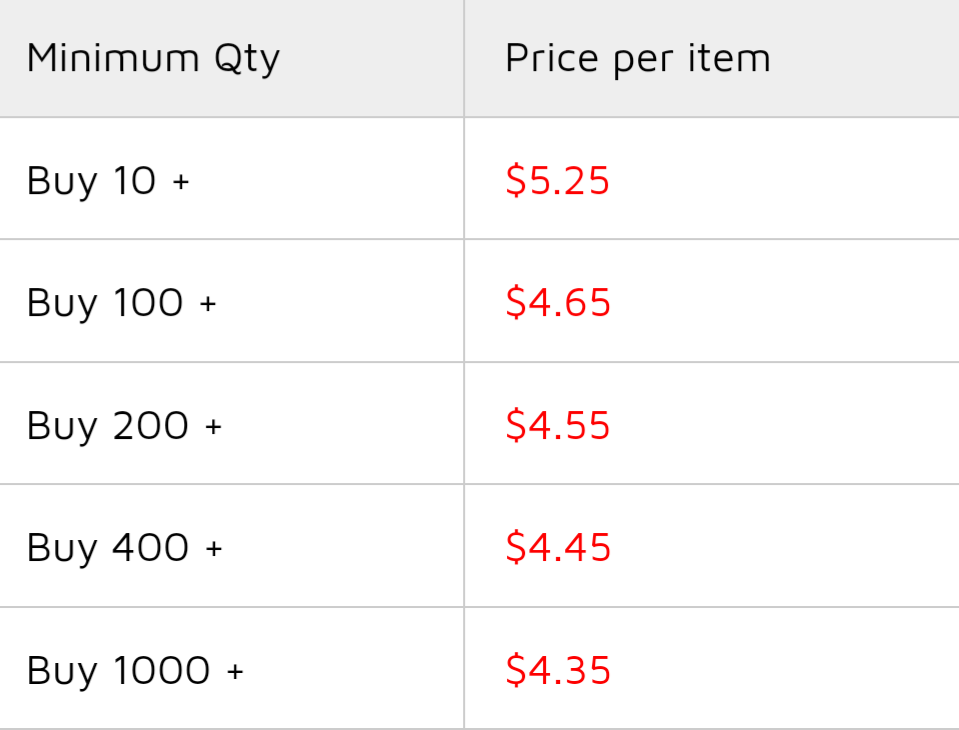

If you’re buying a battery from a builder, they will often be able to provide better pricing per cell than you will receive from a supplier
Partially because of discounts like this, if you can afford to buy a bunch of cells at once you can often get a better deal, also these prices fluctuate and lots of battery builders will keep an eye on prices and grab a bunch when they’re on sale

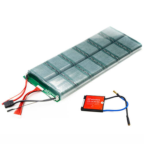

I would either be looking at lipos like these
And just paying somebody local to wire them up to a BMS (that way you can charge with a regular esk8 charger)
Or saving up closer to $800 for a well built P42A/p45b pack from a reputable builder.
