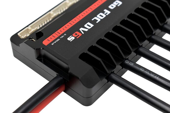

Introducing the all-new Go-FOC D100s, Go-FOC DV6s and Go-FOC DV4s . Enter a new era of high-density, high-power, and high-stability!
In order to provide ESK8ers with an even better DIY experience, we have once again reduced the size of our ESCs. This allows for more space within limited enclosures. Despite their compact size, we have managed to pack unprecedented power into these ESCs.
Go-FOC D100s:
Boasting a peak output capability of up to 15KW, supporting a maximum voltage of 21s, and a peak phase current of 200A. With dimensions of only 101x65x20mm.
Go-FOC DV6s:
Same compact size as DV4s but with even more powerful performance than the DV6pro. Improved heat dissipation and a more mature circuit design, resulting in an almost 0% chance of ABS current faults.
Go-FOC DV4s:
Considered the most cost-effective dual ESC for electric skateboards. If you don’t require extreme power, this is the top choice. previous thread:
