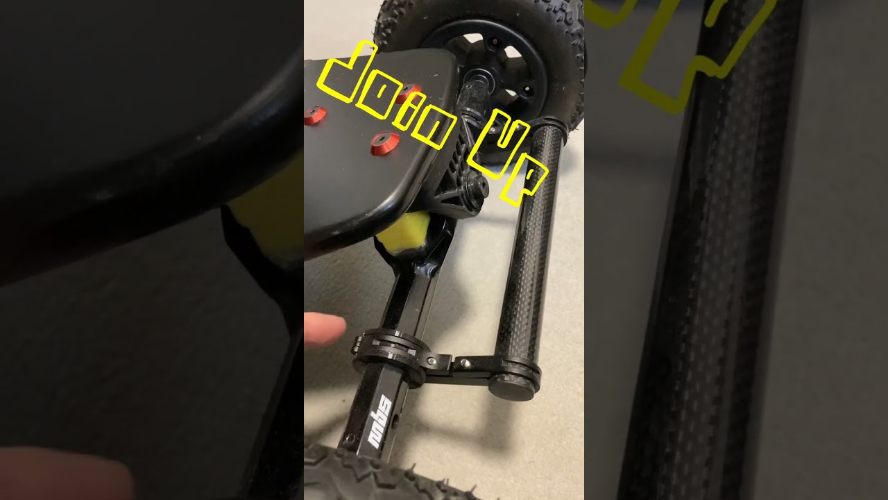

Just tested the board I built for the first time, absolutely insane.18s6p molicel, d100s, 6375 190kv, Hoyt puck, and flipsky BT module.
I tried it at a park on grass in case I fell and it did this weird thing. When I road over bumpier areas the Hoyt puck would disconnect but my BT would stay connected, so my vesc didn’t lose power but something about the ride/bumps influenced my recover.
I’m guessing all the jostling around maybe disconnected the receiver or something? But it would reconnect if I turned the board on and off,
Anyone have any ideas?
