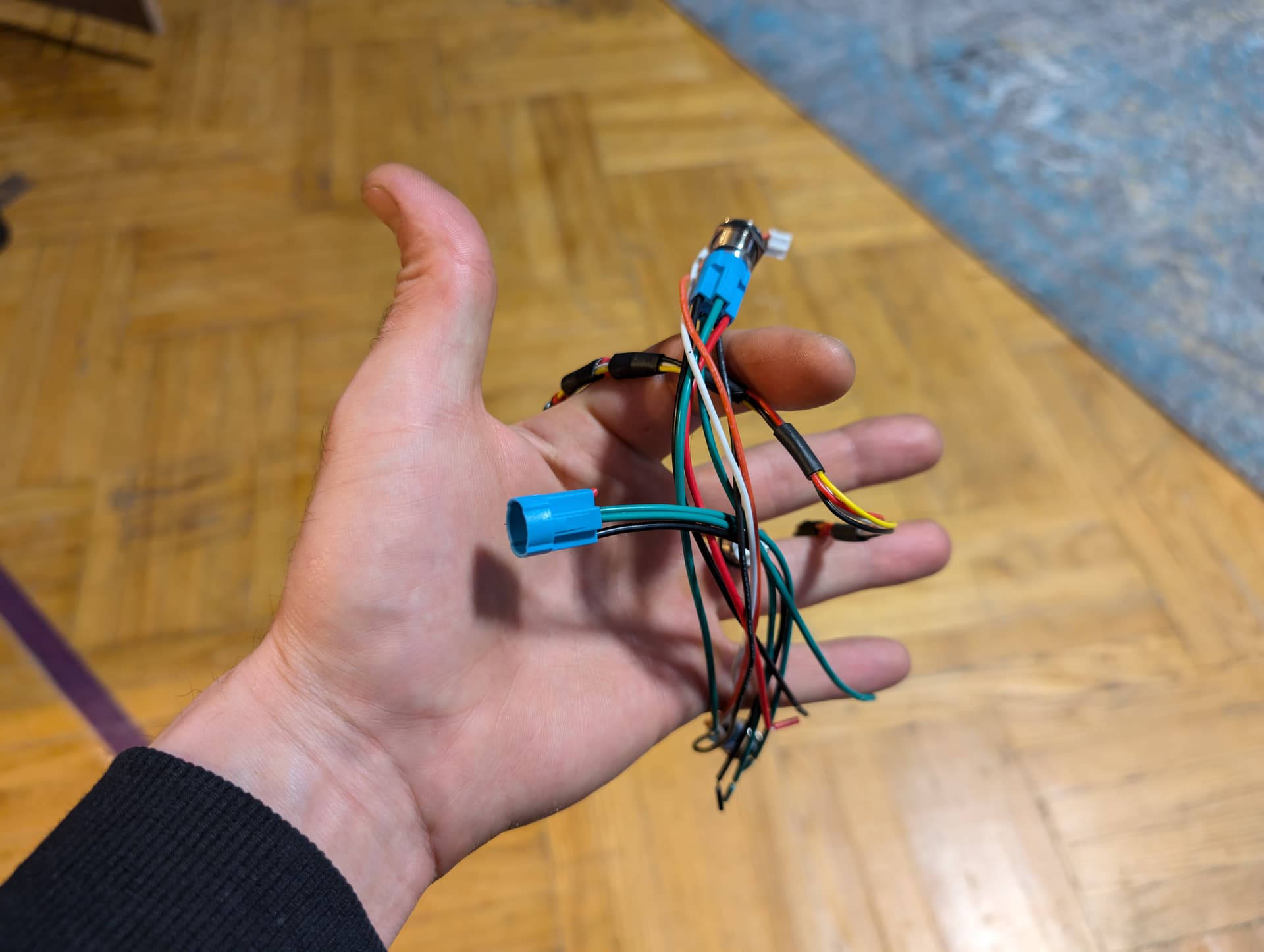

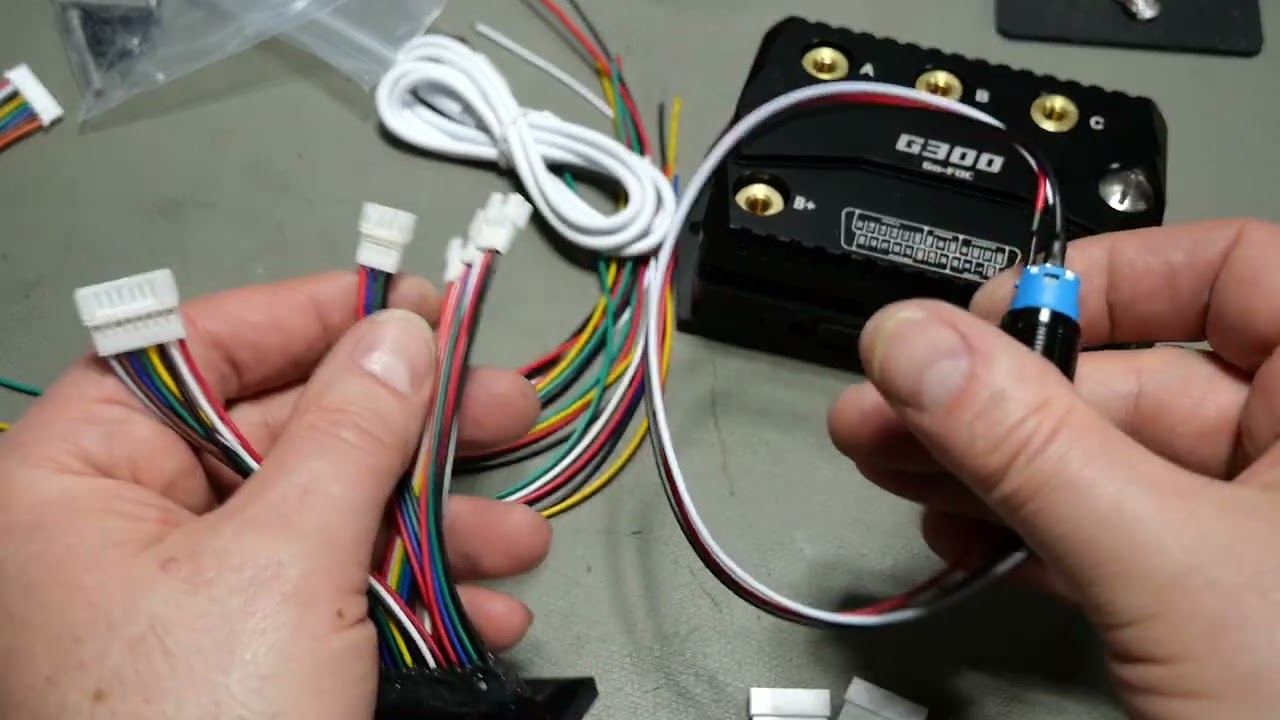

Could anyone explain a buttons wiring diagram for a g300 Vesc?
Like what does the button actually connect?
I lost the original one, bought a bunch of 4 pin ones, and can’t make them work, they are instantly “on” if I plug them and don’t shut the Vesc once pushed.

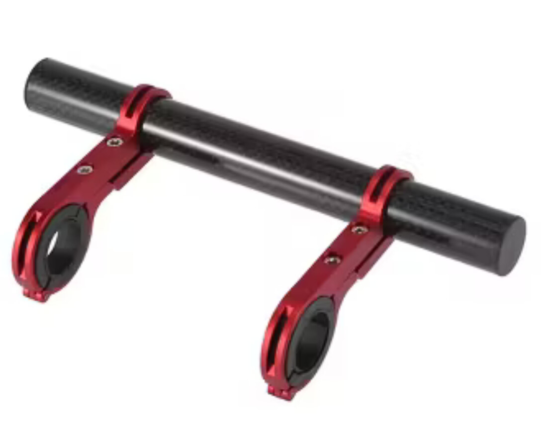

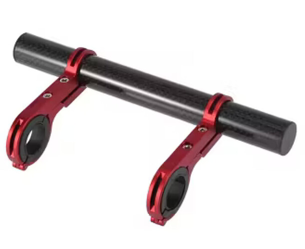

Would any random “bike extension bar” like this one work for matrix 2s, or do I need to print a custom adapter?
I used that exact style with no issue. May need to add some extra wrap to make it tight tight
That’s exactly what I was looking to hear, thanks bro

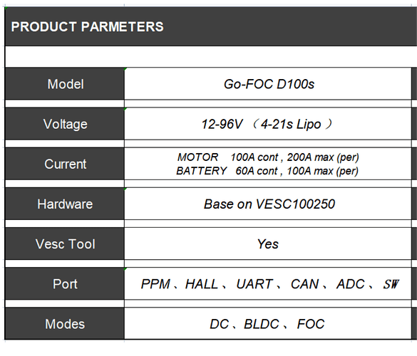

Would a d100 and trampa 6376s work with a 20s6p brick pack?
D100 battery limit is 96V
20s * 4.2v = 84V
96V > 84V
Yes.
Thanks. Could the motors handle it?
Most likely, depends on the amps, and therefore motor watts you allow the motors to have.
Also depends on your ambient riding conditions, board+rider weight, motor Kv, gear ratio, drivetrain resistance, terrain, number of motors, weather, motor placement and a few other factors.
But at 20s you won’t need many amps at all, and assuming an appropriate gear ratio and Kv are selected you should be okay with only a handful of amps per motor.

There is a file on Thingiverse from @Facko for an insert for the matrix 2’s that works well. I ran them on mine when I had them.
You think the adapter would be compatible with any?
maybe helps?
