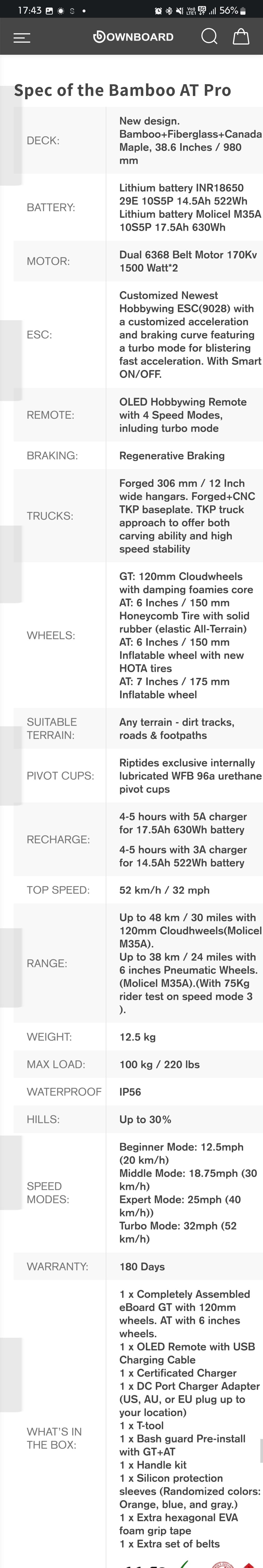

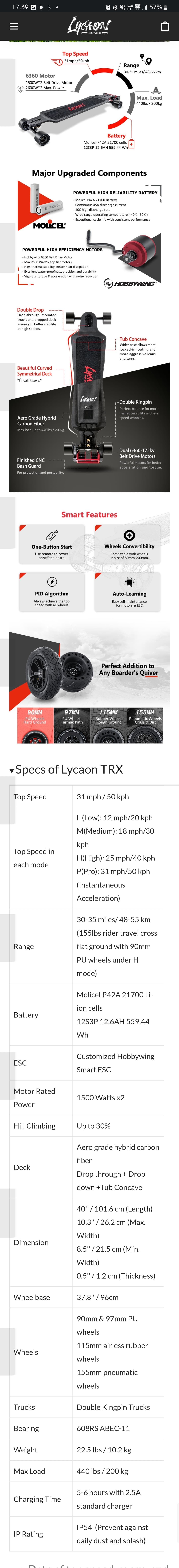

JUST ON SPECS and not personal bias as I have my own, which one which is the better option. The 12s3p p42a Molicels and carbon deck is appealing. While the newer flexy bamboo with bigger motors and latest hobbywing esc gets my attention. I’m about 216lbs need a commuter street board running 6 inch pneumatics that can do a 15 mile round trip. Options to tweak maybe motors or esc later. Thanks in advance.
Trusting the specs given by someone profiting financially from sales is often a mistake.
From experience I’d bet the ownboard will be 10x easier to repair

That’s what I’d expect from Lycaon too.
I’ve heard both companies CS is shit so neither one shines out to me on that front.

A 12s3p at 12wh per cell (per Mooch @ 10A) is 432 wh / 30-35 wh/mi = 12-14 miles. A 12s4p P42A pack would be a better option.
This is $950 and I would take it over either of those boards in a heartbeat.

Ownboard customer service has been fine for me, and I’ve heard quite the opposite for Lycaon. A friend of mine has a Bamboo AT Pro and the deck has a nice flex to it - I like it.

I can confirm that their CS is kind of shit. You’ll eventually get what you’re supposed to but not without delay first. Had to wait over 3 months for a replacement battery since mine died before warranty was up. They claimed they had none in stock yet you could still order a new one from the site the entire time I was waiting.
Said replacement battery died in like 3 months and was very poorly made. The OG battery was well made but just with lower quality cells that didn’t last long.
Some information on the specs that they can’t really list out:
CS issues aside, My board did hold up VERY well to cold and wet weather while in stock configuration. That was why I went with the GR originally since they were the only one with good water proof-ness at the time. They didn’t just pot everything with silicone to make it water tight which is a plus. No idea if that has changed though.
The version you are looking at does have a different enclosure style, but I don’t see why they wouldn’t keep the same build quality at the bare minimum for that version too. Just expect to need a replacement battery in anywhere from 3-9 months if you use it daily. (a spec they would never list on their site)
Repairs are stupid easy with their GR model which is what my board started as. :person_shrugging:(only thing OG left is motors which I am replacing atm oh and the trucks but I like the front truck and I’m only replacing it due to it being shorter than hanger I need for a pulley set up)
