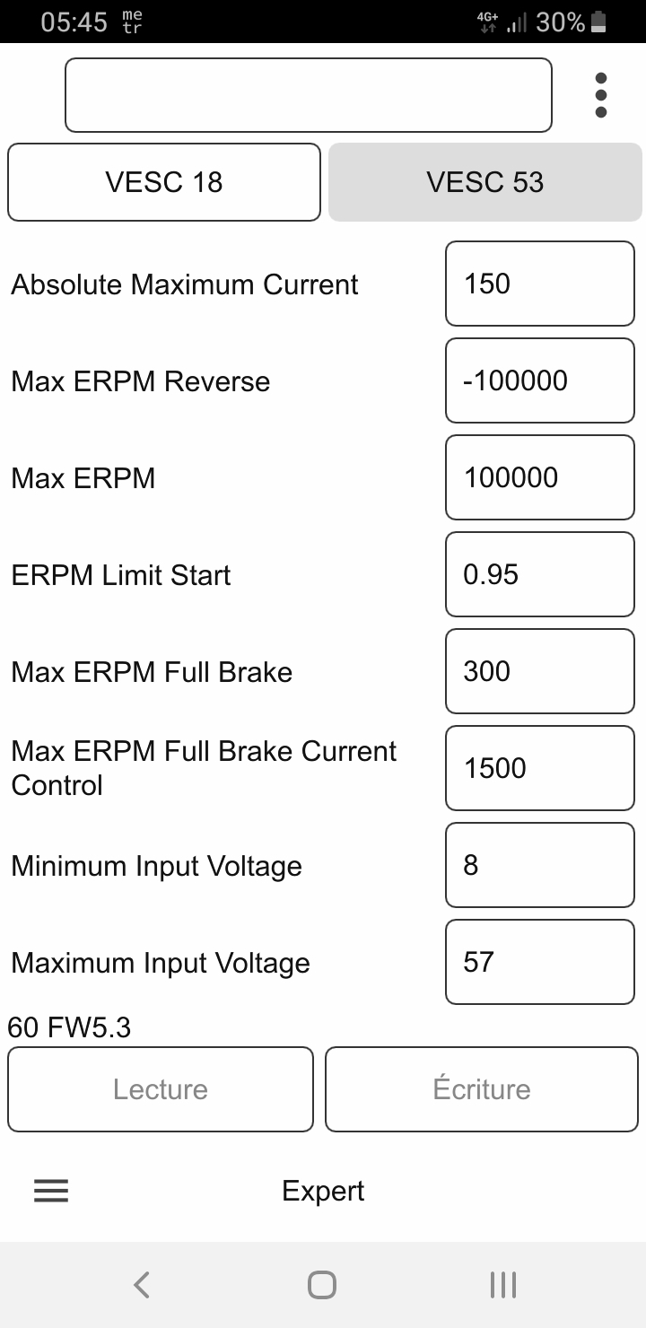

Hey guys,
I have a fsesc dual 6.6 doing weird stuff after like 10 minutes of testing… not sure if I configured something that broke it or not…
It seems to loose CAN connection between the 2 sides (it refreshes the can devices then only the local device is detected) and gives me errors when trying to run the wizzards as a result… (either it only runs the wizzard on one of both, sometimes it runs but only one motor is spinning but still have a result for the other side, sometimes I get motor read config error and/or firmware is different on both sides)
I also do the FOC wizzard, motors run fine during the wizzard but afterwards one of the sides is like cogging, no matter which motor I plug in and it seems to not always be on the same side… Tried sensored and sensorless with the same results.
logs don’t seem to indicate any errors…
This is a common problem with FSESC6.6 in my experience, including the plus and mini variants.
Your ESC is a critical part of your hardware. Don’t skimp on it if you can afford it and get something known to be more reliable.
Try programming each side separately, run a different version i think 2.05 of vesc tool works for the flipsky in my experience, flash the software again, make sure connections are solid… ive had a few flipskys 6.6 dual and once its working ive had no problems.
Yeah I regretted buying it afterwards… Should have went with another vesc… Lessons learned, they aren’t even that much cheaper than other solutions

Thanks a lot I’ll try that, I also didn’t have any problems during testing everything was smooth until I reconfigured it a few times
Also do you know were I can get this older version of vesc-tool? since Vedder doesn’t let you download older versions
