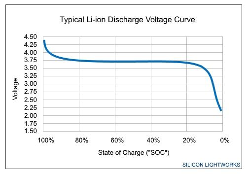

Representative chart I found, oversimplified and not super accurate but gets the point across.
The point being gotten is accurate, but that chart seems dangerous, implying capacity above 4.2V and below 2.5V.

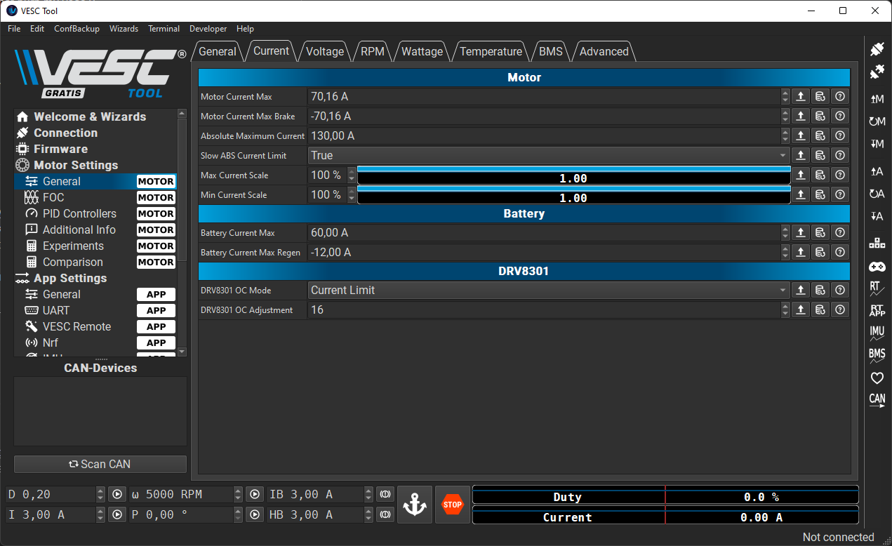

I have been looking throughout the forum for some information about what to set the battery current max too (and regen) and have found different information. Some say that I should take whatever amperage a cell is rated for x packs in parallel. Some other say to cut the C rating in half x battery capacity.
(my battery has a continous discharge of 20)
The first one would yield 120A, the other one 60A. But then I compare my number to other people’s and they usually set theirs to around 45A. Which makes me wonder if I have calculated this wrong.
Also a link to my battery
Do these values look fine? I went conservative with the numbers.
This is a for 10S2P setup Lipo battery at 20C continuous discharge LINK i.e. 4 packs, two in series, two in parallel
And this motor
Is this a dual motor or single motor setup?
I’d bump the motor currents up to 80/-80, but leave the battery at 60A if you have 4 of those lipos. If it’s a two motor then halve the battery max and battery regen max.
Low speed braking will be good with those settings, but if you find high speed braking really weak, you could double the battery regen amount to -24. It’s over the battery specs, but it’s better to shorten the life of a battery than not be able to brake fast enough. If you have a BMS with a battery temp monitor that would be ideal as well.
