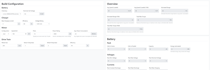

After I input everything it just stays greyed out on the right side. Set chemistry to liion as well.
Edit: It was my ad blocker, turned it off and values are showing up now.
I had the same problem. I think i might’ve had to switch browsers too
i hate when website does that, that’s why i don’t use it
What is a good starting point for efficiency? im using SRB rubber slicks and helical geardrives. 80%?
what what is the max value it could realistically be? 90%?

I would say 75- 80% is probably pretty realistic

I think i figured out what is wrong RE:this.
When the ek8news calc says loaded max speed what it really means is the average of loaded max and loaded min speeds… IMO thats very misleading. 3ds calc is definitely superior.
