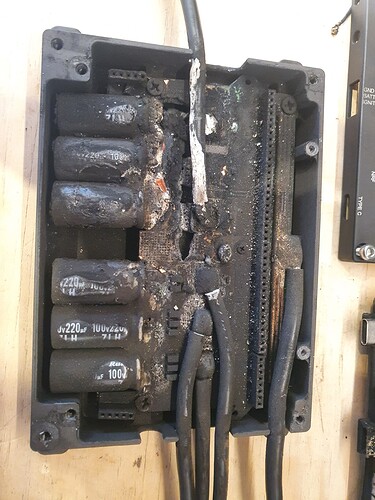

Ah ok, do you know roughly when that was? There are posts reporting fire at least as recently as November of this year, could be outdated VESC tool but it’s still causing issues, and if a device needs custom firmware to the extent it’ll catch fire it’s still a problem
I had 2 UBOX fires in March/April, running 18s. One fire during the first 5km of riding, the second fire in motor detection after they sent a replacement . For me it was a case of being a guinea pig stuck in the firmware mess in the early stages, but I haven’t heard of many issues recently since they have sorted the firmware out and have released specific instructions for setting up.

HAHAHA last night i updated back to 6.0 firmware the ubox no longer connects to vesc tool by any method and the red leds are now having a disco rave anytime you turn the thing on.
has Spintend released their 6.0 firmware?
it’s officially part of vesc tool. please do not down load it, for me atleast it was very buggy and bricked my ubox
Spintend controllers have to use their custom firmware or you risk popping on detection. I don’t think they’ve released their custom 6.0 version yet, I haven’t heard anything about it.
I would switch back to 5.2/5.3, you can find the firmware files on Spintend’s website
i was the one who told them to put a warning on there website about that.
they literally did a pull request. i even emailed them and they confirmed it
and when i say it bricked it, i mean it has royally fucked it as it can’t even be detected by an st-link and it constantly flashes red
Did you manage to unfuck it with a bootloader reflash or is it still borked?

Links to spintend ubox fires:
Spintend 75V/200A Ubox (Based on 75V/300A VESC)and Uni1 Introduction ! - #709 by Skyart - 26Nov20100v dual ubox fire - #26 by BigBen 11Dec2021
MoonRover | 16s9p | 4WD Moon GD | Moon hubs | Lunas | - #20 by whaddys 23Jan22
Spintend 75V/200A Ubox (Based on 75V/300A VESC)and Uni1 Introduction ! - #1760 by Halbj613 26Jan22
100v dual ubox fire - #31 by Pickled_Monkey early 2022
double kill combo bonus: 100v dual ubox fire - #43 by Tasventouras both in March/April2022
Evo Falcon BioX 22May22
https://www.reddit.com/r/ElectricSkateboarding/comments/vop41k/dont_be_a_dumbass_like_me_and_use_the_wrong/ - 1July22 - added by shiteside
Spintend ubox single on fire 16July22
100v dual ubox fire 5Nov22
100v dual ubox fire - #39 by JesseM unknown date
The thread name being “100v dual ubox fire” gives the incorrect impression that most of the issues are the 100v version.
It looks like it’s really the 75/300 version that is fire prone. I’m not sure the 100/250 100v ubox deserves a firey reputation, or if it’s just an unfortunate association with the 75v version. Maker x seemed to see more exploding escs on the D series when they were on 75/300, before they switched to 100/250.

any thoughts on explodyness of 75/300 vs 100/250 designs?
The difference between the two designs is mainly phase shunts (75/300) vs low side shunts (100/250)… and in a perfect world where all other problems are either solved or the same, the phase shunt versions should be better. It’s also worth mentioning that those are reference designs. Companies like Spintend, Flipsky and MakerX all put their own spin on it… with different components and layouts… and that can make or break a controller.
Turns out reliable VESC hardware design is pretty complex. A motor controller is a simple concept, but there is a crazy amount of small details needed to make these things work, especially when running that much current through a relatively small device. Lots of seemingly innocuous choices that the designers make can have huge unintended consequences down the road. Then you have to factor in all the things the controller will experience in it’s life. Frayed and shorted phase wires? Sensor wires shorting against the motor windings? High voltage traveling across the canbus? Power wire touching a heatsink?
It’s really interesting watching the hardware builders on the VESC discord. They blow up a lot of controllers, but learn a ton in the process and come up with some really cool solutions. There are also a lot of really talented designers throwing out ideas along the way. Unfortunately the normal big name makers don’t share their VESC build logs with it’s successes and failures, so it’s hard to know what is going to work well, and what isn’t. Usually all we get is a few pictures and a promise.
I think this question ultimately leads to the real question - which VESC is not going to blow up on me? Truth is I don’t know. The DRV wizard said it best. “From Experience I can positively affirm to all of you that I’ve seen on my bench for repair 99% of all type of Vesc base controller!”. That has been my experience too. They all blow up in different ways. Some of it is firmware related, but most of it is small flaws in the hardware design.
I think each controller should be evaluated on it’s own in terms of reliability and cooling… two very important things that we have little data on. From the evidence, it certainly seems like the Uboxs have some unique issues as they all seem to fail in the same way… a fiery death. It could be something as dumb as the positive wire shorting against a heatsink… or the high current pos/neg traces having too tight of a tolerance for reliable PCB manufacturing.
