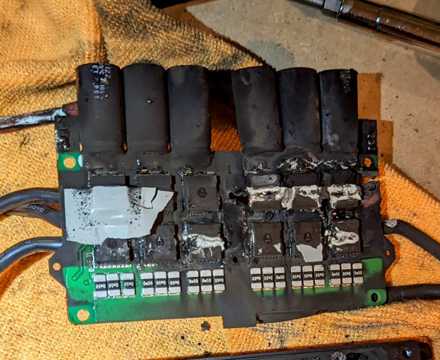

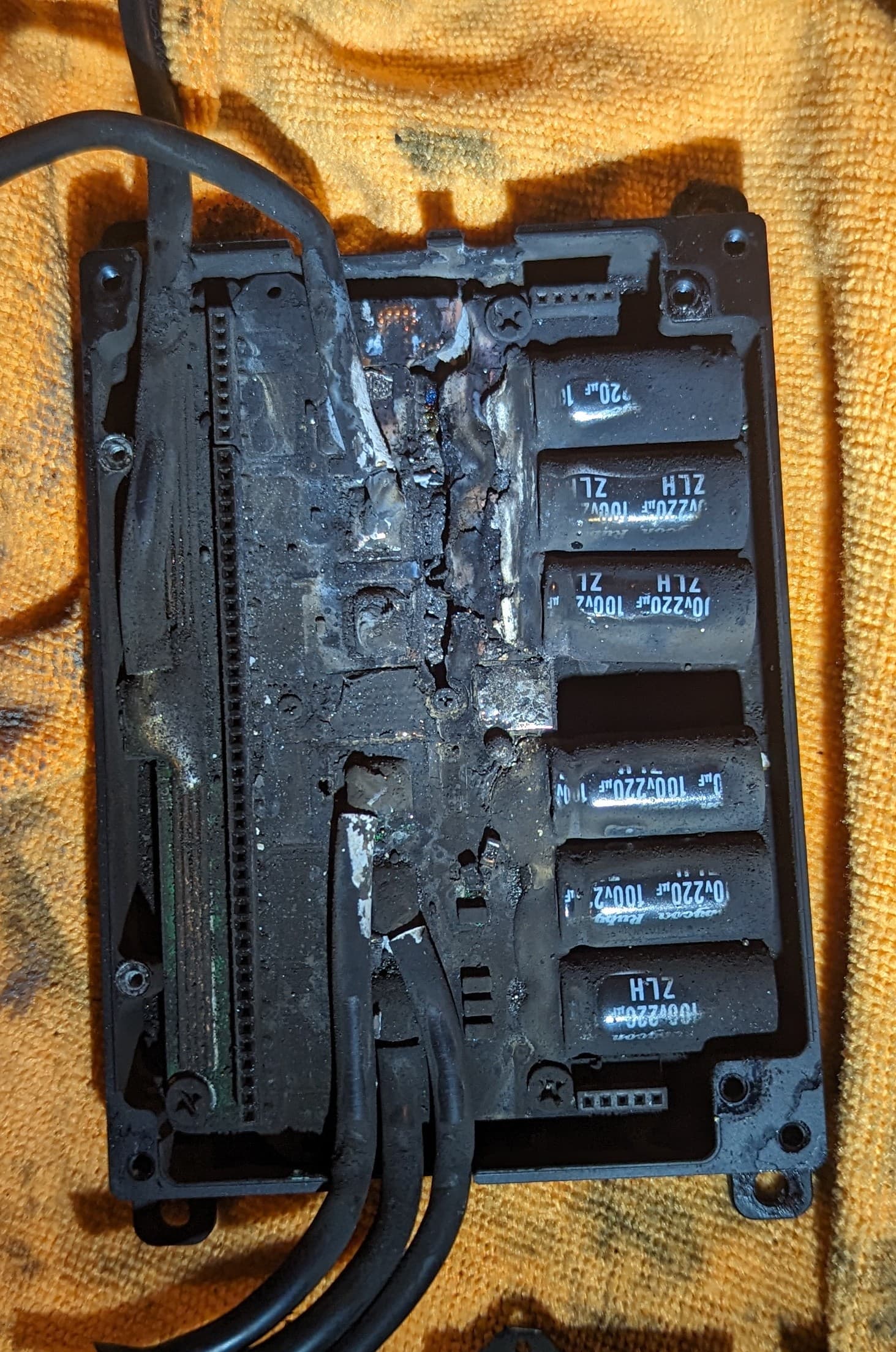

Ok, so it was probably running something around 70-75 bat and 90A motor per side… But it was like that for about 3 months with no issues and some really hard riding… This time I started ripping up a hill and about 50 feet in the board cut out and then the wheels turned like they were stuck in mud… It wasn’t a normal fault… What should I look for in this autopsy?
A new vesc lol
how did your enclosure fare with the fire? salvageable?

There’s not much to look for, the fets are probably incinerated.

It’s the Flux AT2 kit and it held up really well I think… I’ll take a closer look at it tonight, but yeah I’m pretty sure it’s fine other than the all the nasty soot…

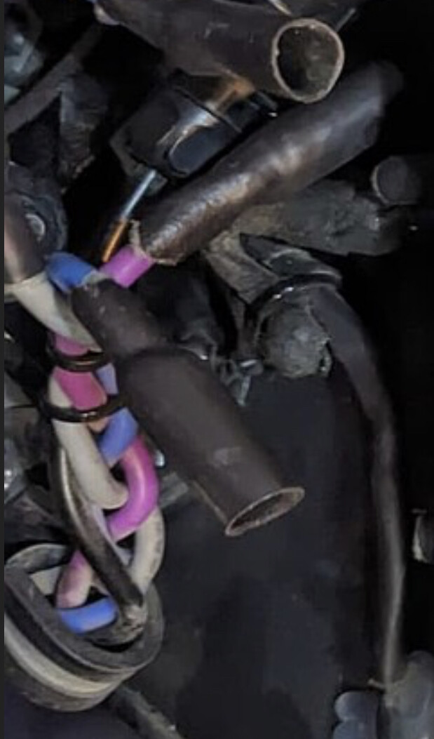

Didn’t know phase braiding was a thing, could that or the zip ties have caused a short. Sorry for your troubles

Really I was just too lazy to cut them down to size and eager to get out and ride… And when you’re Dad to three girls braiding comes easy. I’ve asked about it being good or bad and most have said it might be better and at least wasn’t bad for some reason the engineers understand better than I do… As far the zip ties, I’m pretty obsessive about covering all the thin wires in loom or shrink so I doubt it.
