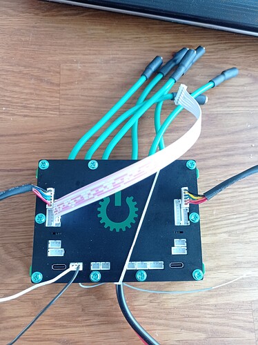

I was riding slowly, minding my own business when all of a sudden my precious board started to give off thick black smoke. After walking home cursing I opened it up and saw that I was the victim of another burned up ubox V1.
Luckily Markus at Bioboards hooked me up with his brand new BioX ESC.
Be aware that the biox is just a rebranded ubox and may have all the same problems.

Quite a few V2’s burning up in recent months… Had one explode spectacularly during the first motor detection a few weeks ago, it was replaced but still…

I dont know what bio is doing, but I also havent seen a single nuked biox.
I checked; no custom firmware. The only relevant thing I saw that the biox mentions on it’s product page and ubox does not is that it has a thicker than normal pcb with hella copper to support it’s higher max current ratings.
I’m no electrician, but that sounds like it’d be the difference between a functioning esc and a fire all.

Yes I though there was a bit more copper in the bioX

I think there is also less chance for user error, not saying anyone in this thread screwed anything up, I had a V1 that went up in flames just like this, but I think this is always a bit of a factor. Also most BioX are CHIIIIIILLLLIIIIN…in 4wd those things don’t ever like heat up at all. And bioboards mostly makes 4wd, very few 2wd
