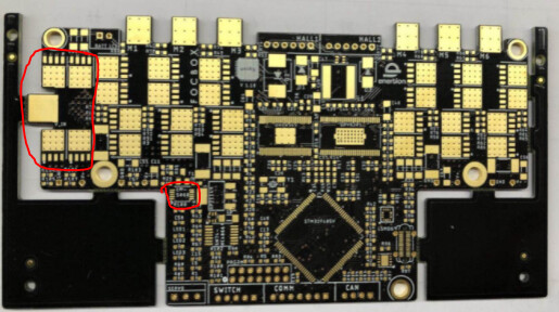

Xenith won't turn on!
I take it the switch would have a constant reading when held down? Like I said I get a reading for a split second on a quick press but on a long press then down to 0
Its not the mechanical switch itself, its a Chip on the PCB. It break quite easly, known issue. Some seem to hold up forever, some break after a short while.
Yeah I heard about this on the unity and previous xenith,I thought I would be able to just use the battery switch to power both on but realised you need to use the xenith switch also…
Big red area is the FETs that is toggled, small circle is the antispark IC if I recall correctly, was a few months since i repaired one.

yeah that was the circuit for the switch, same fets used for the H-bridge :slight_smile:
@WARMAN when checking the switch in continuity mode press the blue button on your multimeter. if you touch the probed together you should hear a beep. This tells you your in the right mode.
Then put them on the button wires, when the button is pressed you should also hear that beep.
If this is the case the mechanical button is fine. If you can’t make this work there’s a chance that it’s just the button that is faulty.

Ok so in the setting @Lee_Wright circled and pushing the blue button I get the beep when touching the probes together,I put the jst connections pointing up to get the probes in there and I get a constant reading and the beep!
Sounds like it’s what @linsus suggested!

If you want you can have a look at this thread and read until the bottom. This subject has been up before about blown antisparks on the unities. Im sure your case is no different.
