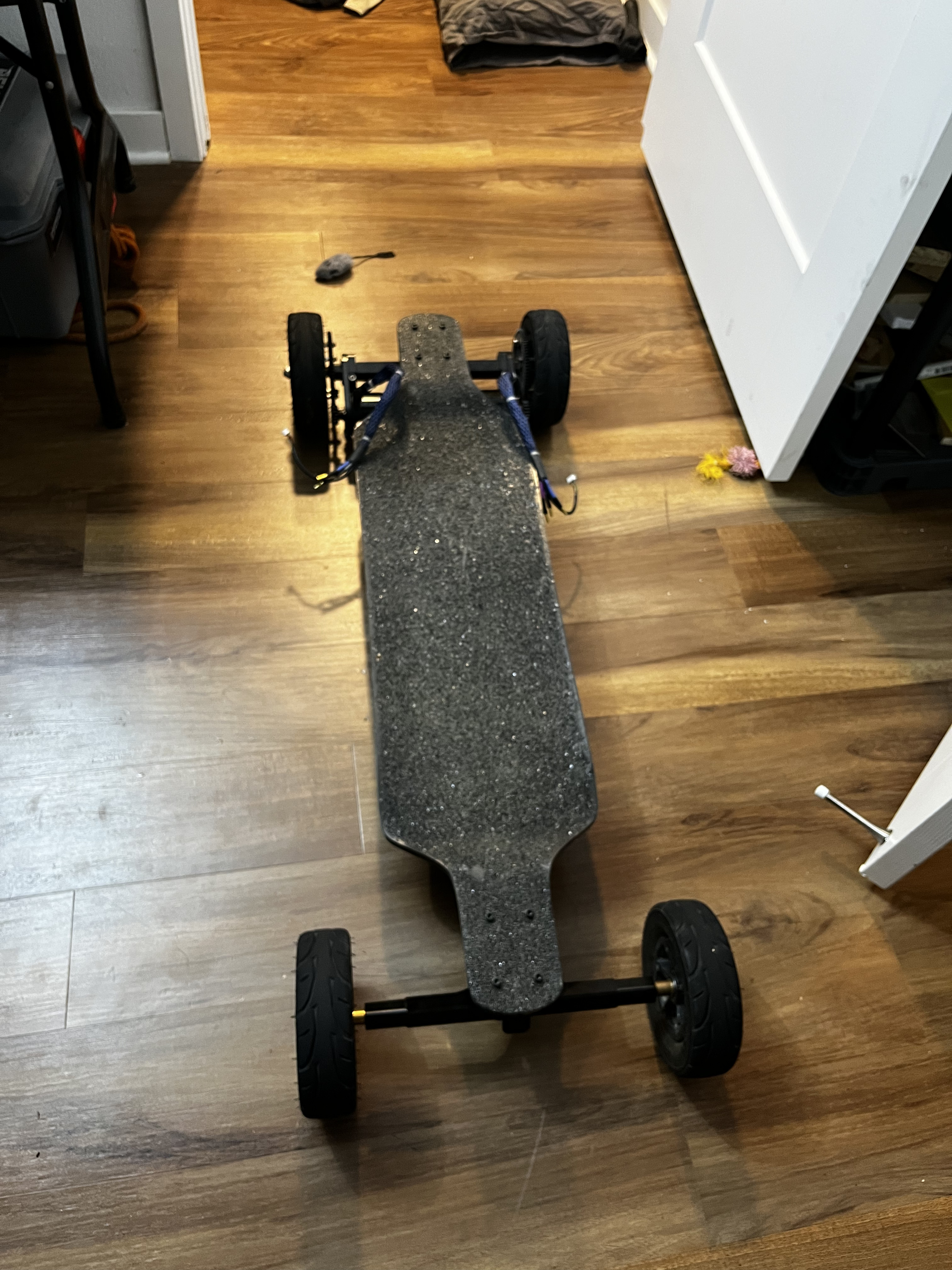

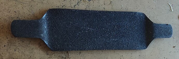

I impulse purchased this fritted deck from @abusfullofnuns here a few months ago.
Great decision, this deck is awesome. I definitely wanted to turn it into a full build, Hence this thread! My first non-meme “proper” build in awhile.

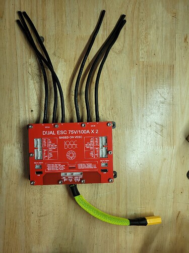

Bought a broken spintend 75v/100A esc from @Benja here like a year and a half ago.
I tried replacing the TJA1051 CAN chips, but unfortunately that didn’t fix it.

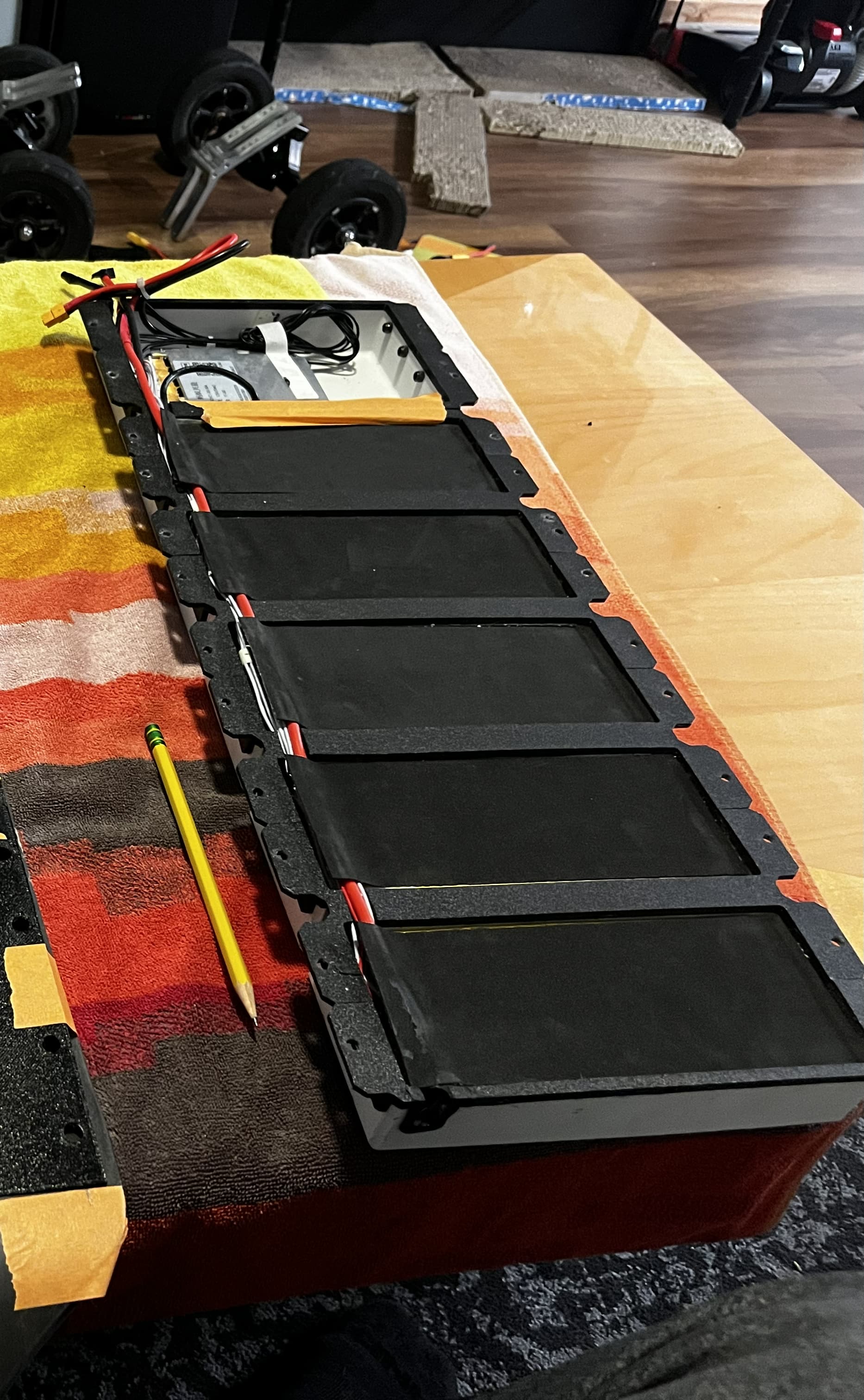

Battery/Enclosure
@TZDKB generously gifted me this battery and enclosure a year or two ago. IIRC it’s 16s liion pouch cells, built into a perfect 3D printed enclosure.

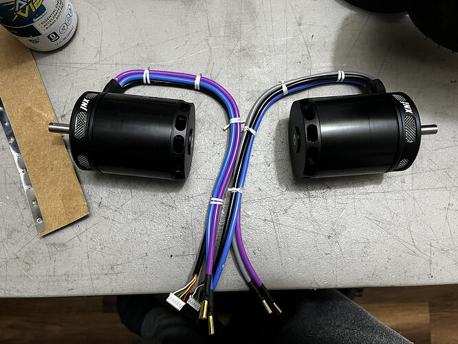

Motors
Reacher SKP 6455, Inherited from Nothing Fancy and I had an IDEA

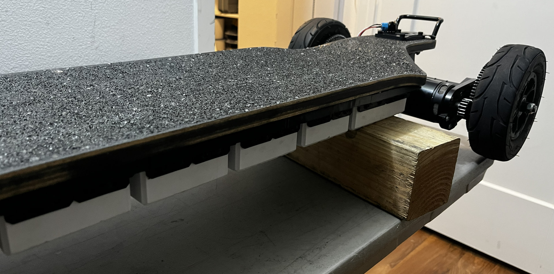

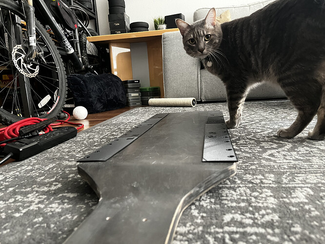

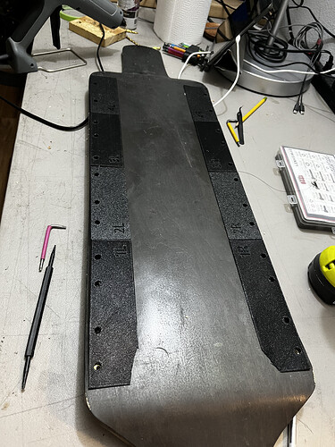

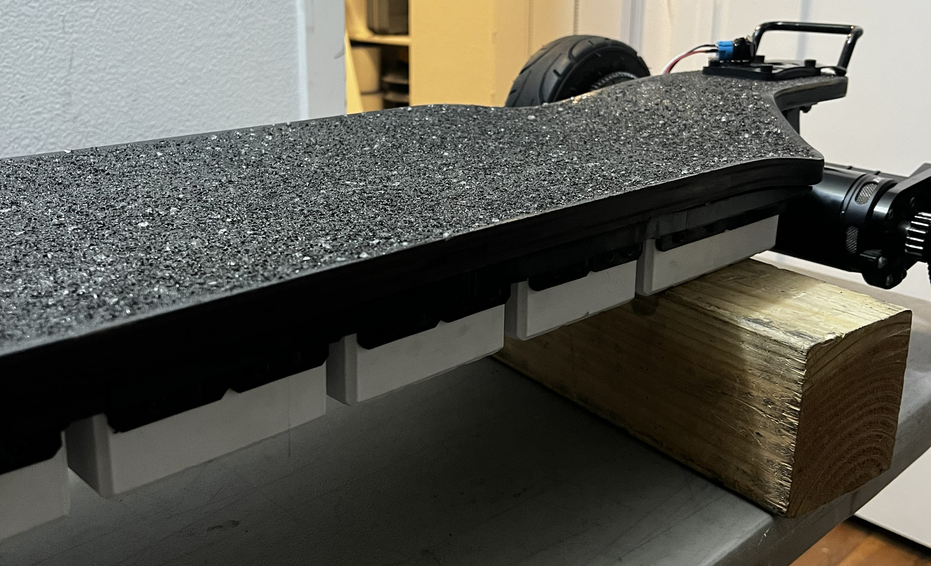

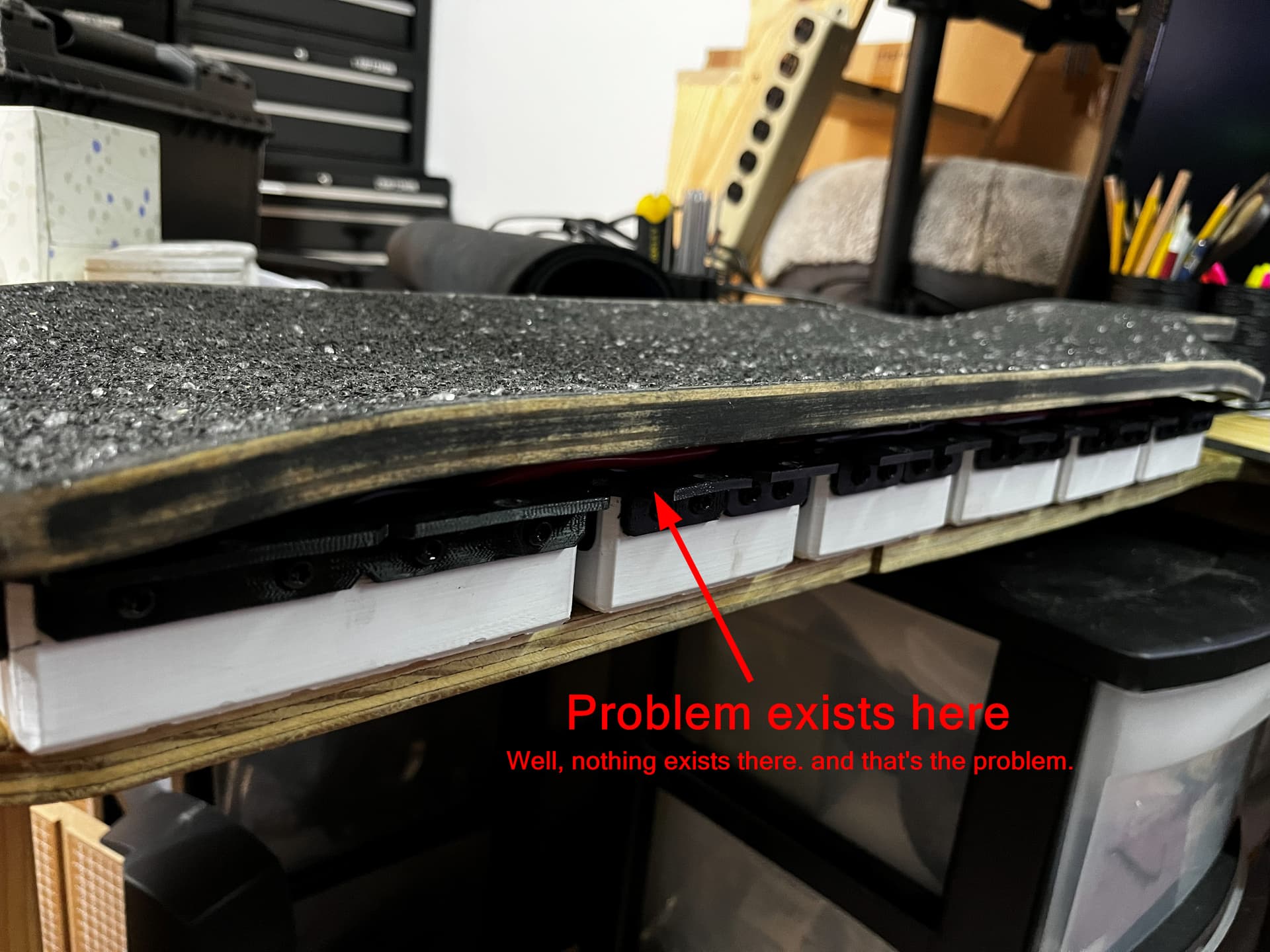

Enclosure Mounting
The enclosure was printed for the Warren deck, which has a flat bottom.
This new deck…isn’t flat.

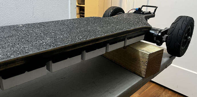

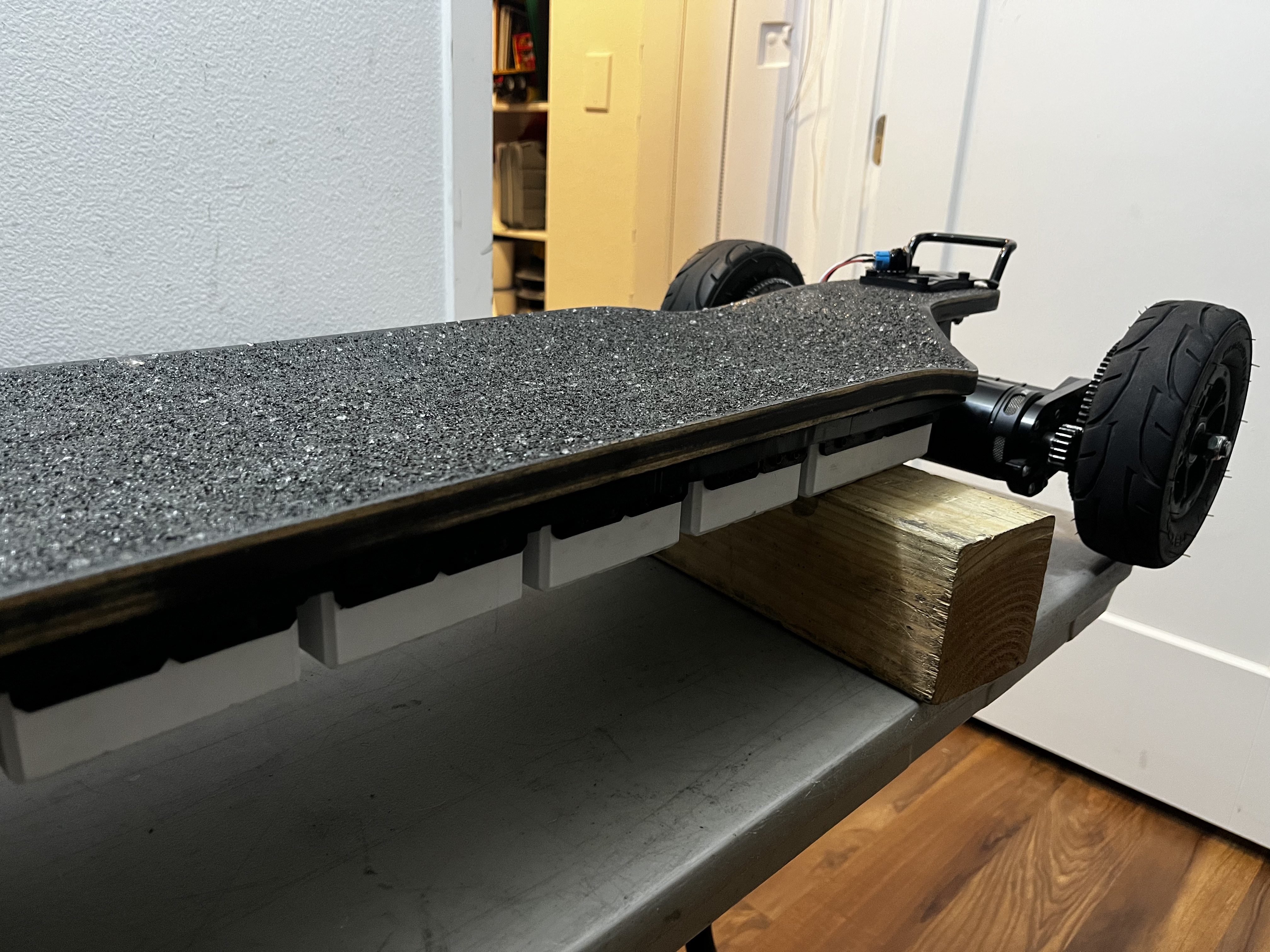

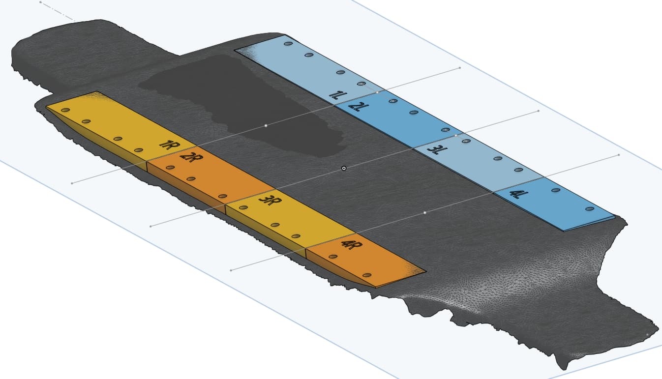

Borrowing a 3D scanner, I scanned the bottom of the deck
And CAD’d adaptors that conform to the deck
Printed with TPU, and they fit like puzzle pieces

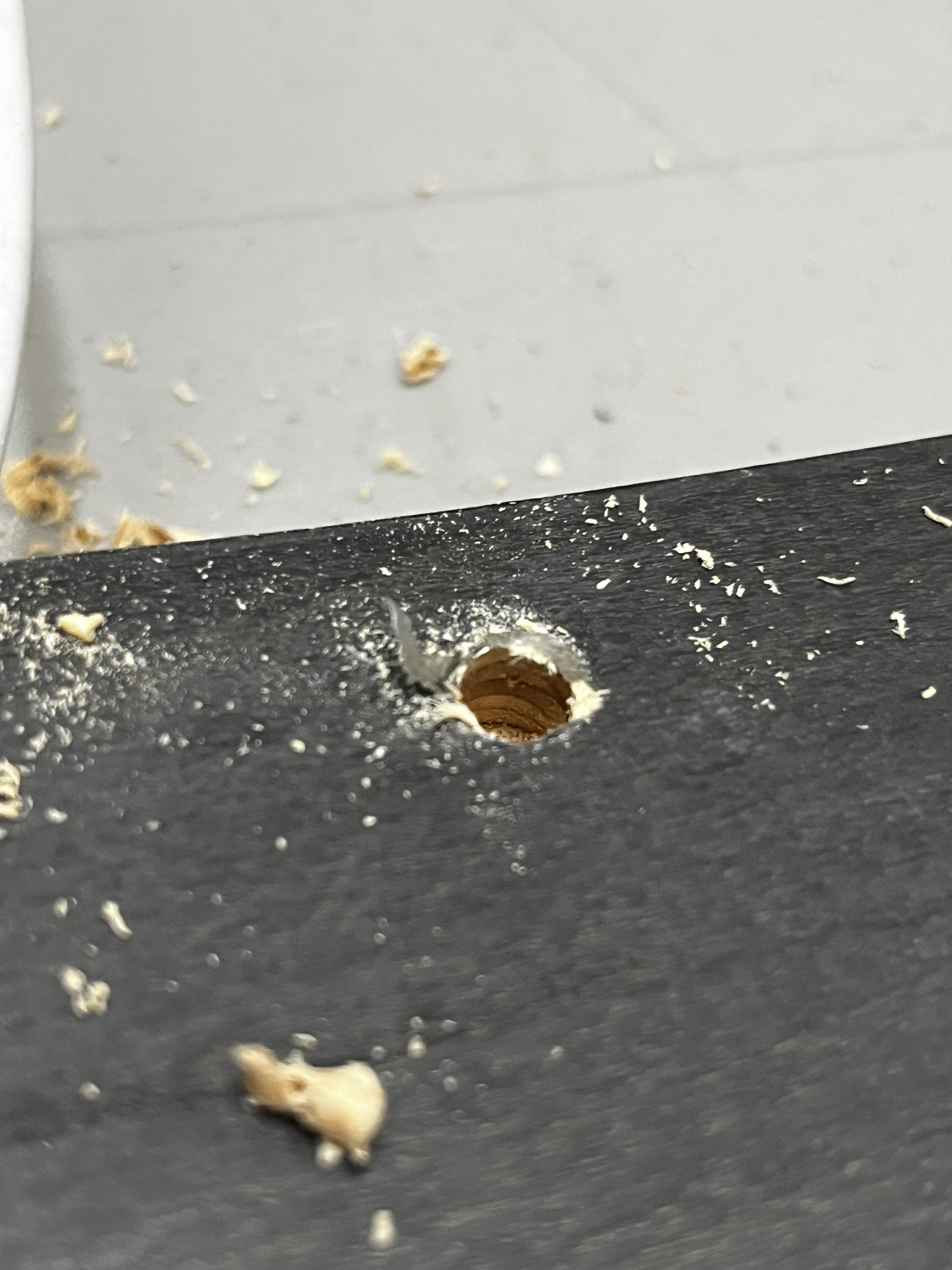

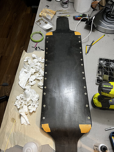

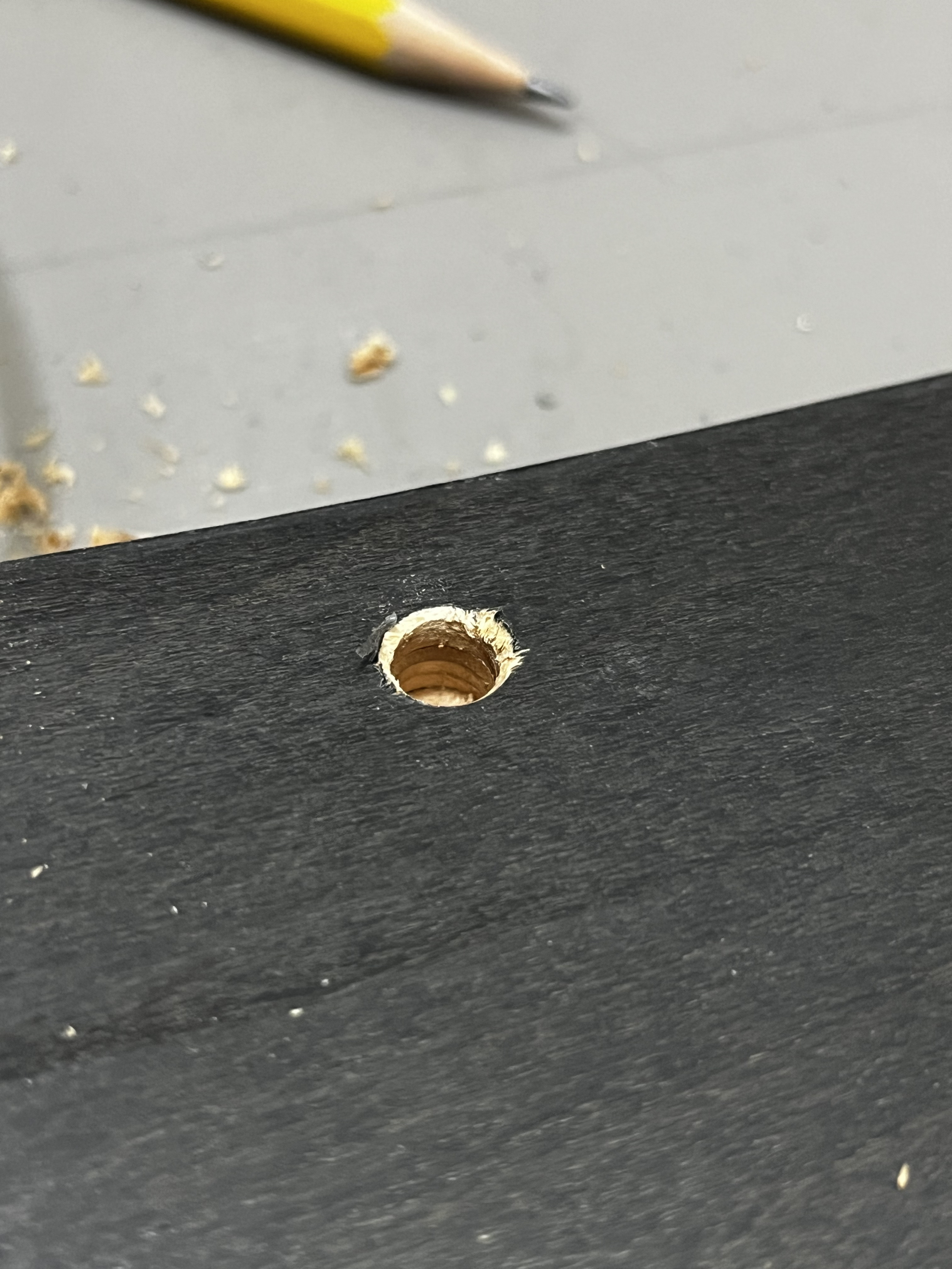

Deck Inserts

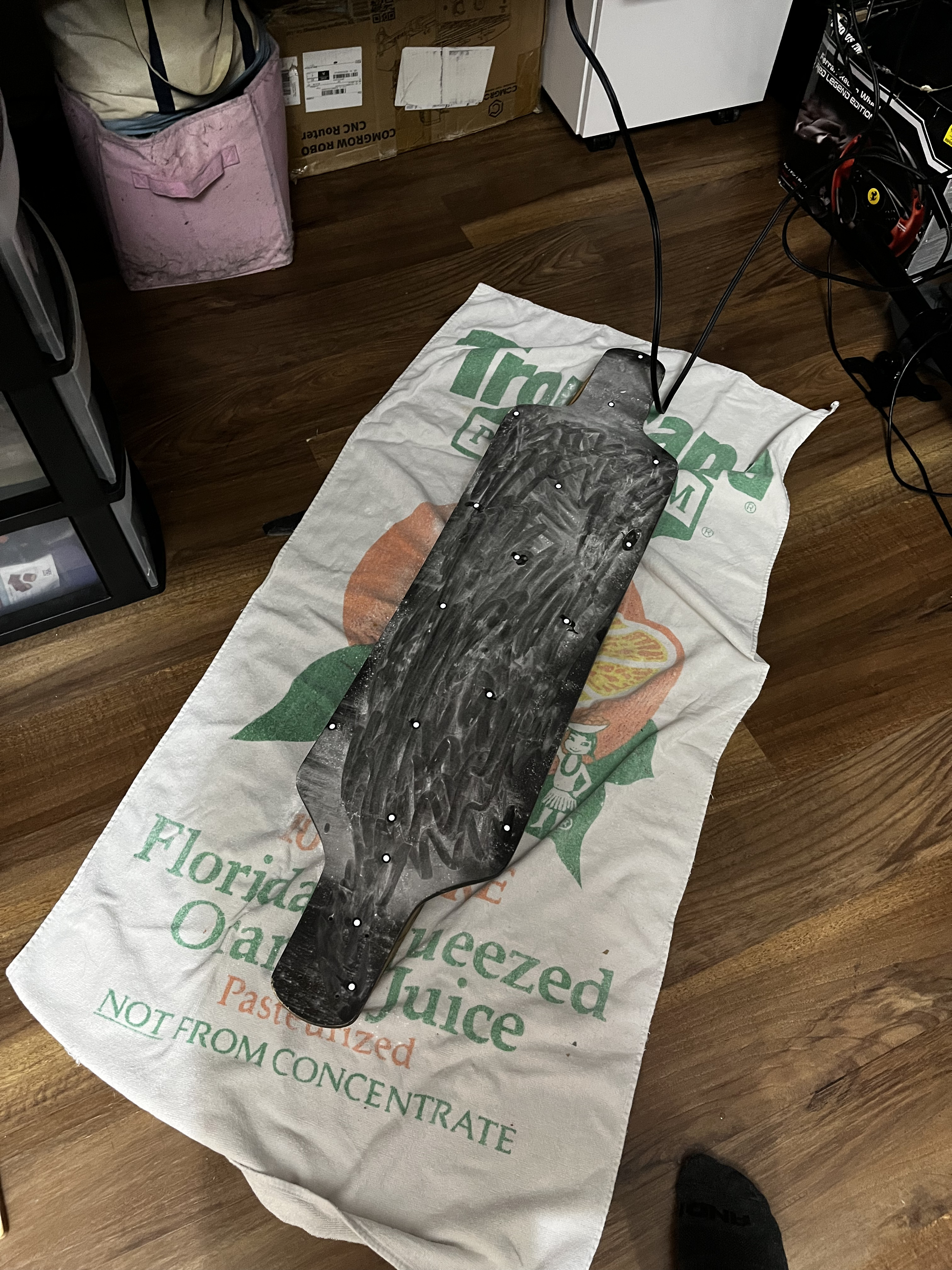

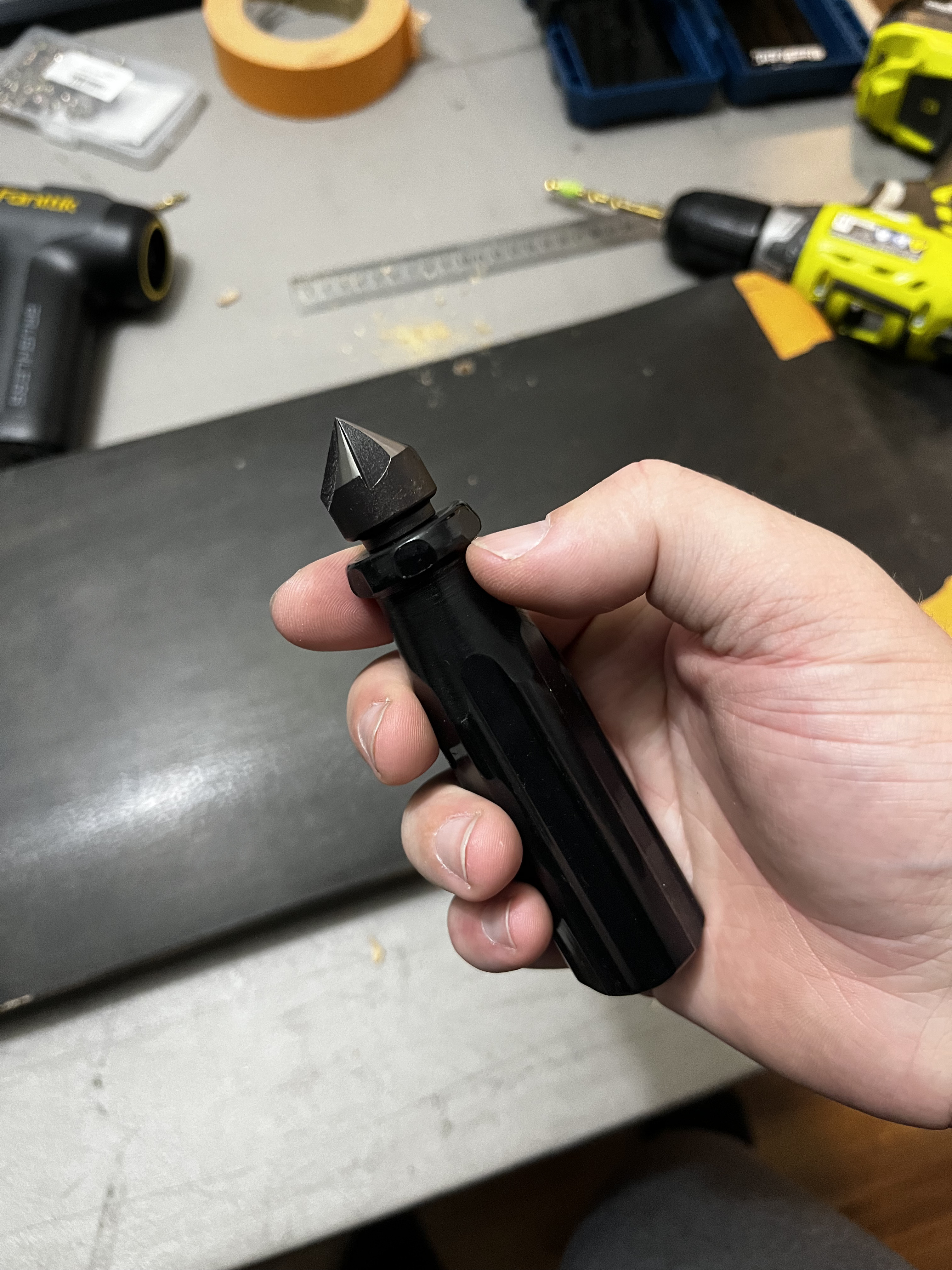

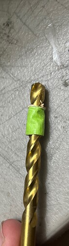

For White Midnight, I wanted to mount the enclosure with something more proper then wood screws. Decided to put brass inserts into the deck.
Can always use an excuse to buy a new tool
8 batches of 5 minute epoxy later, inserts are in.
And promptly hidden by lightly hot gluing the adaptors to the deck.
Don’t need to be accurate if you print with TPU :grin:
All the bolts fit! Dope. The trucks look great on here
My original plan was to drop-through mount Dualities (cutting out a slot in the deck).
I might not need to though!! Feels fantastic as-is (pending track experimentation, of course).

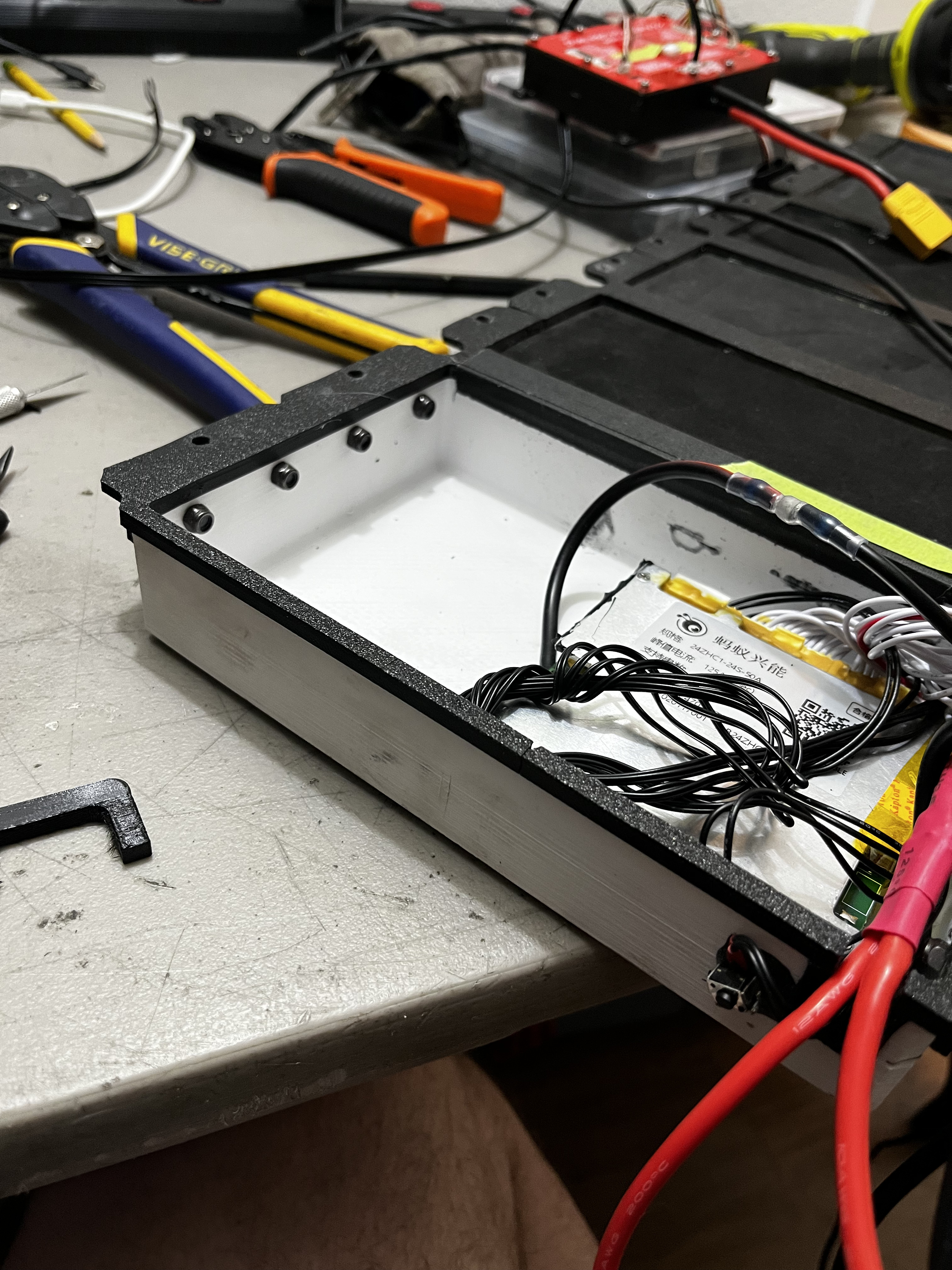

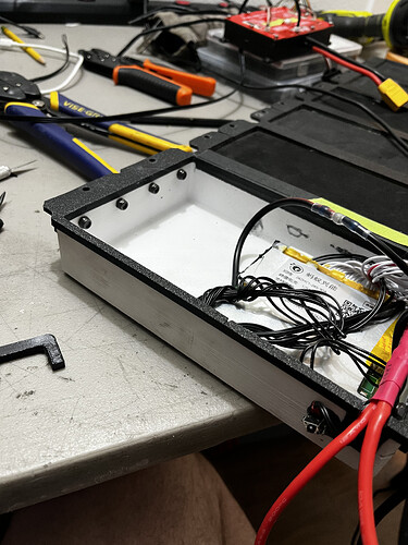

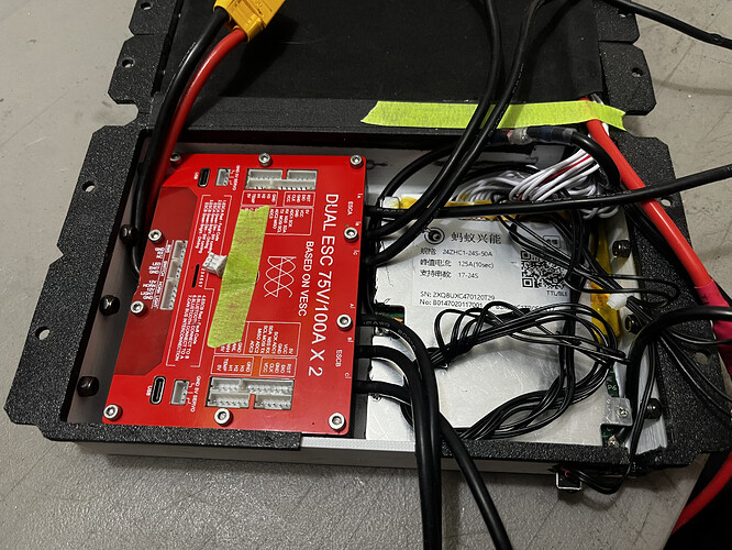

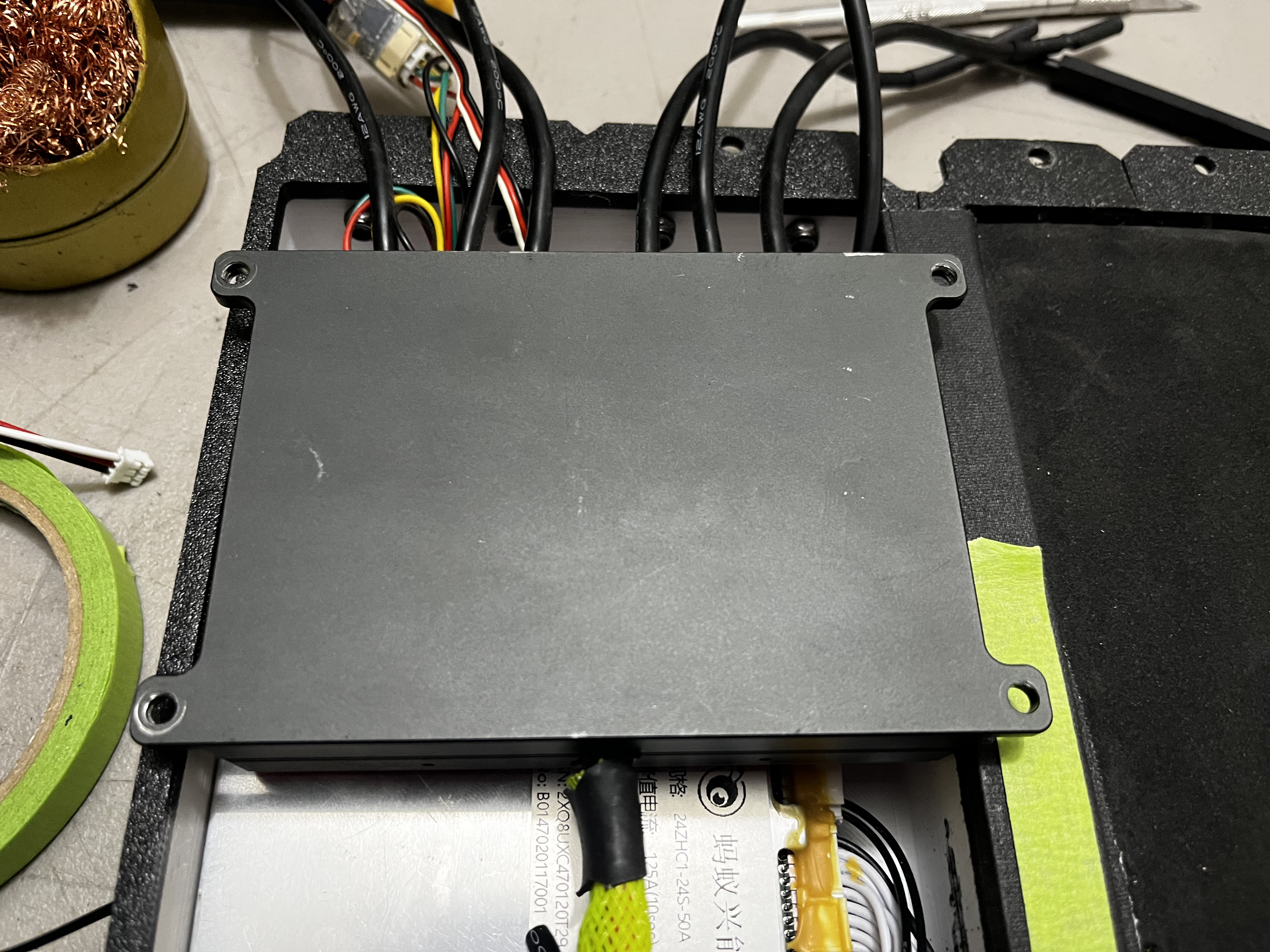

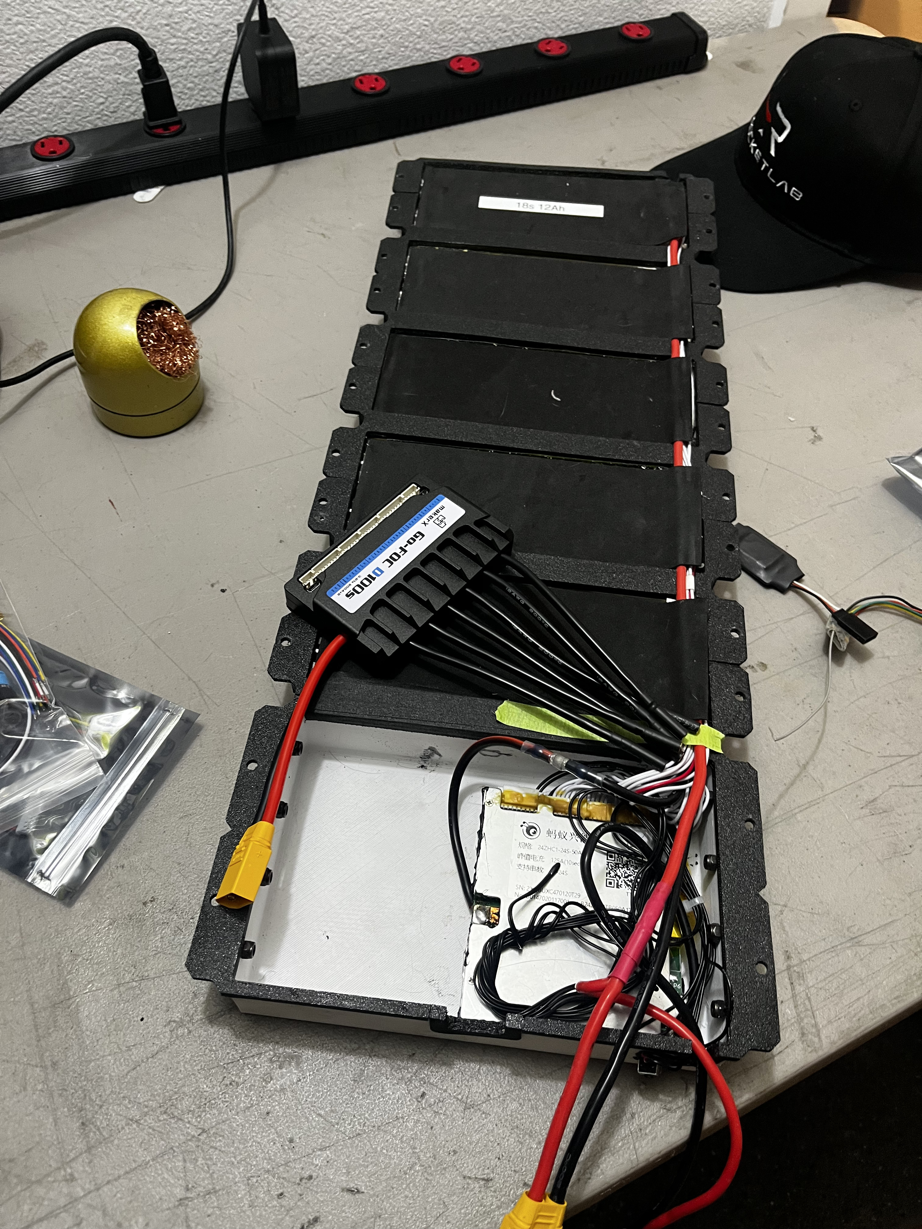

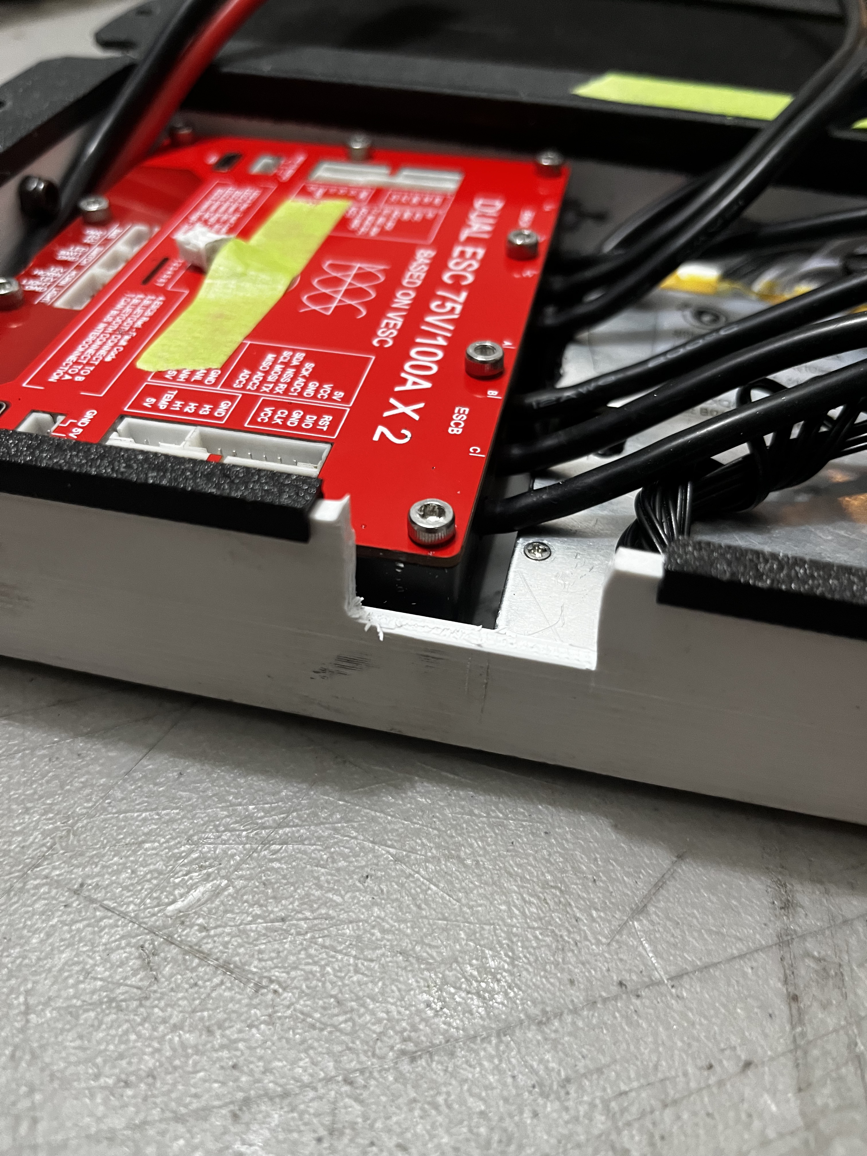

ESC and BMS
The BMS sits in this extra compartment in the enclosure. From the wiring, it seems like this board originally had a rear-mounted ESC box… but I think I can squeeze the vesc in there too (and avoid a rear-mount box :grin:).

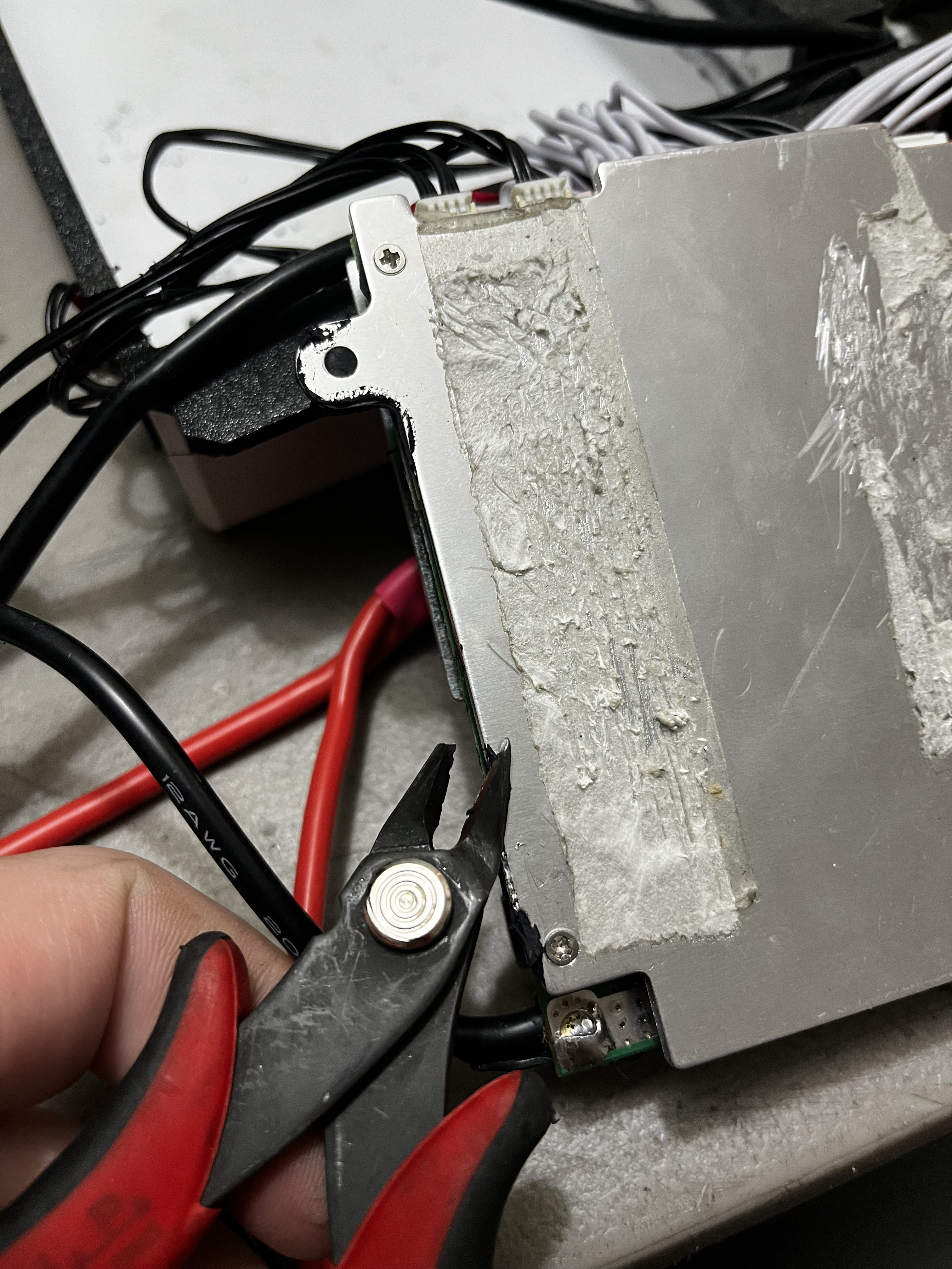

It’s tight though, so the BMS and Vesc need some trimming.
The BMS tabs are made of chinesium, so came off with just a pair of wire snips (did ruin them though… oopes)
VESC tabs also came off with a Dremel
It fits, very cozy!

Vesc not-a-setup
I’m able to connect and do motor detection, but the motors don’t spin like they’re supposed to :frowning:
Playing with the settings yielded no results, unfortunately. Going to keep playing with it, but might just need to purchase a D100s.
That’s where the board’s at right now. All the core features are done, just need a working vesc. Updates to come

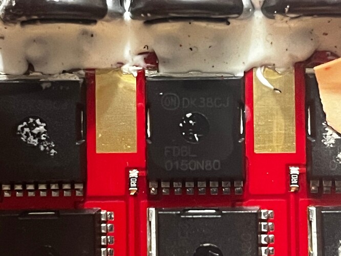

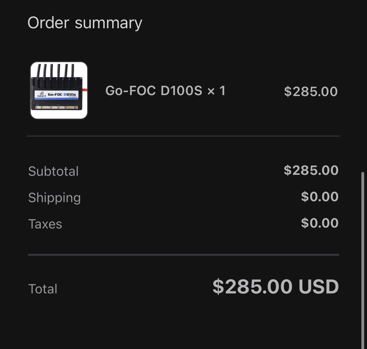

Well, this is embarrassing.
It’s a 18s pack.
So the 75V vesc was never going to work. Only reason it didn’t blow up when I plugged it in was because the battery charge was so low.:woozy_face:
D100s inbound.
PHEW

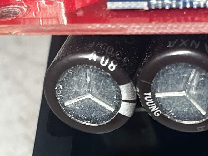

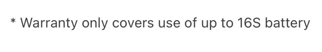

While I know they might not have a great reputation for not burning, the Kaly XLR used those VESCs on 18S. Or at least I’m pretty sure they used the same FDBL0150N80 (80v) mosfets and the rest of the VESC is good for more voltage since the J version only changes to 100V mosfets for 18S or even 20S iirc. It might have a max voltage limit set in the VESC tool.

Verrrry interesting. I popped the hood off to verify for myself, and you’re totally right.
Still, <5v of headroom… little tight for me I think.

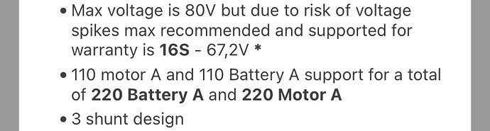

I was skimming the forum and found these series of posts, suggesting even 16s might be risking it? Curious your take.
I’ve heard PETG has the 2nd best layer adhesion after TPU
Yea 18S is a bit tight for 80V. I know lots of Kalys did it without trouble but they did have rheostatic braking as well as / instead of regen. I think higher Kv, low iR battery, short thick wires, extra capacitors would all help. Only charging to 4.1v is a good idea for longevity anyway. Maybe you could use TVS diodes but that’s above what I know about enough to recommend.
If it seems pointless, mosfets do work most efficiently closer to max voltage like 80V FDBL0150N80 have both a bit lower resistance and gate charge than 100V HYG015N10NS1TA used in D100S. That and other design differences should make it run cooler than D100S.
Edit: some interesting info from the Bioboards one. It implies over 16S is a risk but not impossible, that 220A rating has me interested in playing around with more battery amps. Reckon I can?

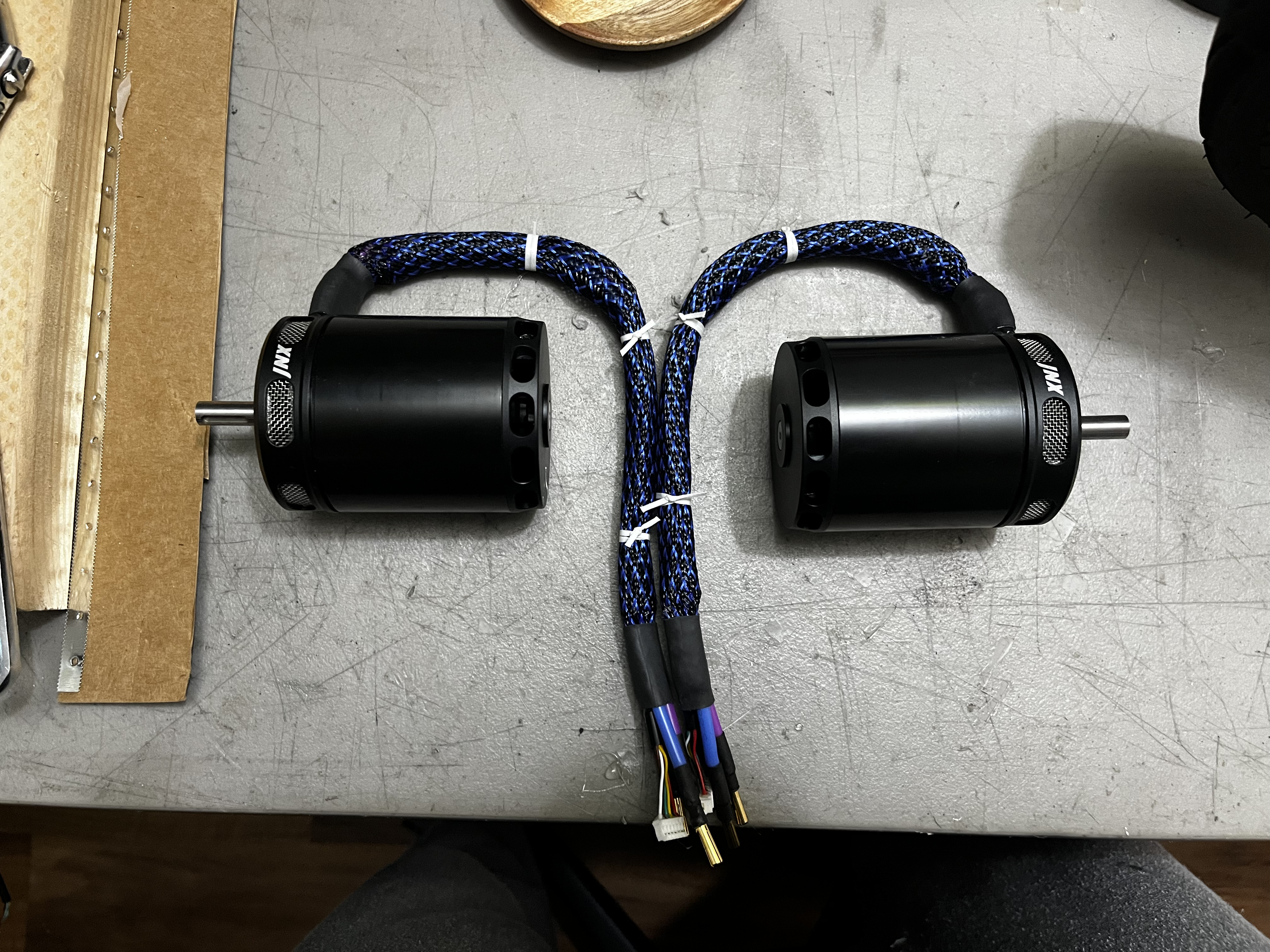

If I’m spending money on a new D100s, what’s a little more for proper motors.

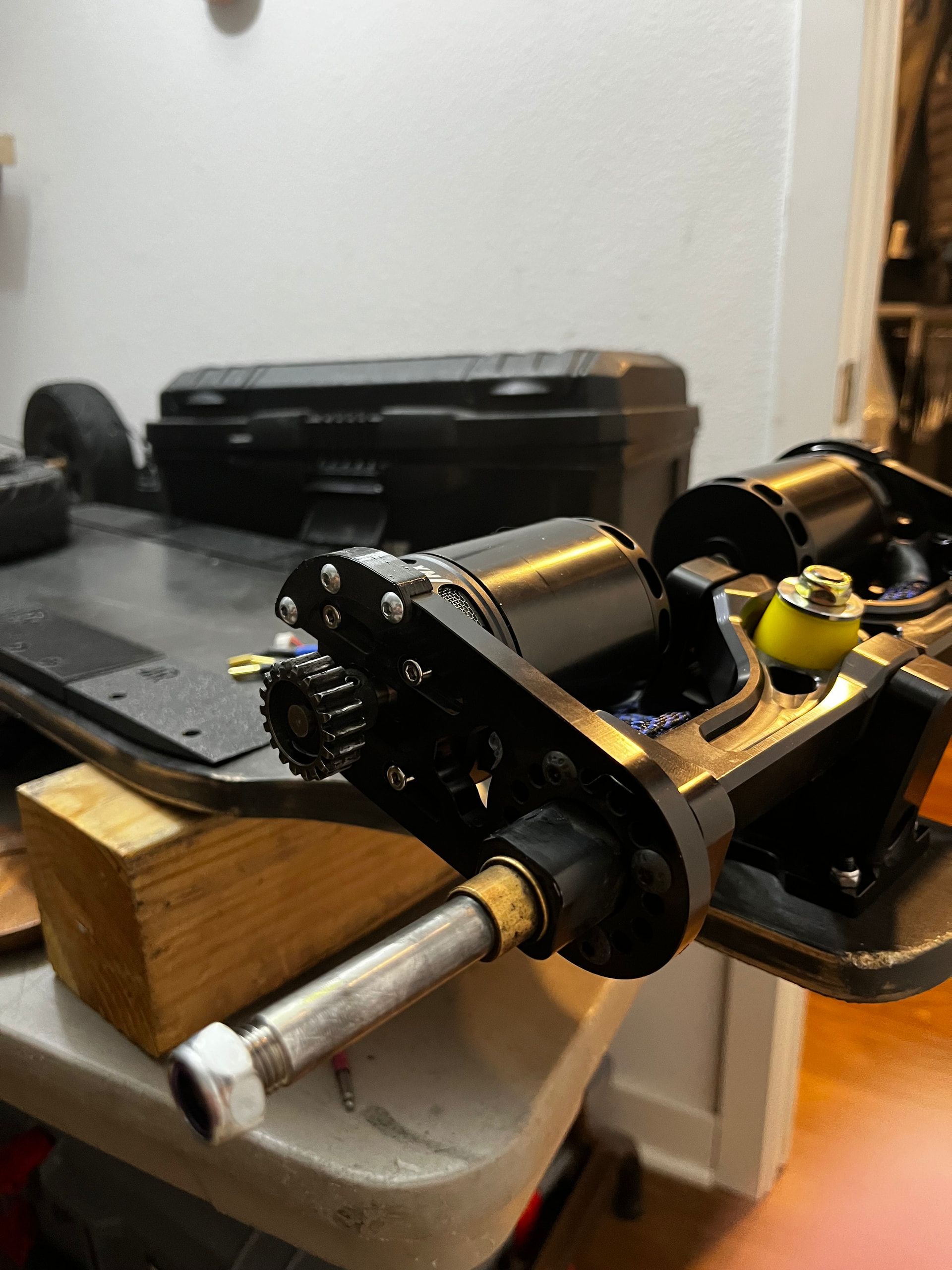

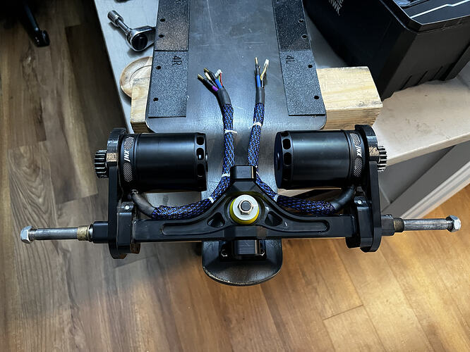

So instead of 6455’s, White Midnight is getting some 173kv 6485s (from @Mobiusray)
Tied up the wires into shape
Added overbraid
Mounted, ready to go. Just still waiting on the D100s from MakerX

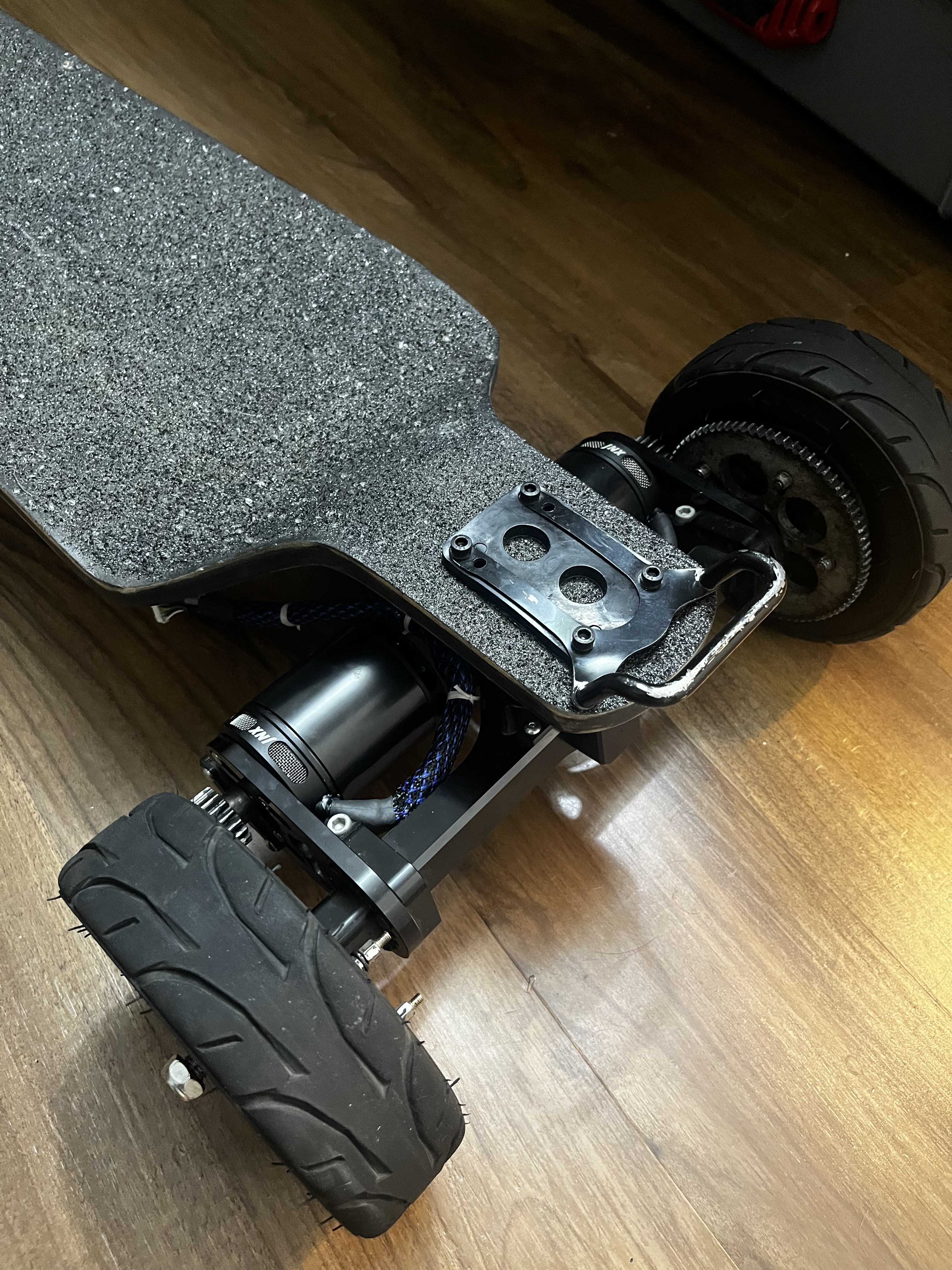

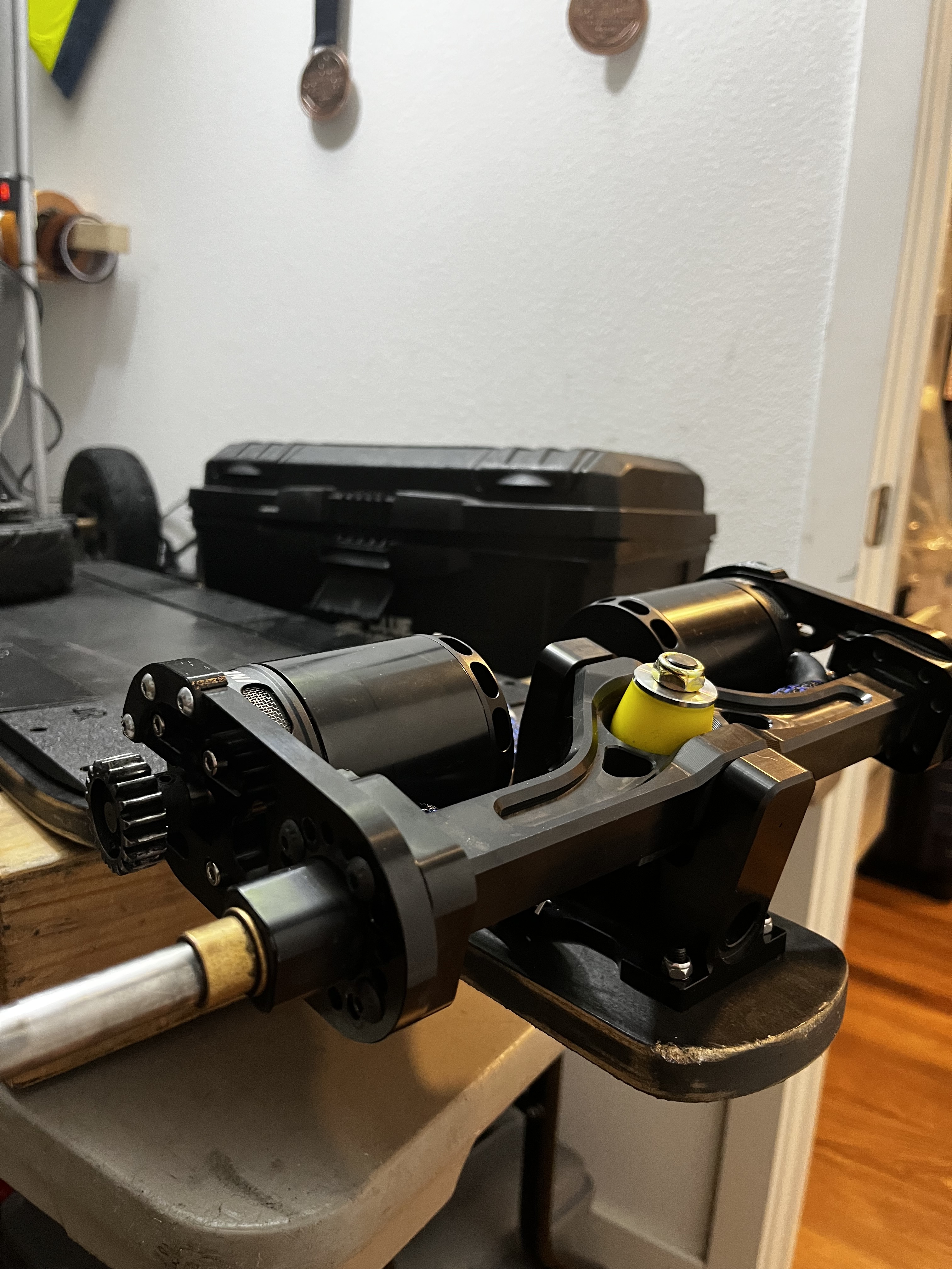

Starting with some 18T pinions (78T spur). Should give the board a top speed >50mph :grin:
Decided to lower the motor mounts a few degrees
Also added a spare handle I had sitting around

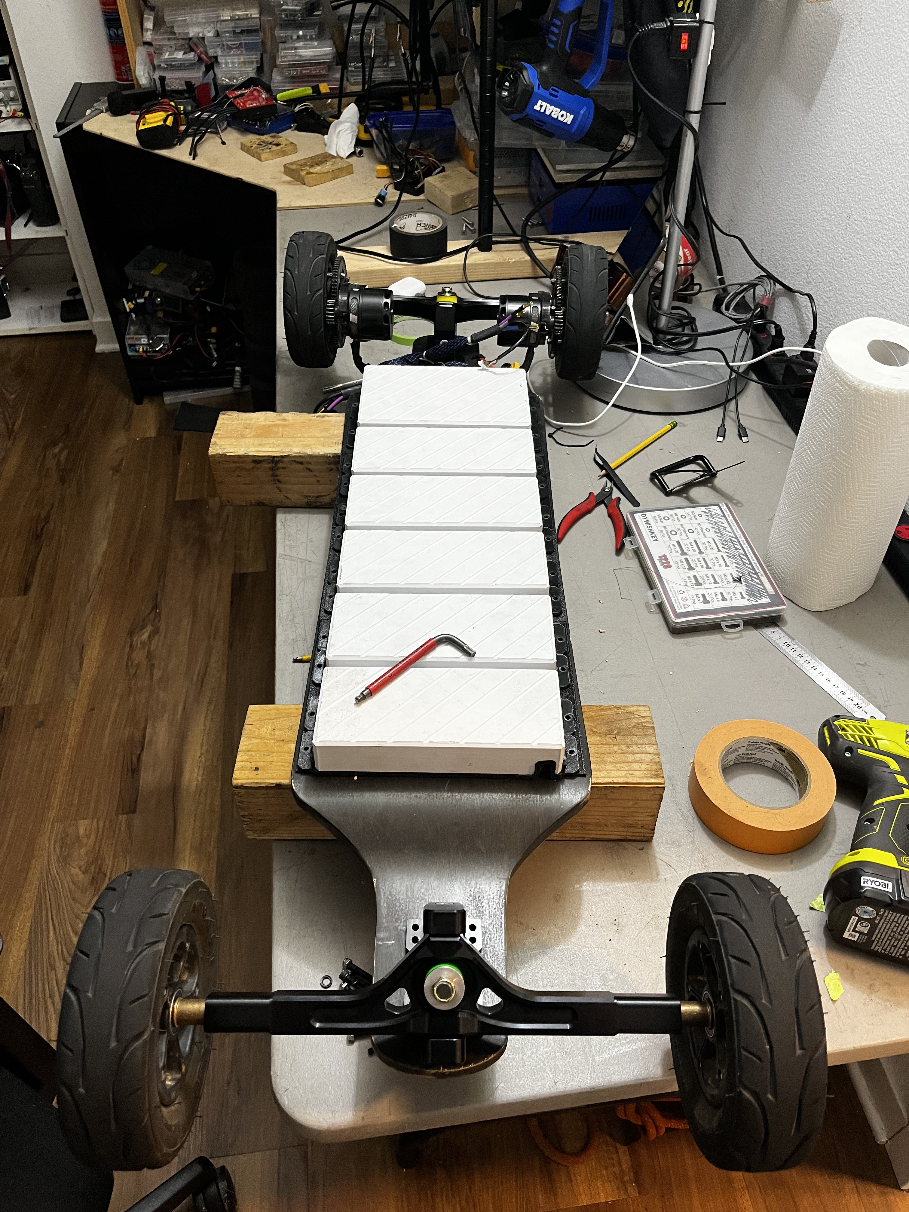

D100s arrived today! It’s finally ridable.

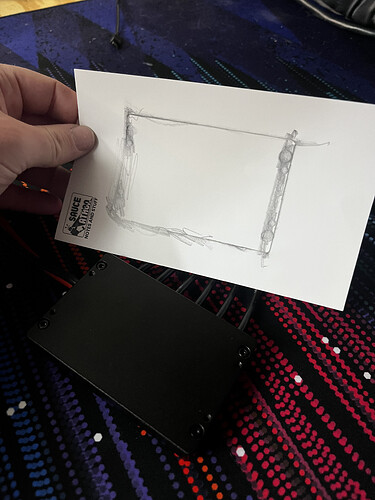

Started tracing out a hole pattern to drill bolt holes in the enclosure…
Before realizing it’d be way easier to just use VHB (and it’d look cleaner) :rofl:
Having no idea the quality of the battery, I opted for conservative settings
Then got the enclosure mounted!

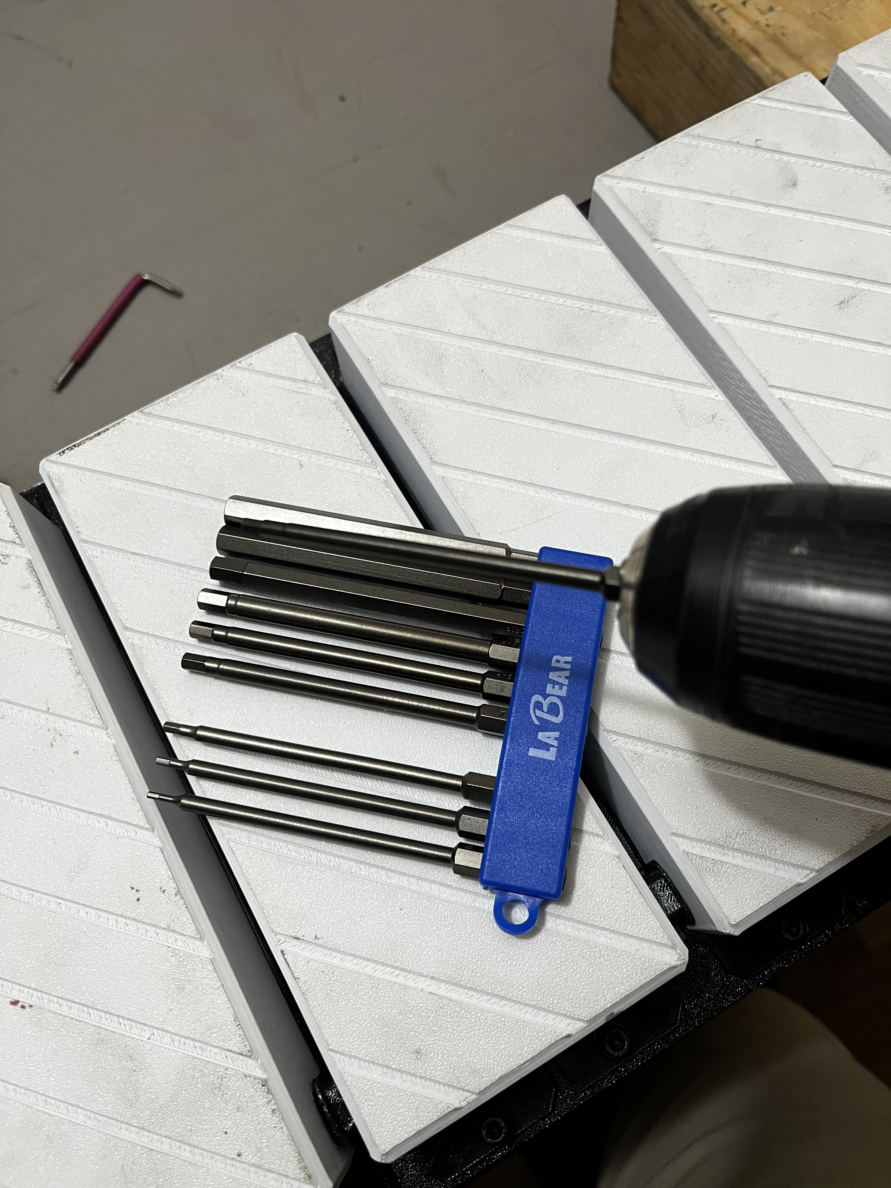

Any excuse to by a new tools (Long metric Hex Bits)

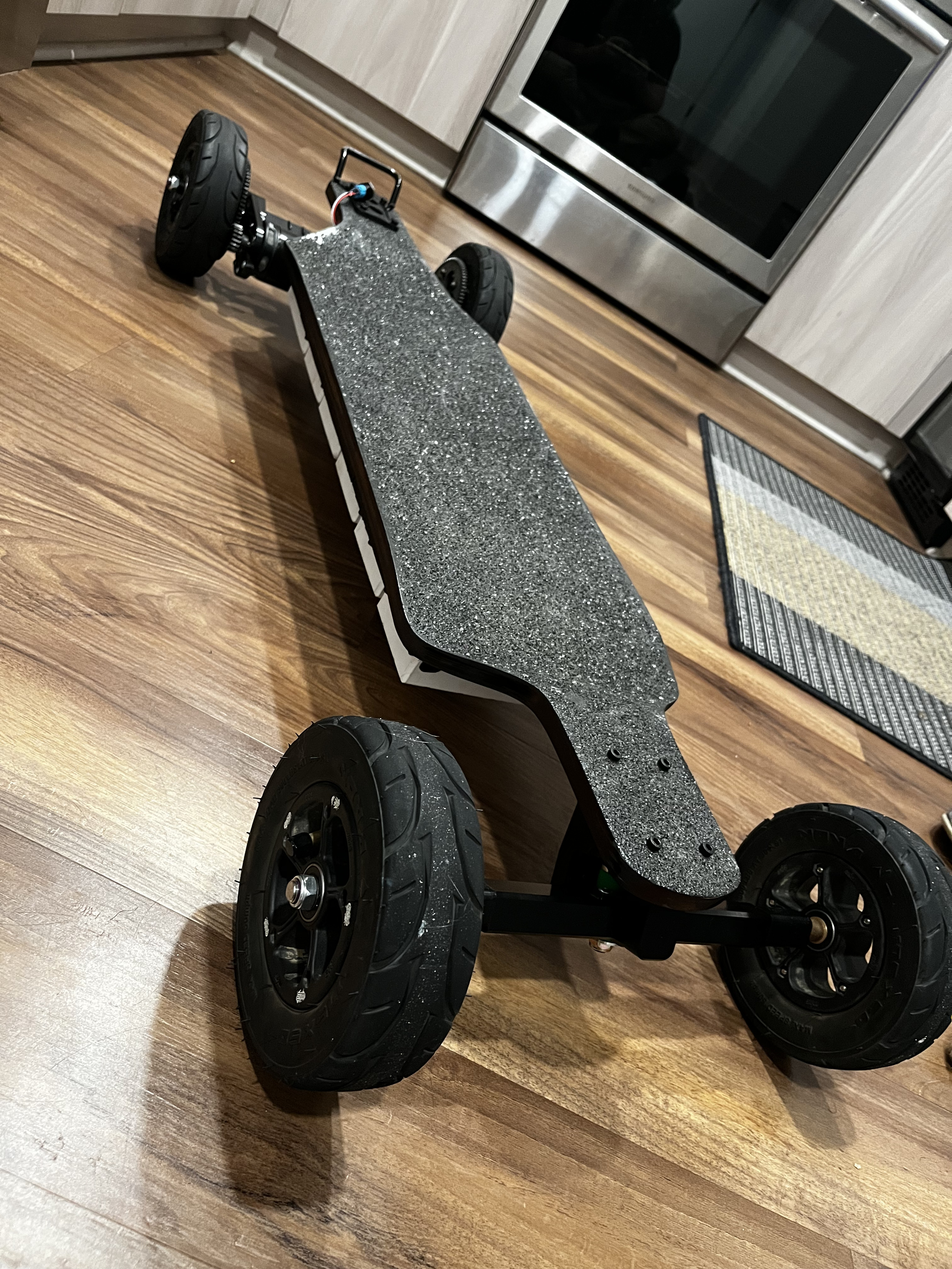

Buttoned up and ready to go. :tada:
Excited to race on track tomorrow

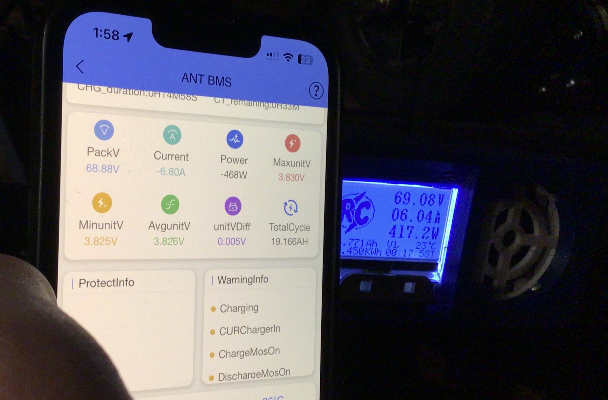

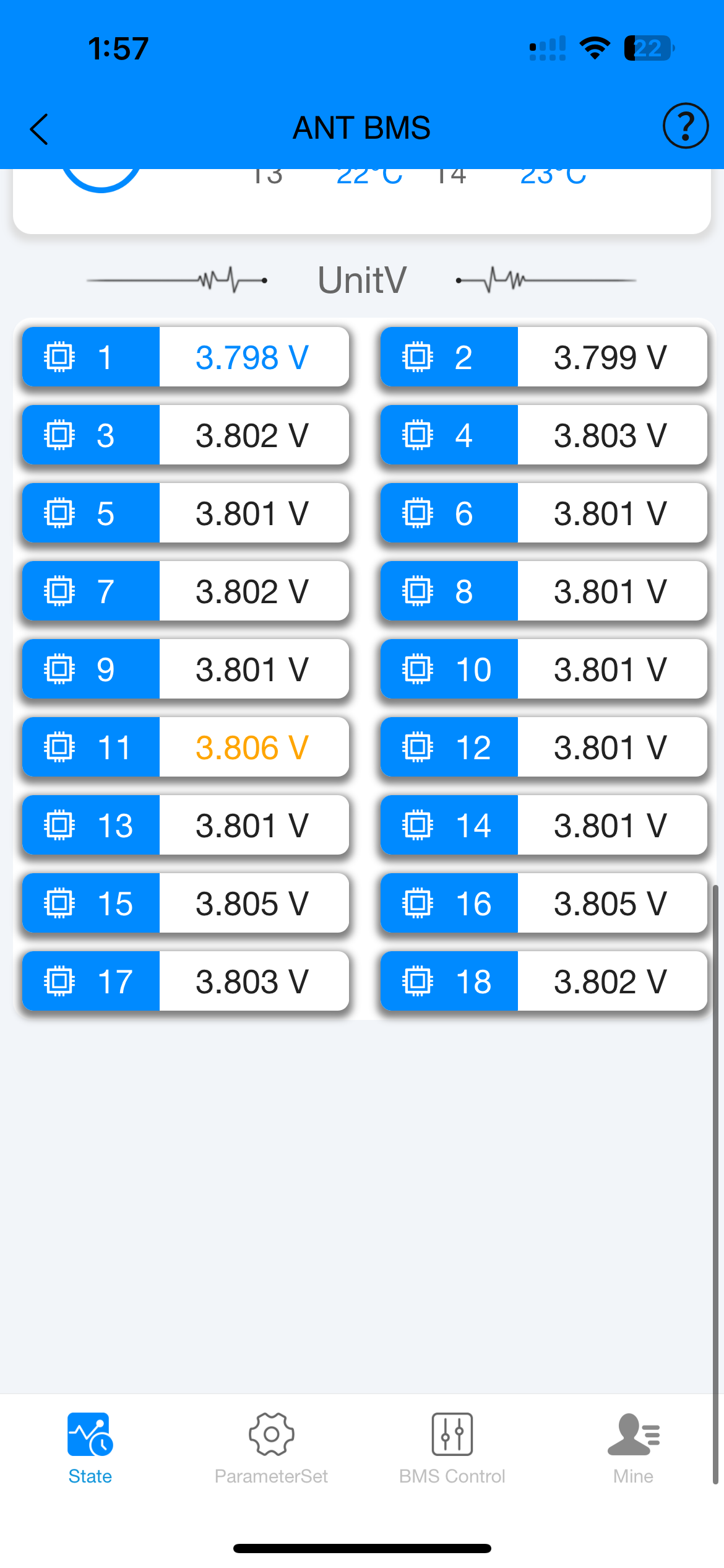

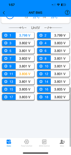

Charging it up now with my Roger charger at 6A
Checking the Bluetooth BMS, it’s charging at 6.8A.
Yay! Free energy lol
