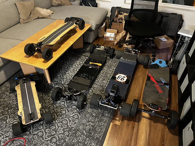

It's no secret that I really like @Titoxd1000's duality trucks. Playing to the bit, I made some MS paint jokes about putting Duality trucks onto a v5
One thing led to another, and I realized that it wouldn’t actually be that hard to build.
A build of spare parts
A spare ubox vesc (that has a blown CAN bus that I’ve been meaning to repair for months. See above picture)
@Trivv3 lent me his Golden Superspine (which was originally won by Gialong at AVS)
@HAIRYMANJACK lent a set of batteries, 7490 motors, and 78T gears that he used to race with.
The only new part on this build is a set of dualities
