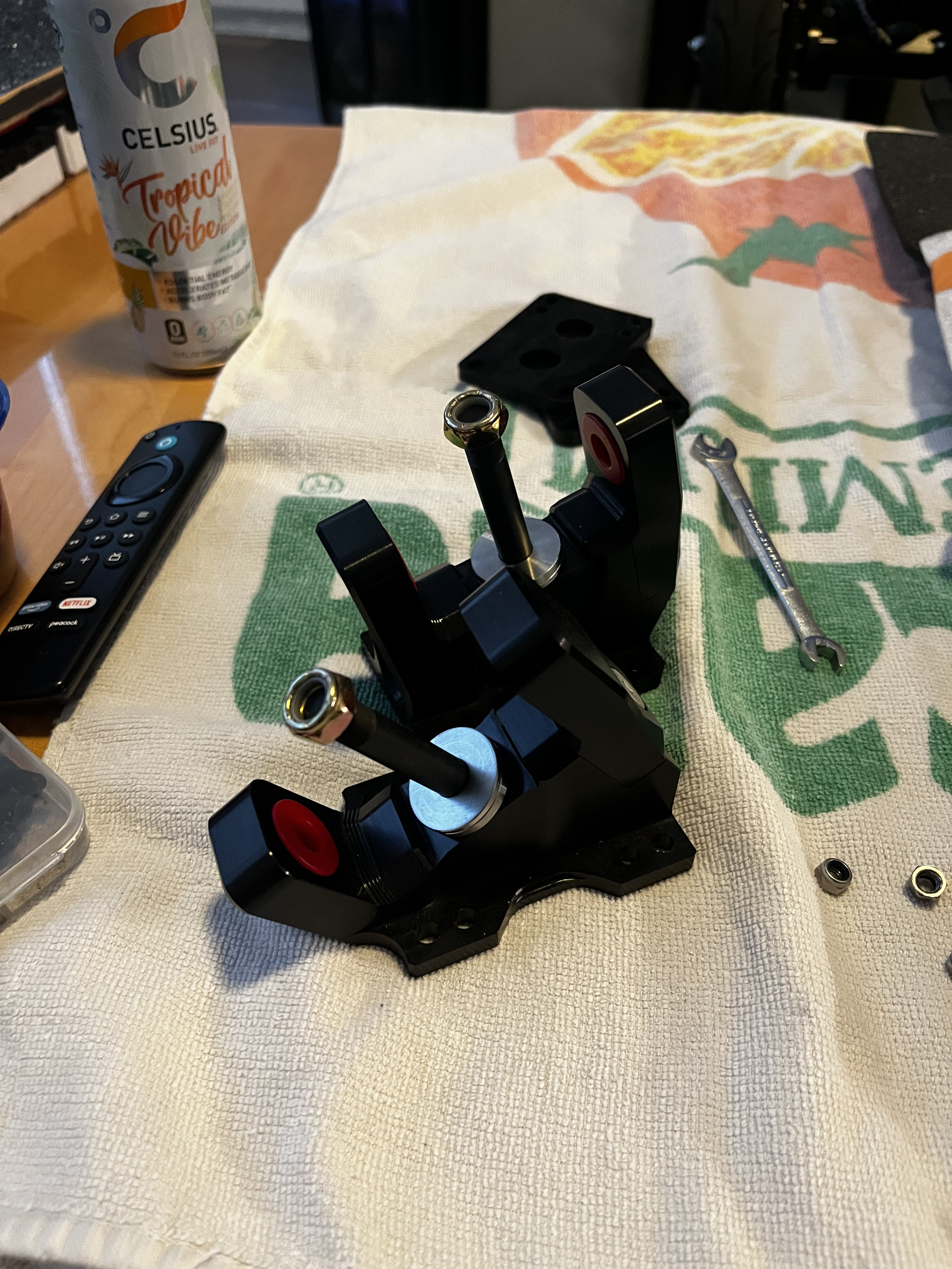

I recently bought @fessyfoo’s pair of IDEA brackets, just to do stupid stuff with them

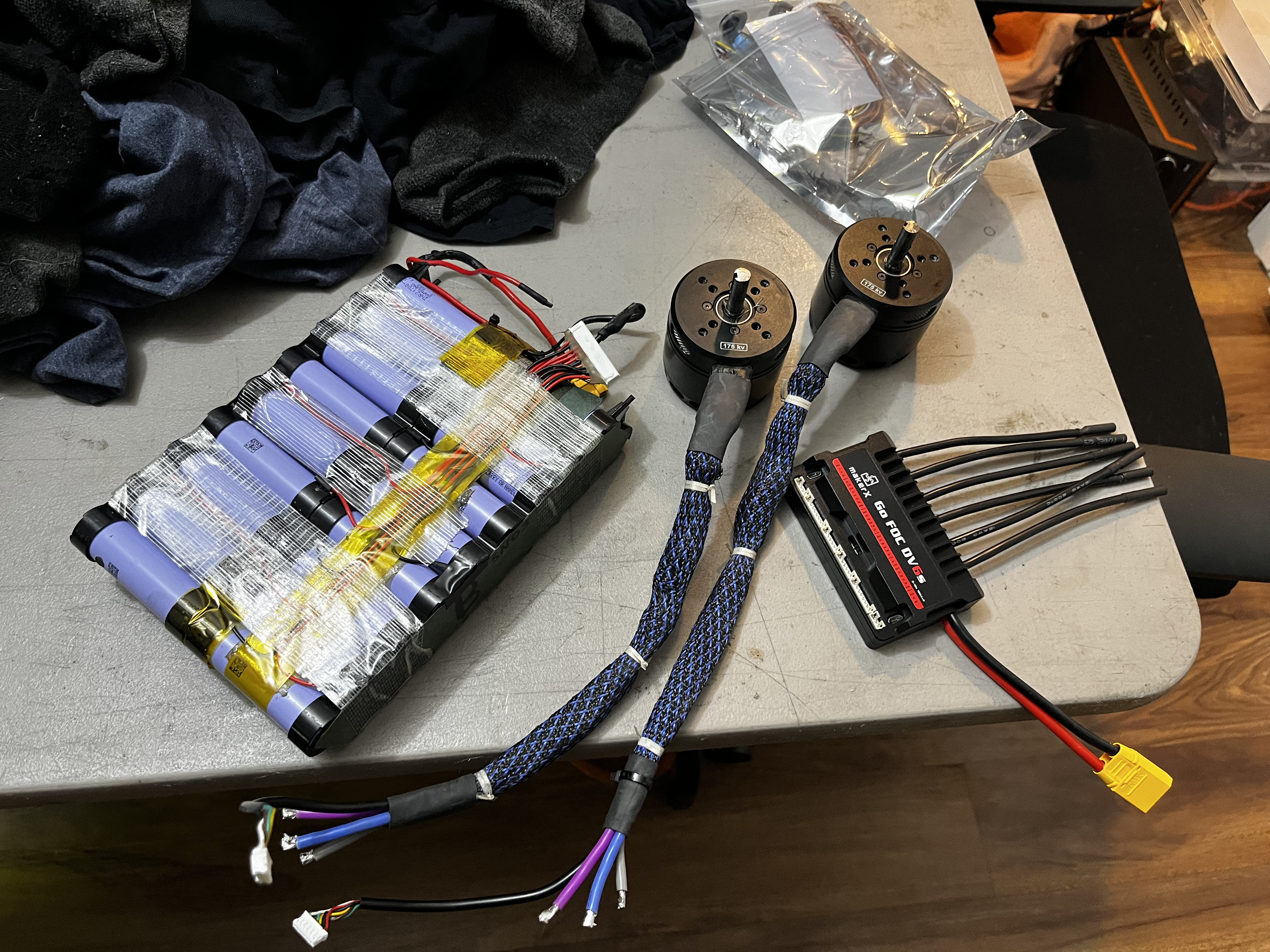

Components
Electronic package

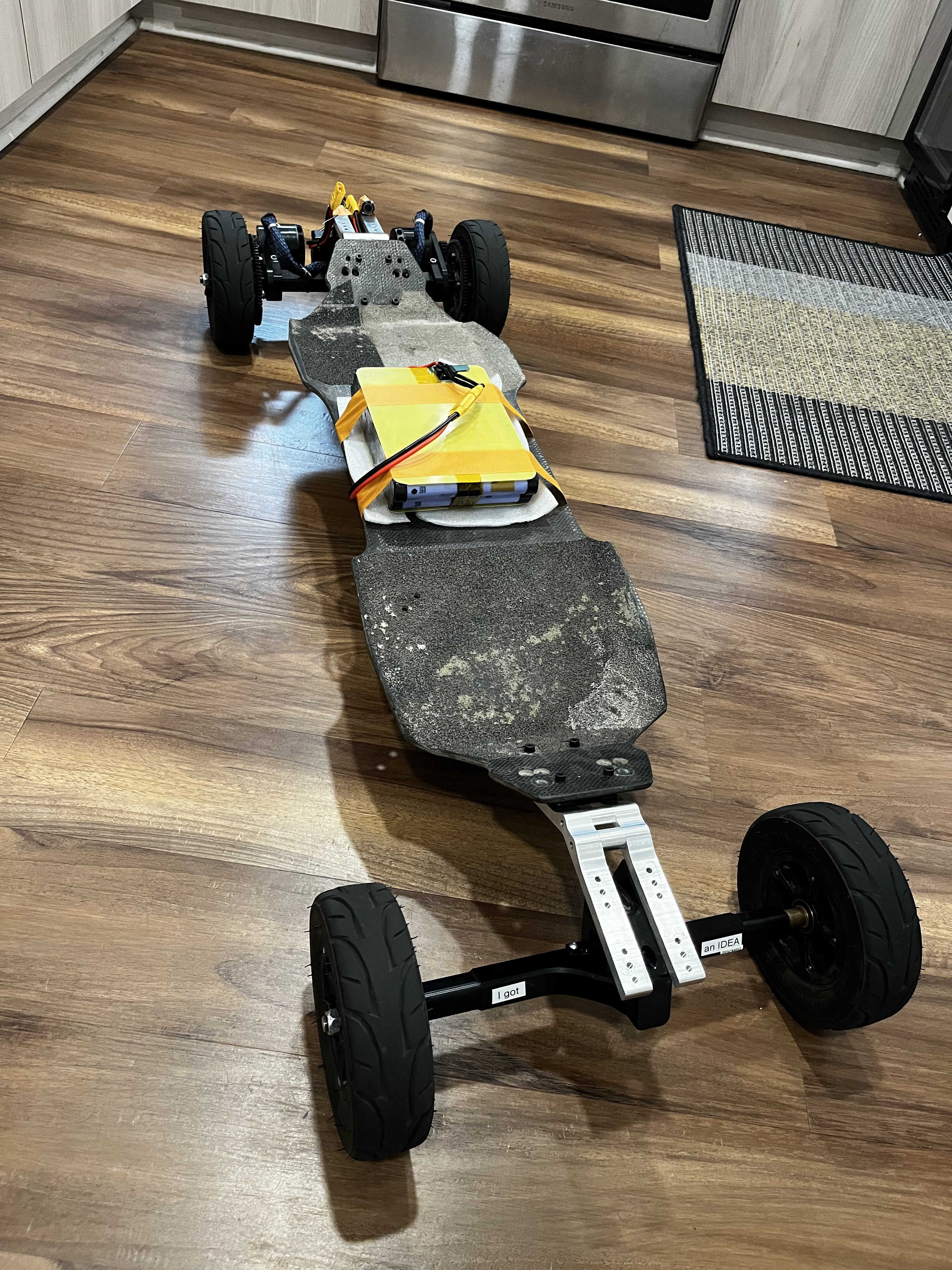

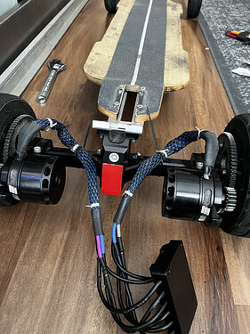

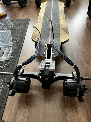

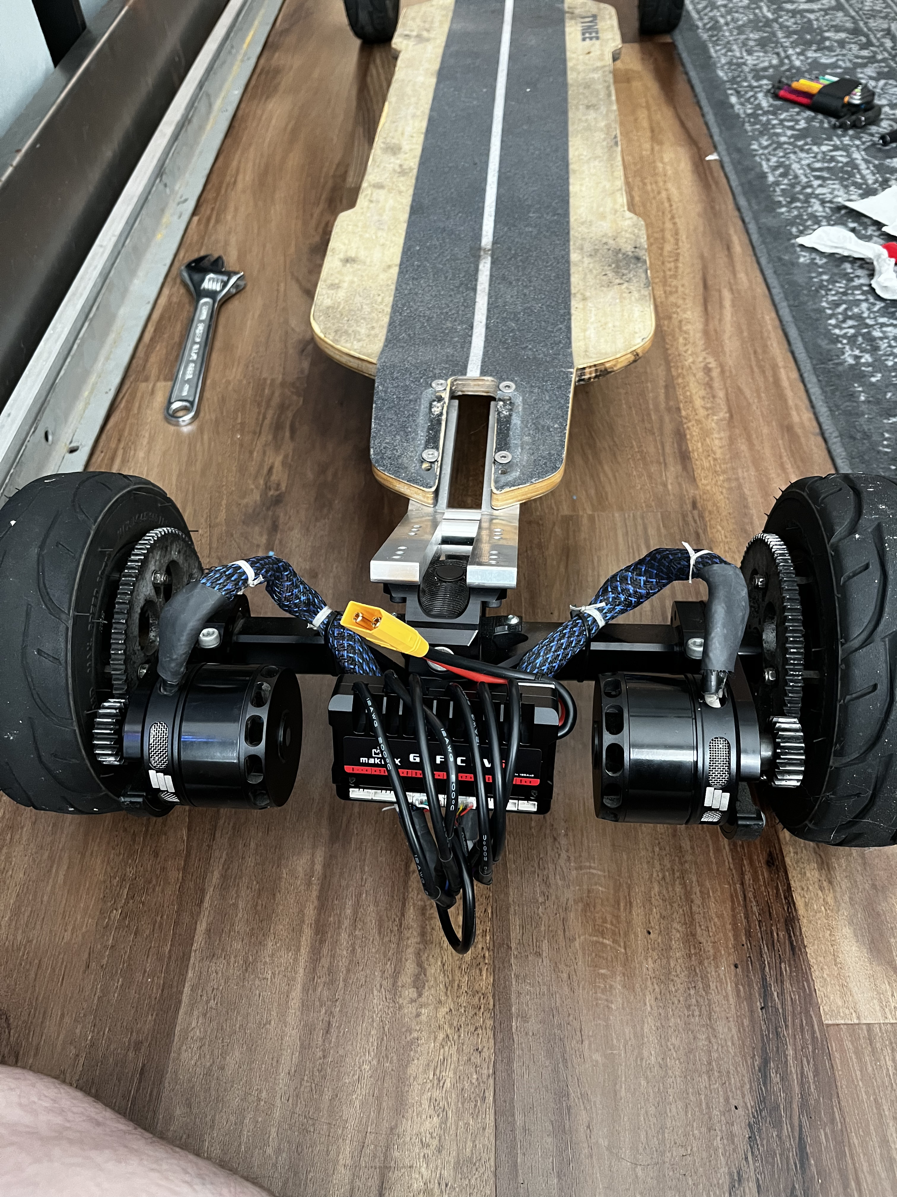

Because I want to experiment with different decks, for shits and giggles, everything needs to be mounted to the trucks. Should make swapping decks, adding wedge plates and/or changing IDEA bracket orientation easy.

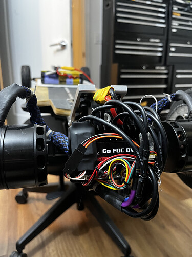

Motors mounted with no surprises
ESC gets mounted with a strip of VHB

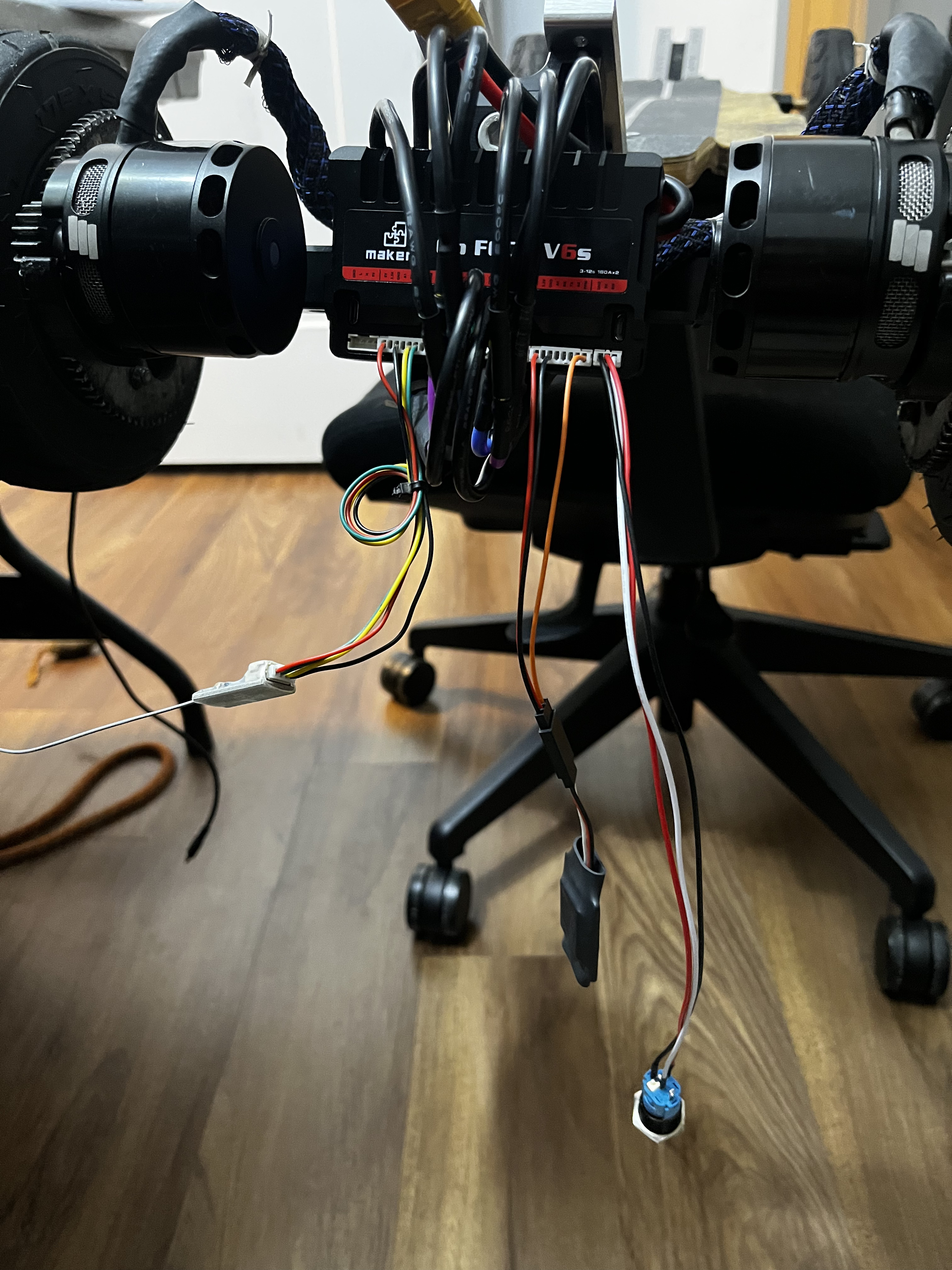

Adding peripherals only required some minor JST crimping
  • Hoyt Puck Receiver
  • MakerX Bluetooth module
  • Power switch
Shortly after, all mounted with hot glue
Hot glue on a motor controller’s heatsink?!.. shhhh of course. silly question. Moving on.

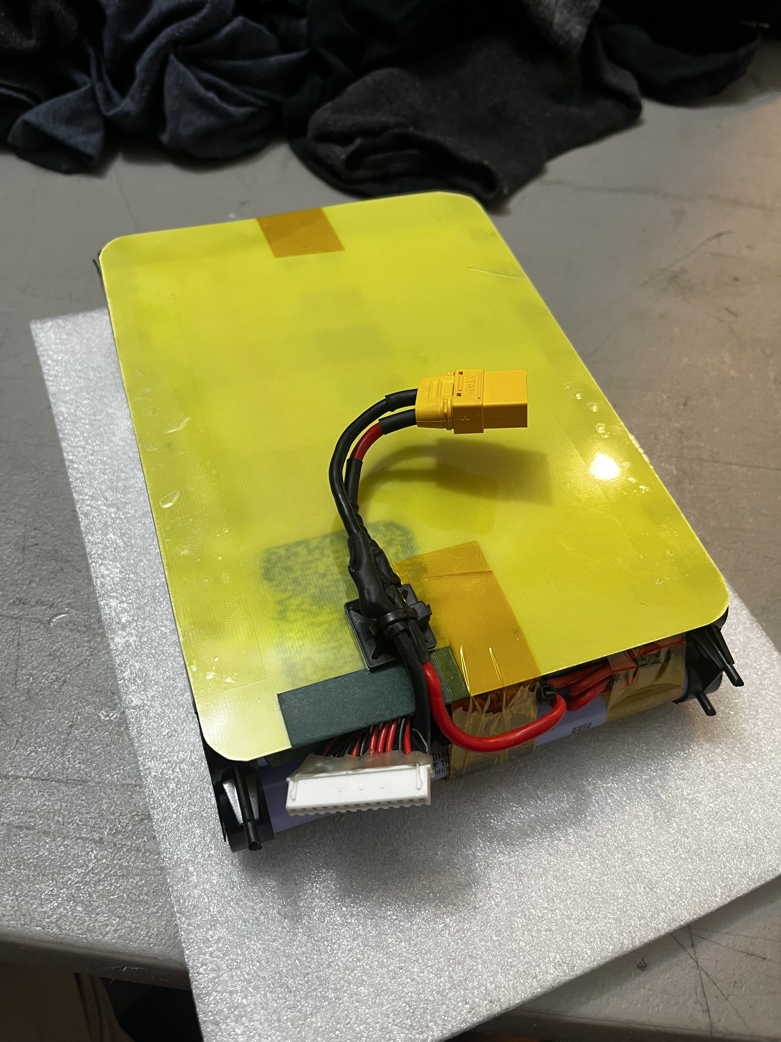

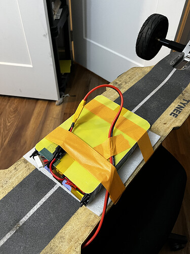

Battery
Left over from a previous project, it doesn’t have a BMS. I’ll just balance charge it with my hobby charger, good enough.
It gets some F4 plates for additional protection (I’m too lazy to print a proper case)
and gets masking taped onto the deck with utmost levels of care and precision
Finishing touch
Vesc programming was uneventful, got a relaxed 50/-30A motor config.
Thought I saw smoke, but think it was just dust coming out of the motors.

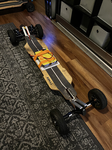

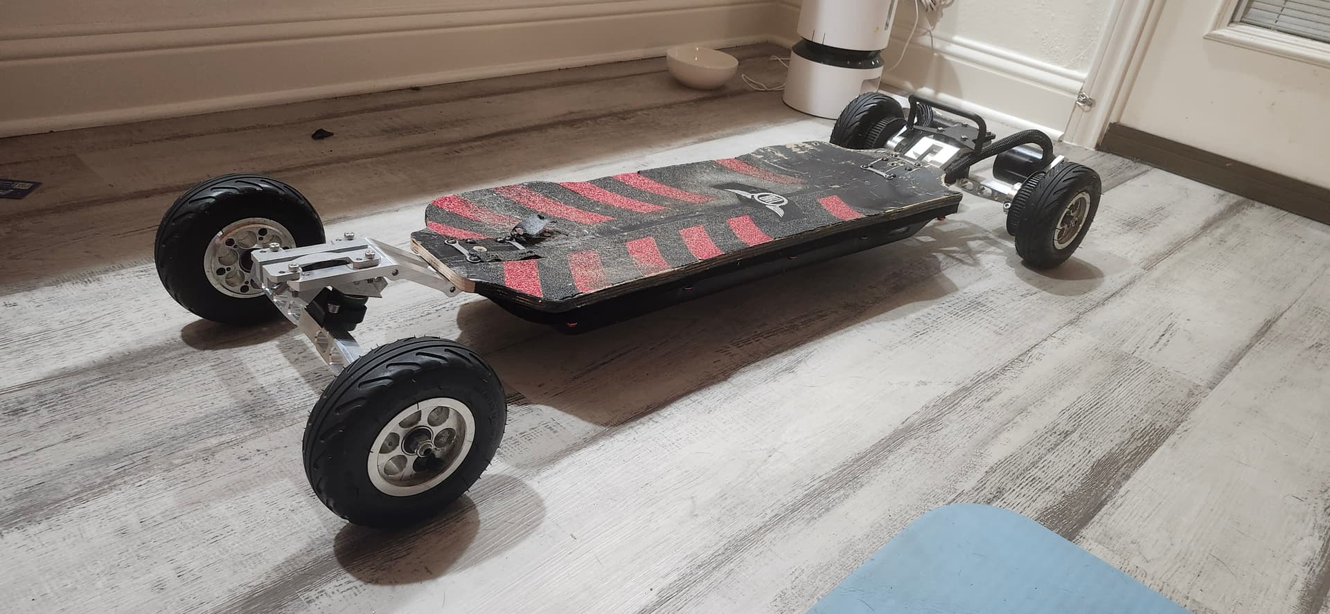

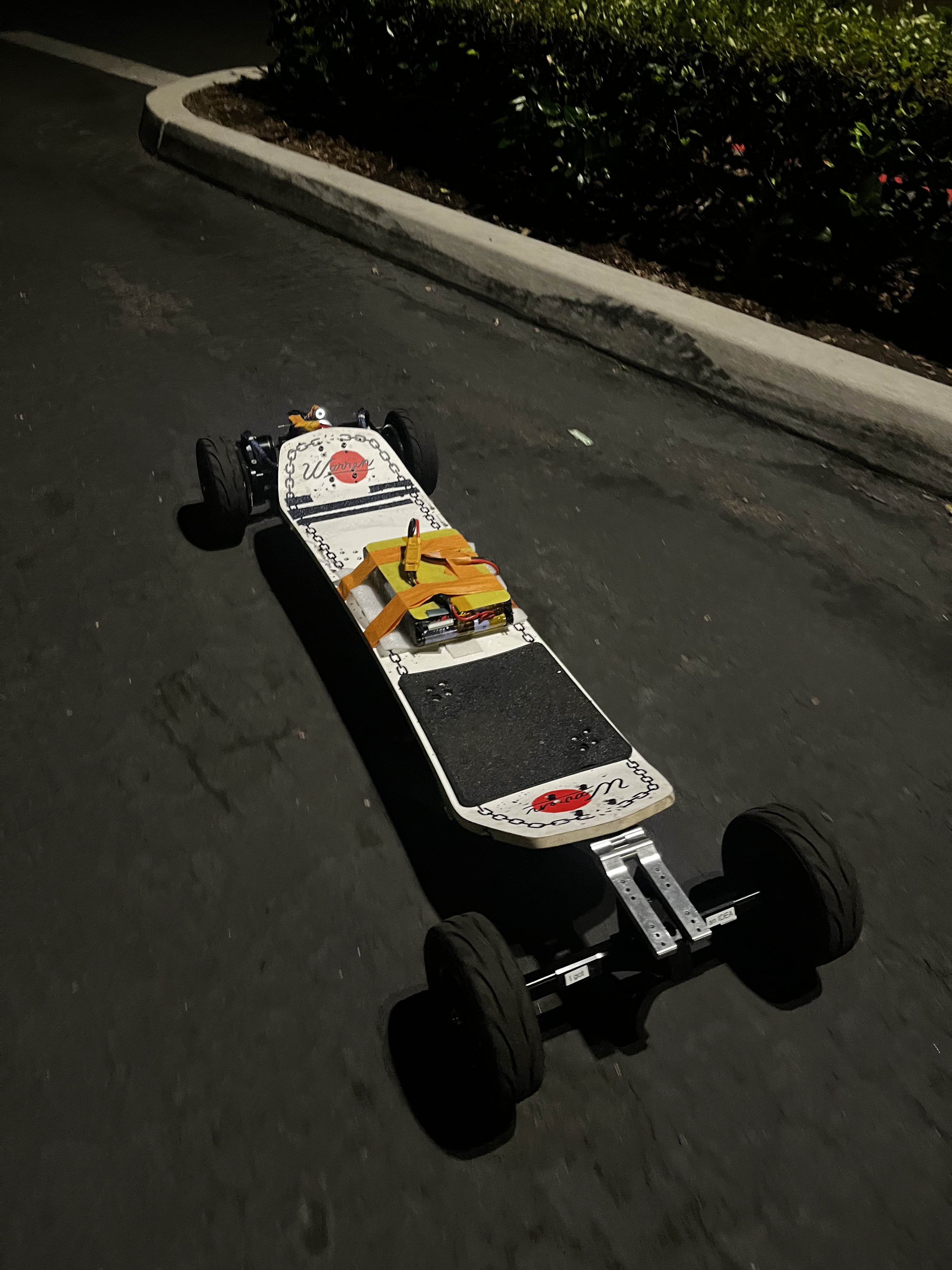

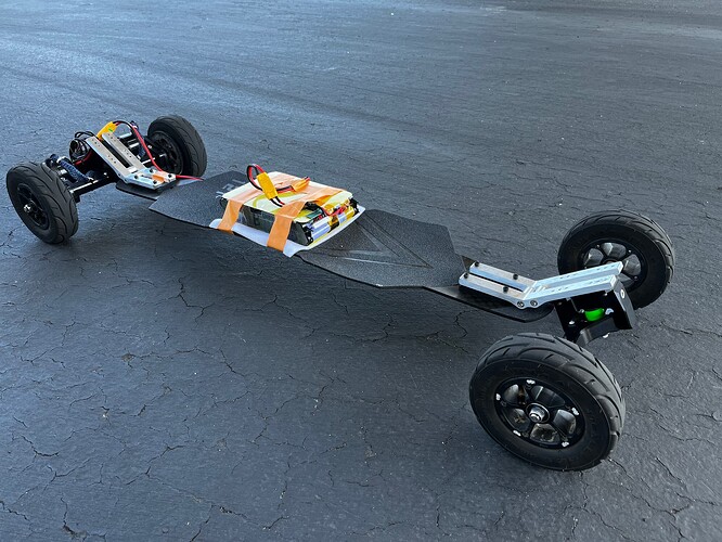

Deck #1: Tynee Explorer
As pictured, my spare deck from the origins of Tynee Curse
It’s a great deck, I hope it doesn’t break. But my hopes aren’t too high :rofl:
First proper ride in a few days. After that, I’ve got a long line of decks waiting to be tortured…

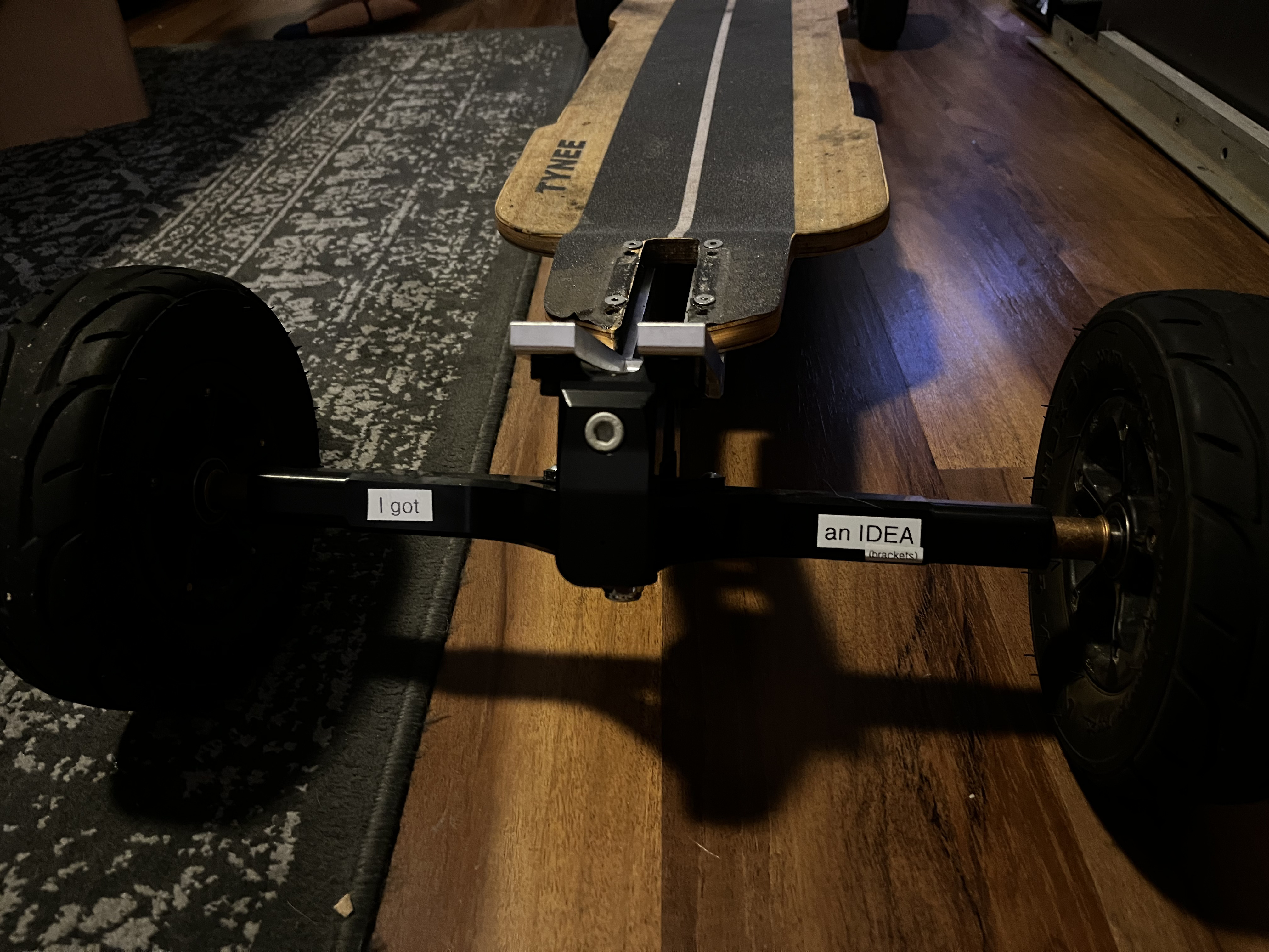

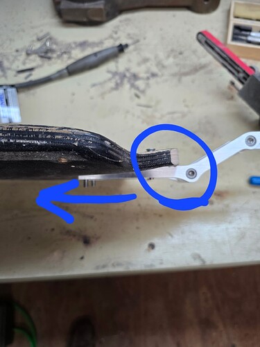

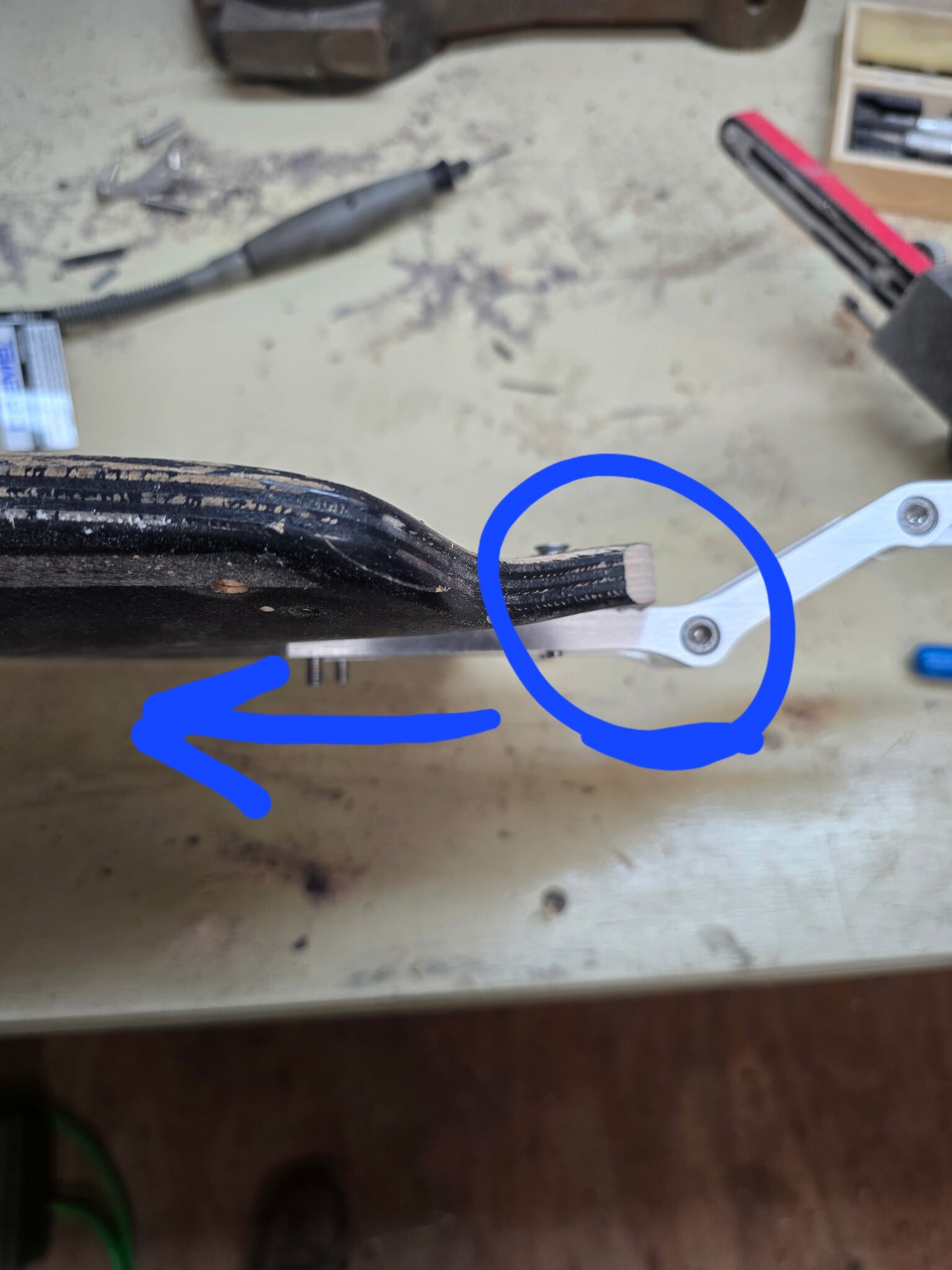

Ya, i thought about adding the brackets to the deck like that. But it was too long for my liking. So i chopped off the ends. Loved the way it turned out.

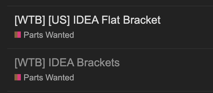

The thread you are looking for is here
they belonged to @DEEIF
carry on.

Damn that’s a nice job. I second cutting off the ends to keep it not too crazy, and/or using offset trucks. If you’re low enough you can use risers on different sides of the brackets to adjust wheelbase.
I
didn’t cut as much but my brackets curve back over the top.

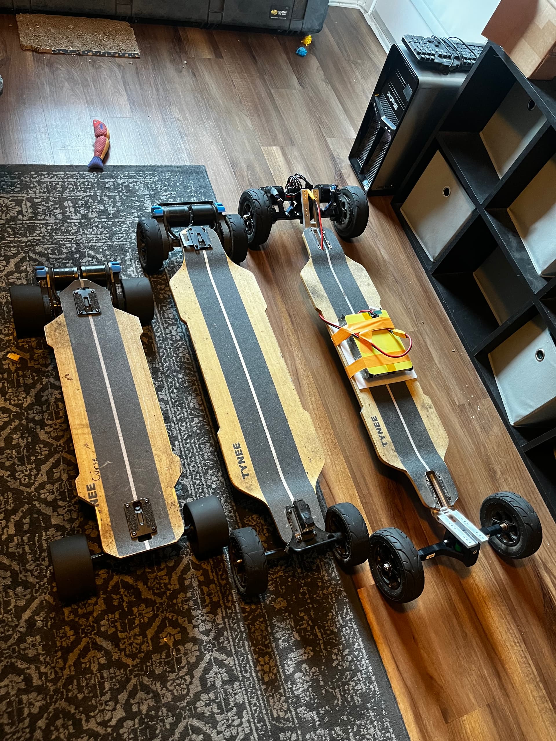

Your tiny tynee and massive tynee must look very funny side by side. I don’t know which I like more.
Didn’t even occur to me! what a funny idea
Tucker’s Home for Troubled Tynee
Dont talk to me or my Tynee sons ever again
It would be cool to have a full synthetic deck made to use brackets. Maybe one where a strong countersunk plate can be used on top of the deck
Yea we ended up cutting into the deck as well so the brackets fit flush into the deck too

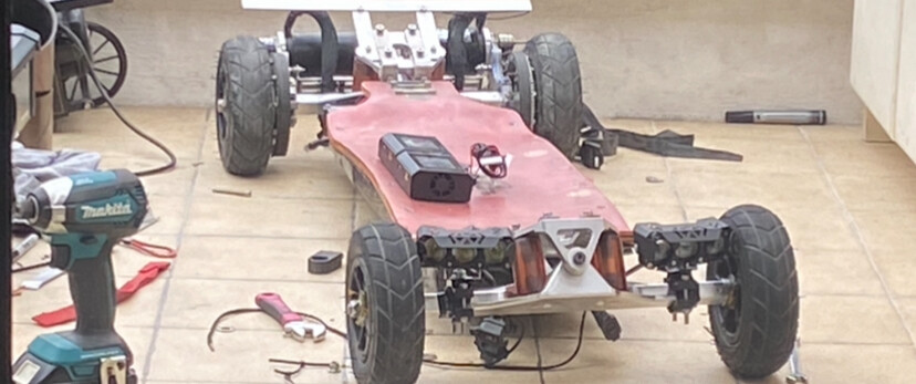

suddenly some other people also got an idea.
Interesting approach with esc attached to rear trucks like that. almost hot swapable?
Couple days of riding, actually not nearly as terrible as I thought! The best kind of result is a surprising one.
It is definitely underpowered (can’t power through corners), but that was expected.
Suprisingly, there was no deck scraping at any point.
Myself, riding at garage night (thanks @gtxd )
The ride is very chushy and smooth, likely because of the crazy amount of flex.
@R2trivv @Trivv3 taking a lap
Best part of the week is that the deck didn’t explode :grin:

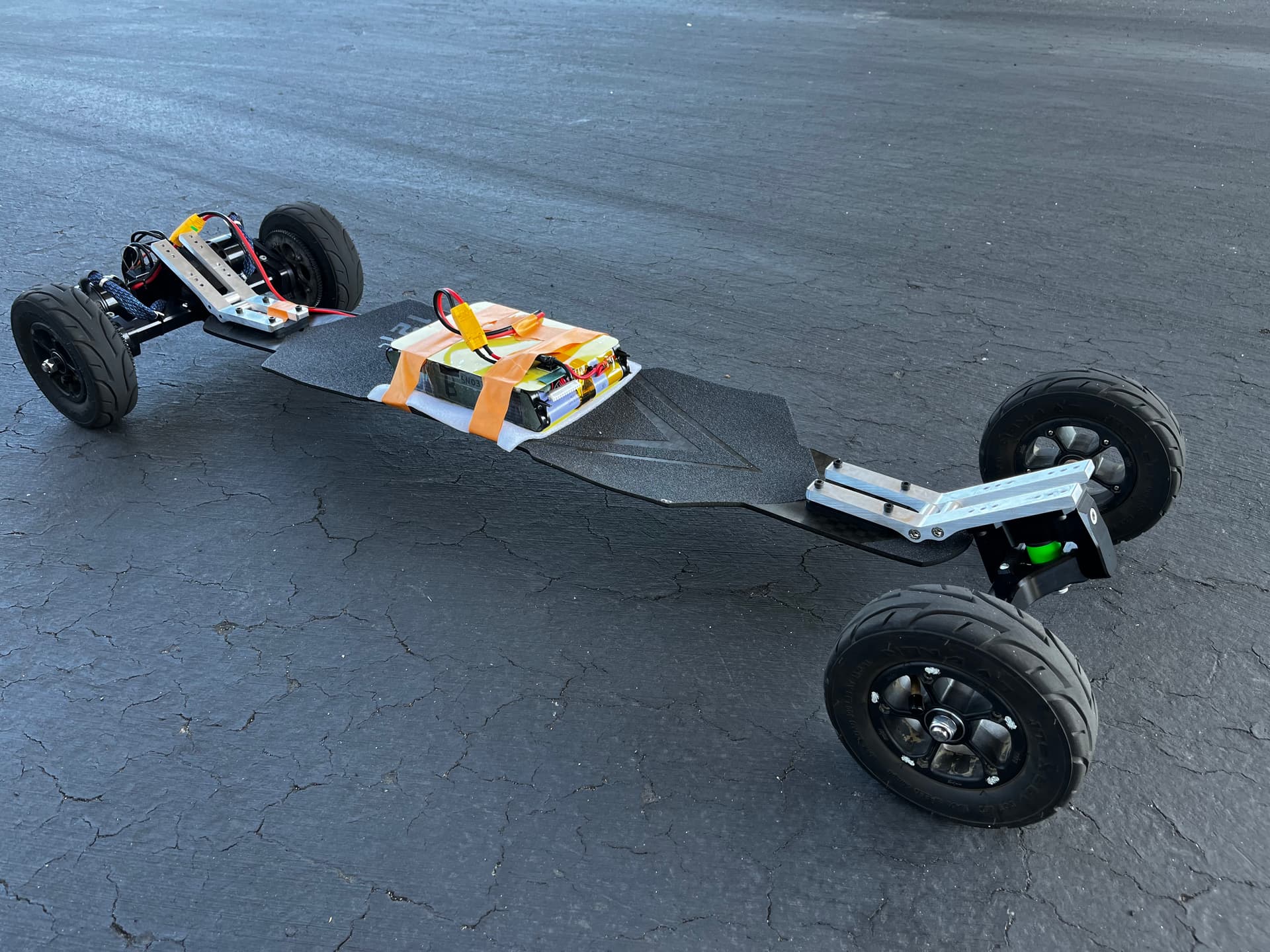

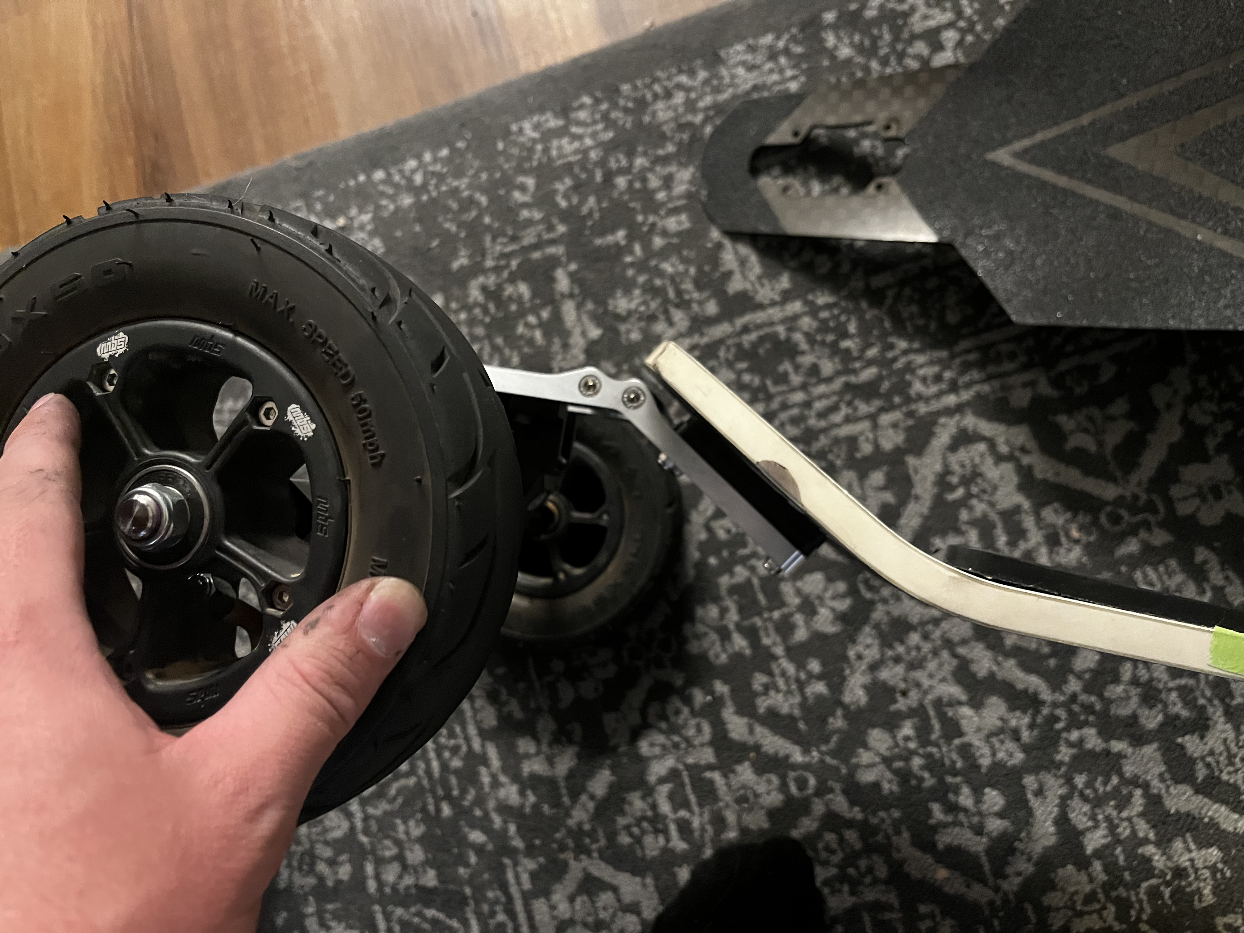

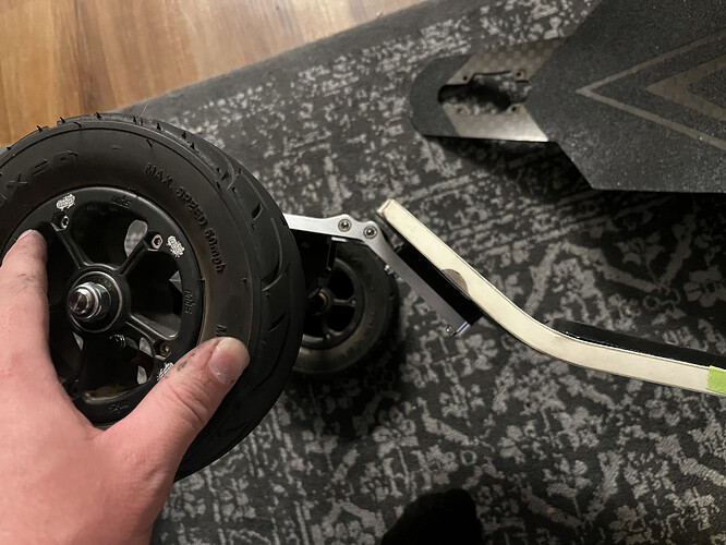

Deck 2
In only 10 minutes, I swapped over to the (stunningly pretty) afterburner 121c deck (won in BOTY 2023).
I had to top-mount the deck brackets with two big spacers (otherwise they’d clash with the deck, top or bottom mounted)
Worked out fine tho, it ends up having a similar standing platform and flex as the Tynee Explorer deck
Super fascinating results. I thought it felt worse, especially in the corners. It was very unhappy sustaining turns, wanting to twitch every which way. If you stopped paying attention, the thing would become a bouncing trampoline.

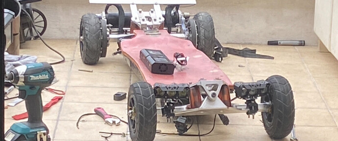

Deck 3
A MBS warren deck that @TZDKB gifted me a year or two ago (thanks dude!!)
Got a set of flatdeck brackets from @Titoxd1000 (am putting em to use here before they go on another WIP build)
Weird setup, but it works. tons of clearance for wheelbite.
Worked really well, actually. Didn’t get a video, unfortunately, but it’s the best feeling deck so far.

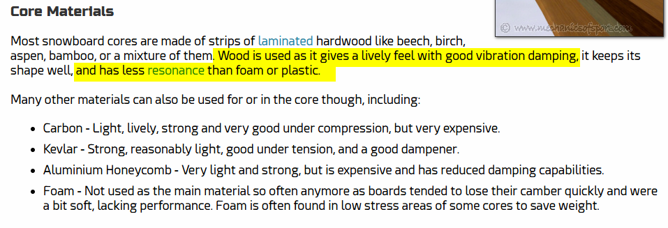

Deck materials tangent
According to this shop, the deck is a “Snowboard Composite Construction”.
Wanting to learn more, this led me to this interesting website about snowboard construction. Amongst other things, it mentions dampening.
Continued doing research, some snowboards also incorporate rubber into their stackup to reduce dampening

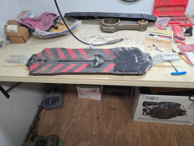

verrrrry interesting stuff.
Deck 4
My old Kaly ““Raceboard”” deck. Rare media of me racing 2022 AVS:
It has since been parted out into other projects, primarily since I really didn’t like the deck after it destroyed my feet at CarvePDX 2023
It has been revived. Test rides at i2g tmr, time to destroy my toes again.
