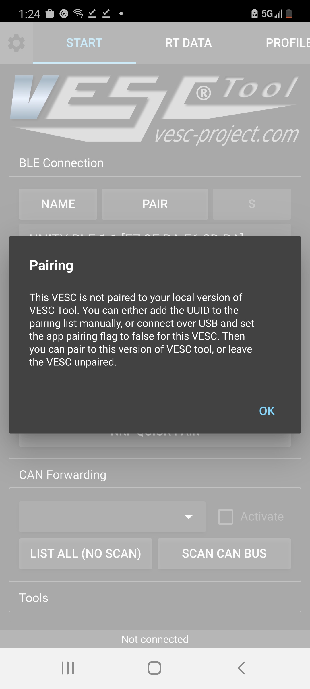

Have the newest vesc version running on a unity. New METR pro unity model installed. I haven’t found anything yet but assuming we still don’t have a motor temp reading fix?
Turn off unity then turn on unity. ā€œScanā€ > ā€œPairā€ or ā€œScanā€ > ā€œConnectā€ > ā€œPairā€ does not work?
Nope, it won’t let you pair that way once you delete the paired vescs
Strange, because that is how you can do it with Trampa VESCs.
(Also unpaired and re-paired different VESCs like this recently.)
It says there’s nothing connected and when you try to connect it just says you have to add the uuid manually or use the USB then immediately disconnects you.
Can you show that screenshot without the message pop-up?
Seems like you are connected to the Unity. What happens if you hit ā€œpairā€?
Edit: Try to delete all previously connected VESCs in paired list. After that, try to pair the current VESC/Unity.
Deleting VESCs in the paired list is what causes this problem, I think. I would not do that, or at least save the UUIDs before you do.
Recently, I could not connect new MK IV VESCs to the VESC app to run motor detection.
I deleted all previously paired VESCs from a MTB. After that I could pair the MK IV. I supect @Chase problem could be similar if he has previously paired VESCs saved in the app.
Edit: I am not sure if this is a bug in the app.
This happened because I deleted all vescs in pairing list. It warned me but I was being stupid on the fly and did it. As soon as the pop-up message goes away it automatically disconnected you so when you hit pair it doesn’t work. Whatever the case be, I plugged it into the USB and fixed it.
