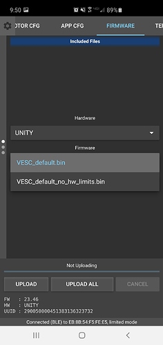

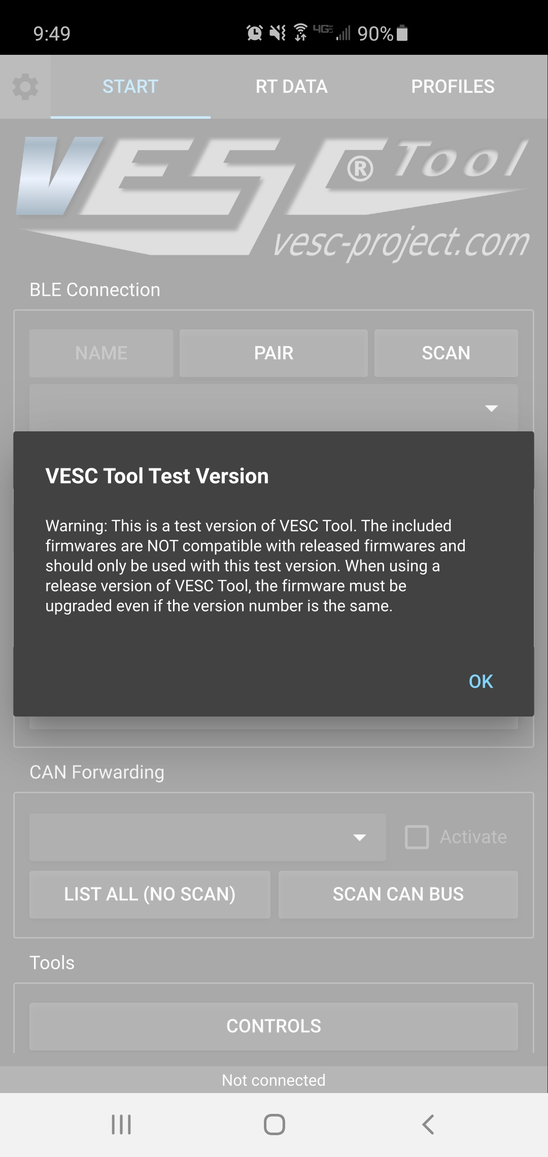

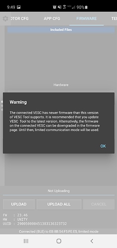

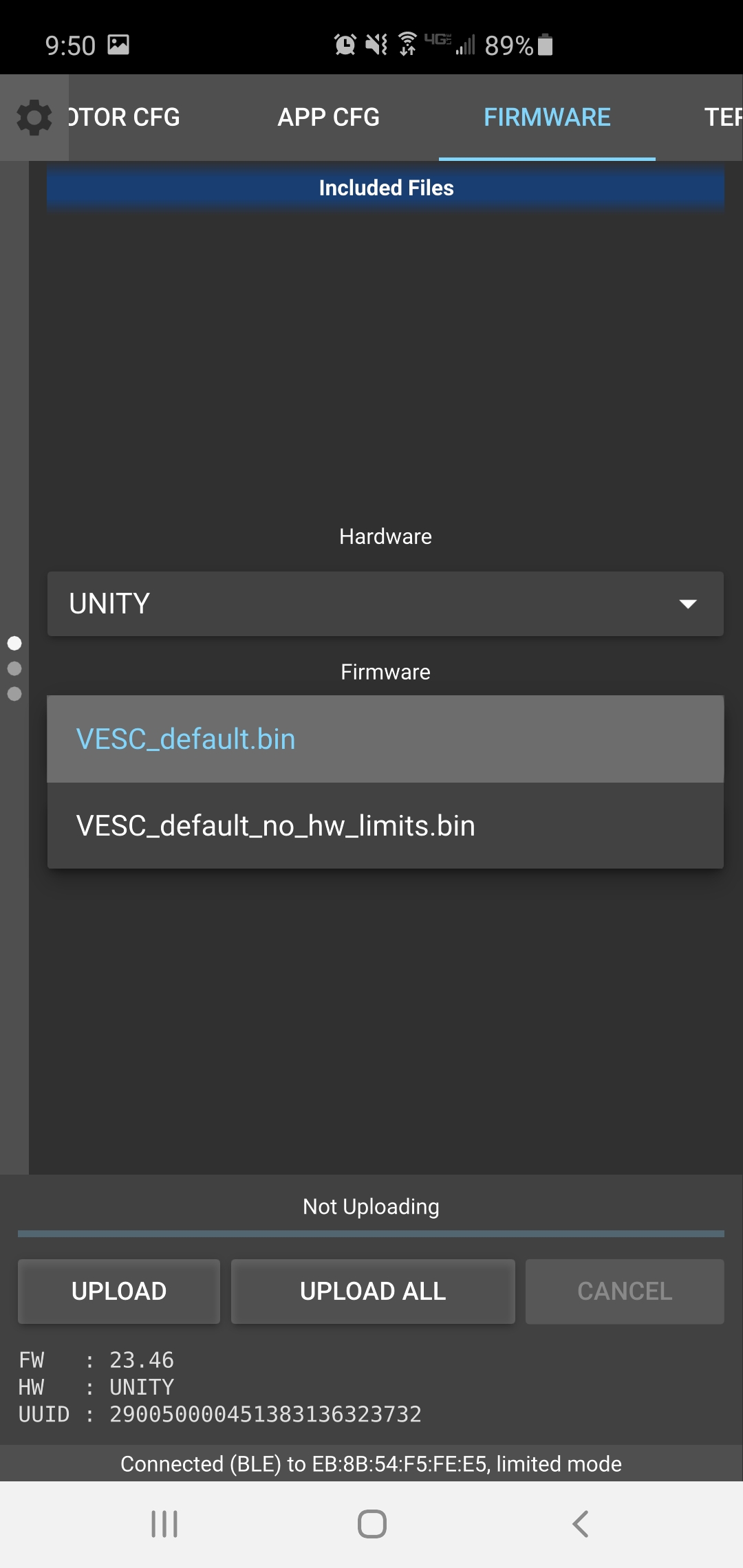

Thinking of trying out fw5 again on my unity with another build to see if I have the same issues…
Is there a new version of vesc tool or is this just because it’s still being tested?
Is this just mad because it’s unity FW or because of above?
Which unity FW is recommended @trampa?
