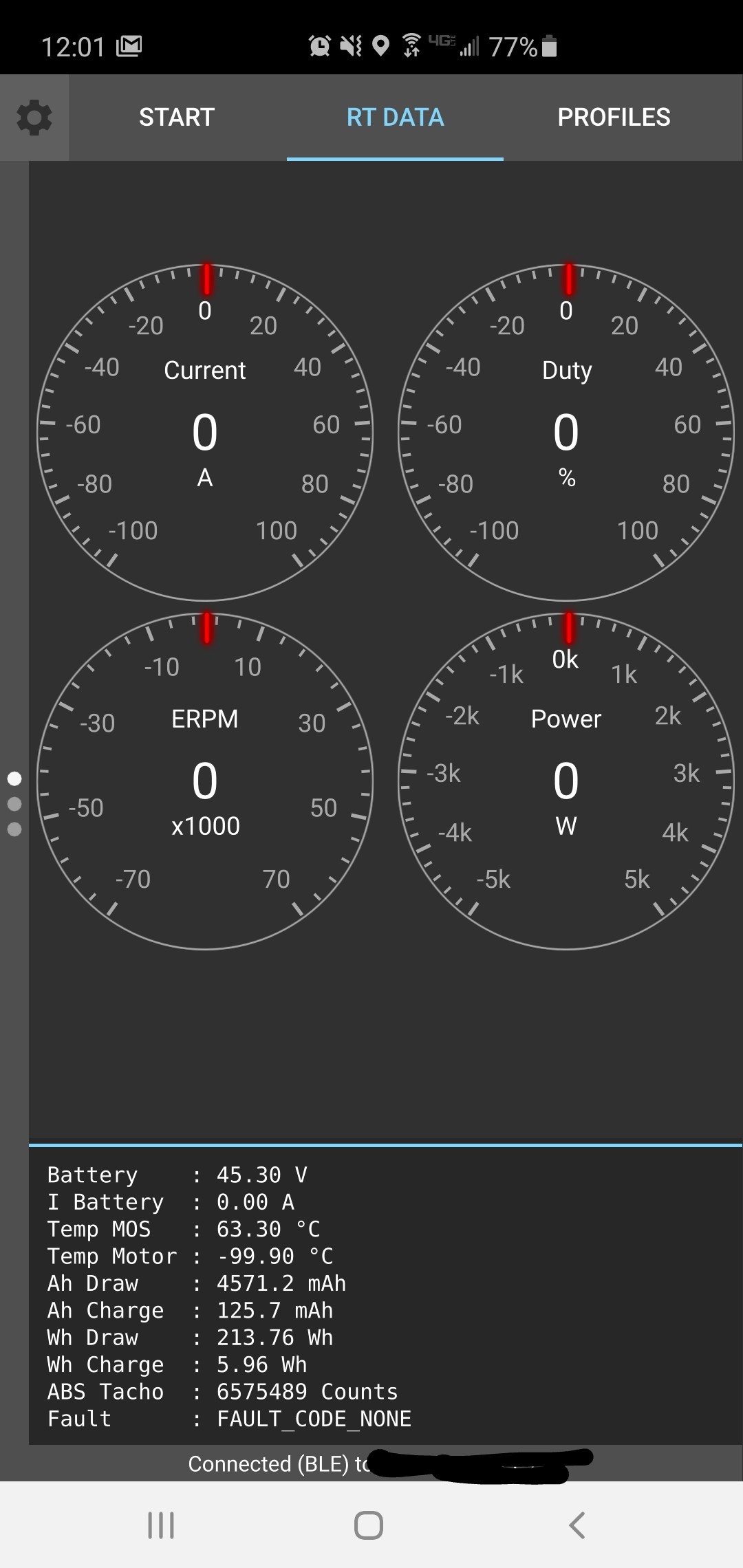

Alright went very well for the most part. Still getting -99° motor temps though
I recall this being an issue a while back. Is it still?
This happened to me. The versions on the website didn’t work. When I went to the play store and updated the app and then used the app to install fw, it fixed it
Rubbish temp data means no temp sensor usually?
Yeah but they’re sensored and temps were picked up fine previously by the unitys FW. I remember a few ppl saying the same thing. We’ll see if they chime in.
5.1 UNITY fw has no motor temp. Neither foc_openloop, I use it for discharging battery in metr app. Those 2 reasons why I stay on 23.46
Any clue why this is? Seems like a silly thing not to have when the capability looks to be there
Bug. I think it was fixed long time ago, but 5.2 has never arrived.
Don’t know how my issue was fixed then. I just went through this and when I reinstalled fw through the updated app it fixed the issue.
