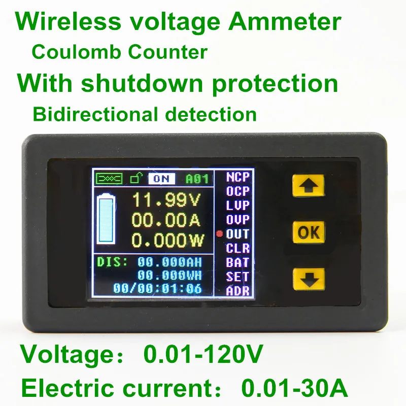

If you print an enclosure that houses a ruideng psu and something like this
It’s a reall nice setup. You can see total watthours charged, time duration. Some meters forget the total wh when shut down but others accumulate and need to be manually cleared (not sure which I like better).
Most of the meters are slightly off and cannot be calibrated. The reading will be off anyway because of the resistance of the charge leads (unless you do a 4wire setup)
But, I put some kind of power meter inline when I charge, every time.
Another thing I do is put a wall socket timer switch inline, so no matter what, charging shuts down at the appointed interval.
Some photos
DPH5005 with VAC1030 (remembers WH total when shutdown, not able to calibrate)
This guy is set up for XLR charging. I like it a lot but no calibration, and the WH reset button is recessed
This guy is tiny! 3 digits precision (only some models have this, and it’s dammed hard to find) but it’s not that accurate. No calibration. Because it’s tiny it’s always facing the same way. This one would be better in a small enclosure with hardmounted DC barrel jacks like @b642 does with pack voltmeters. Remebers WH.
This one I put in a big ole enclosure. Forgets WH, which is nicer sometimes, but if you have AC power on a timer and the meter powered off the AC side and not the battery side, you won’t see how many WH went in.
Oh all the meters can power off the DC feed, but most can also be powered with an independent DC source, so you don’t drain the battery pack when charging is complete.
