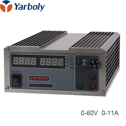

I know you have a portable application here but I find lab PSUs even more handy than the meanwells. Some of the switchmode lab PSU are not quite so expensive, small and light. But so much more useful for all kinds of troubleshoot for eskate.
Something like this (careful to get the 110v version):
There’s a 6017 (17A!) model but it’s $$$ and very hard to find the 110v version.
