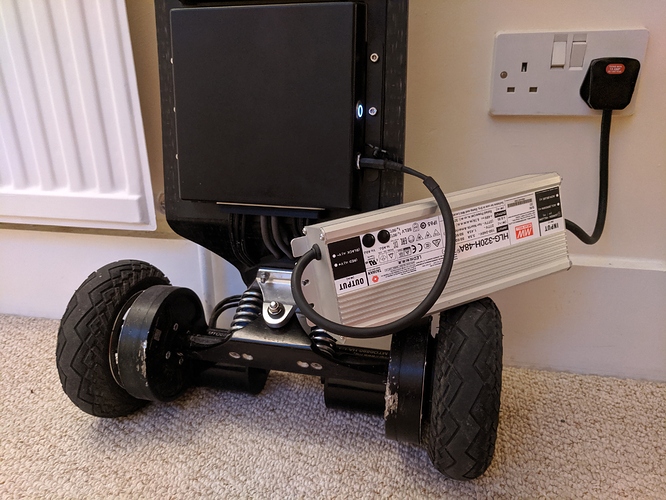

My meanwell HLG-320H-48A charger . . .
It arrived last week so i put some plugs on and here are my findings:
PROS:
  • Build quality is great. feel like this thing will take a beating on road trips without any ill effects.
  • Seems to provide slightly above the advertised CC adjustment range.
  • Seems to run only slightly warm even when turned up to the max.
  • Fan-less design and IP65 mean it should be resilient to getting damp or wet.
CONS:
  • Its fairly heavy.
  • The cables it comes with are quite short. As you can see i cant quite put it on the floor whilst charging. I tried to open it and see if i could replace the cables with something longer but it looks like its sealed with some sort of spadge. I think the only option would be to splice longer cables on externally or risk ruining the seal.
