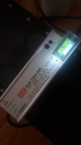

I’ve bought a few watt meter from Amazon. They’re not very accurate. Got a link of a good one or do I not need one since I have a smart BMS?
It’s great to have the meter wired in regardless for many reasons. For safety at least. The wattsup one doesn’t break.
https://www.amazon.com/RC-Electronics-Inc-Watts-Analyzer/dp/B001B6N2WK

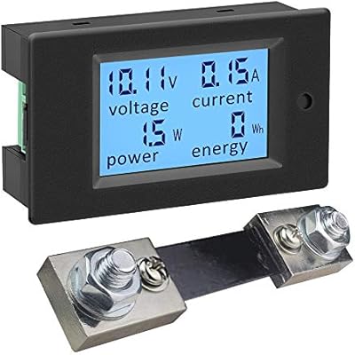

Hey guys
Do any of you know this meter?
Is it any good?
I am thinking of buying it to put him in my led driver output to be able to monitor it

That one is too big for what I want
I want to have a all in one charger that I can take every were so I was looking for a small meter to attach to my HLG-320H-48A
I have a LLT smart BMS on the way so can control the charging with him
I just need a good and precise meter that isn’t too expensive

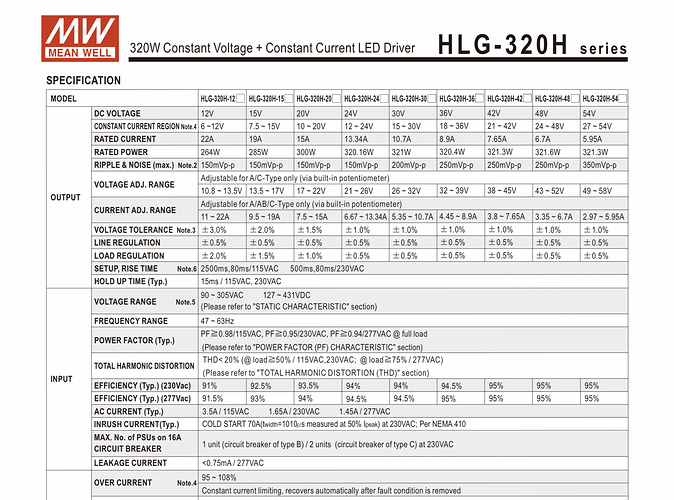

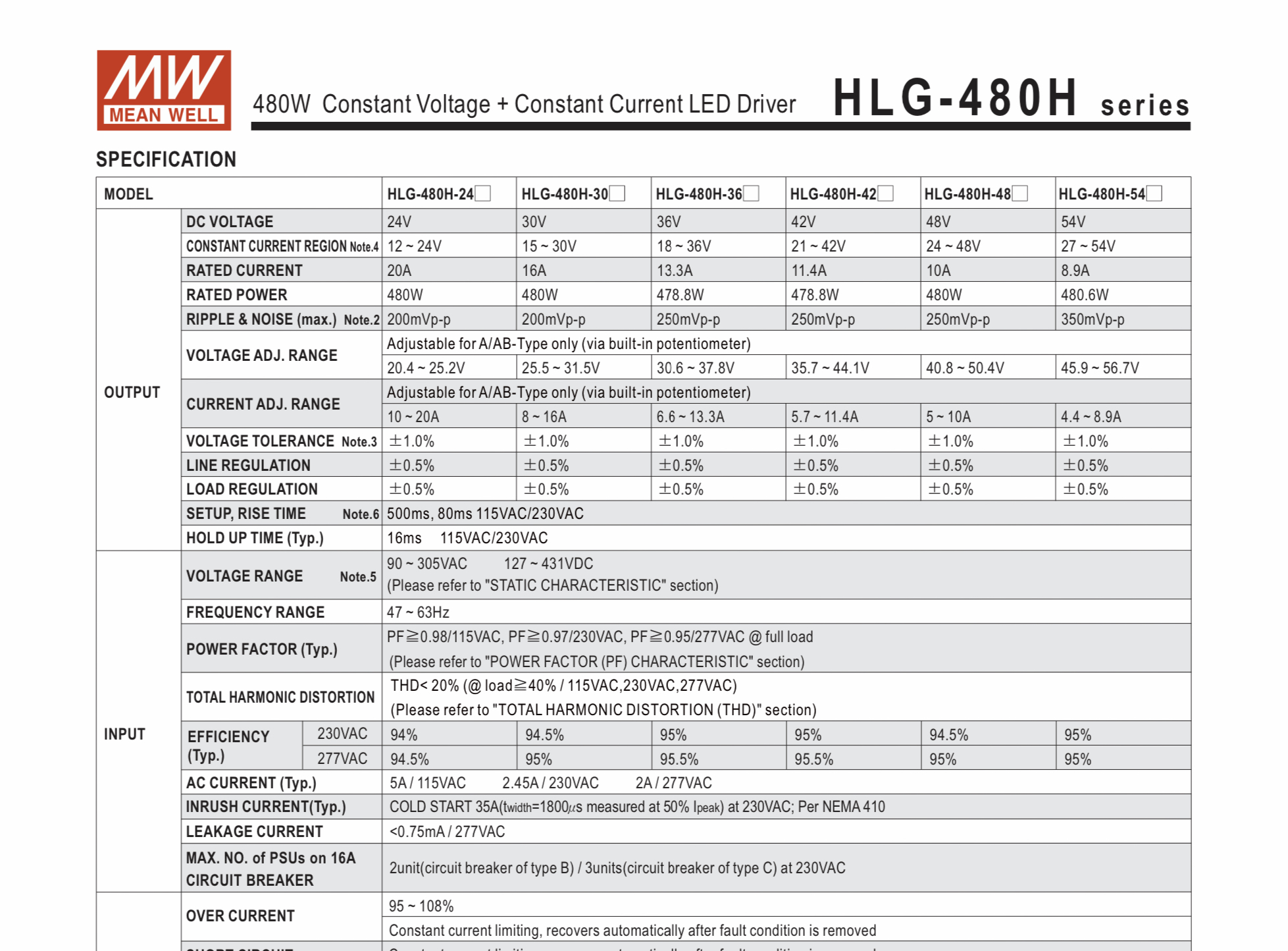

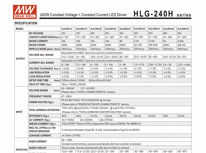

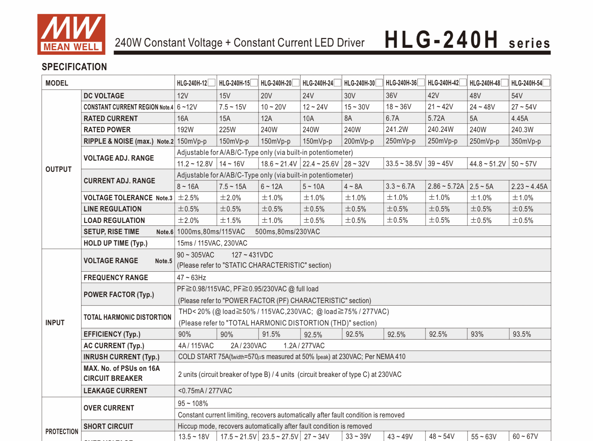

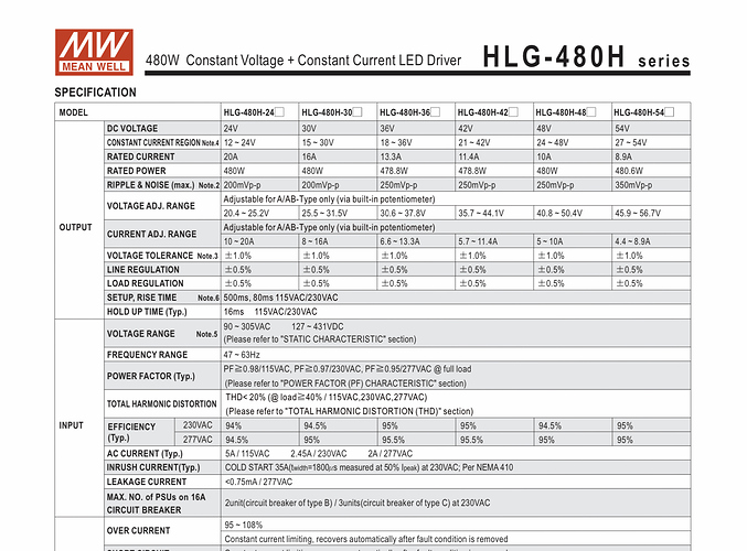

Was back looking at the spec for the Mean Well HLG
I just noticed the Ripple Noise up between the 42V/48V and the 54V By 100mV 40% is a large increase. considering the low ripple noise is one of the reasons these are seen as good quality I’m surprised by the jump.
Voltage range is not consistent acros the range
240W 48V 44.8V-51.2V. 54V 50V-57V
320W 48V 43V-52V. 54V 49V-58V
480W 48V 40.8V-50.4V. 54V 45.9-56.7V
600W 48V 43V-52V. 54V 49V-58V
The 240W 54V and 480W 48V are a little to close to the pot limit for me

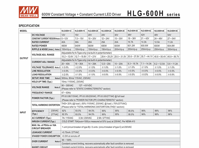

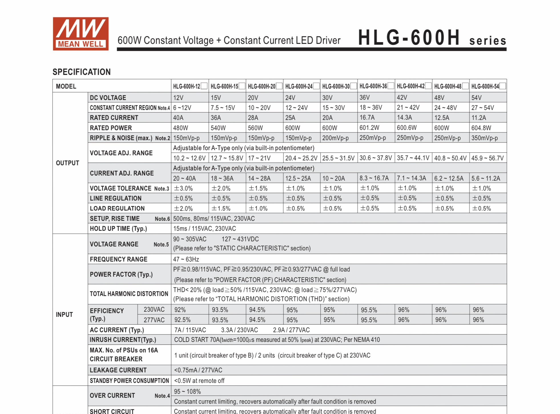

After a bit of reading, I’m planning to buy a Meanwell HLG-600H-54A but have a few questions:
  1. Do you think it’s ok to just use a multimeter to set the voltage correctly or do you think it’s better to wire a meter to properly check everything all the time?
  2. Any new meter recommendations besides the ones shown above?
  3. If you adjust the voltage/current, is it safe to assume that it will stay in those values even if you throw it in a bag a few times?
Not an issue.
After you throw it in a bag a few times, you’ll get frustrated with how heavy it is and just leave it at home :sweat_smile:
