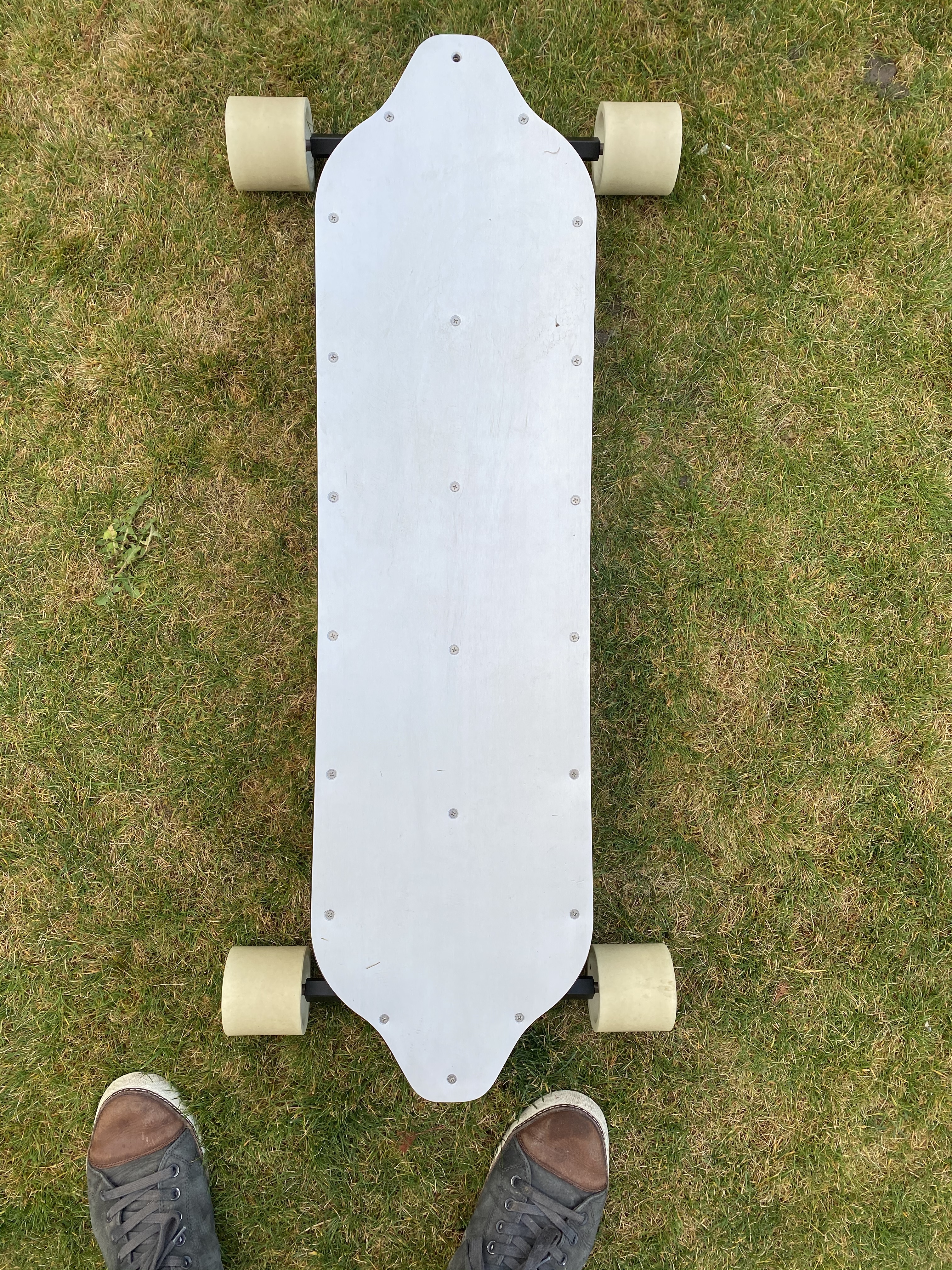

Does this count as close? If I get TB110s it’ll truly be an ultraboard, Senor Pepes are the biggest 'thanes I got
where are those hummie deck, hummie hubs sleek builds?
Surely qualifies. Low and slow and with 110’s upside down is possible.
Its so ugly its almost pretty.
Is that a Trampa Orrsom?
It is indeed.
What’s the specs? How does it ride?
I have had that thing running 12s4p30q and gear drives with numies and it was good but not quite right. I have had a 30t same spec battery in there and that was the same. Good but something was off. Its now running a 10s430q with tkp and thane and its perfect. Its a thane deck. Lovely comfortable cruiser. The flat deck surface with numies I found to be a bit of a lesson in concentration because you always have to be fully aware of where your feet are or you can easily foot bite the wheels. I will chuck some 110’s on there when I get the funds and then take it back up to 12s but for now it suits the power to weight perfectly. Its indestructible. Literally. You could rail slide the enclosure. You do need a flexi pack in it though. I put a raptor pack in it and nearly burnt it to a crisp. Spot welded series connections are not your friend in a flexi deck and its very flexi.
On the whole its a great combo if you use it in the right way. I would ask for the enclosure to be sent blank if I was to order another because trampa cuts all these xt90 holes all over the enclosure which is kind of a pain.
If you want a slidy thane deck then theres not much more you could want from this deck/enclosure combo.
TBH didn’t expect that, it looks built like a tank, but given how flexi the HolyPro is, it shouldn’t have surprised me.
