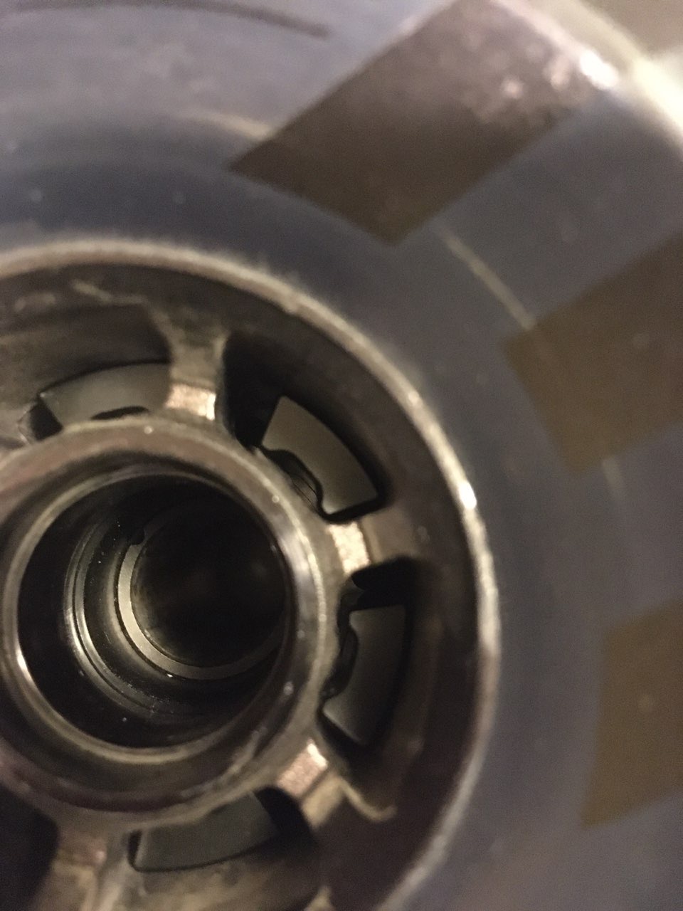

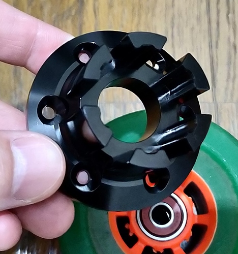

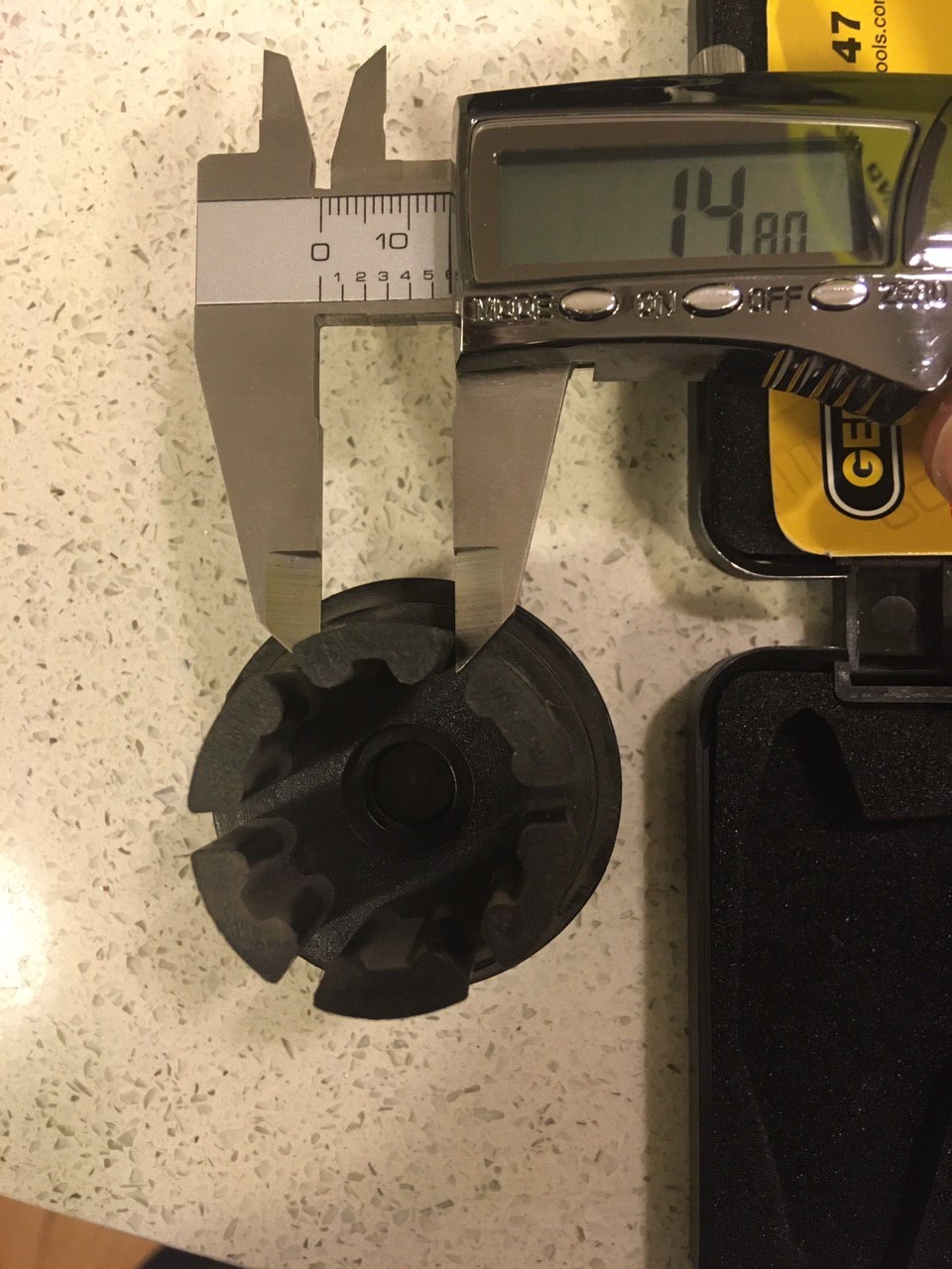

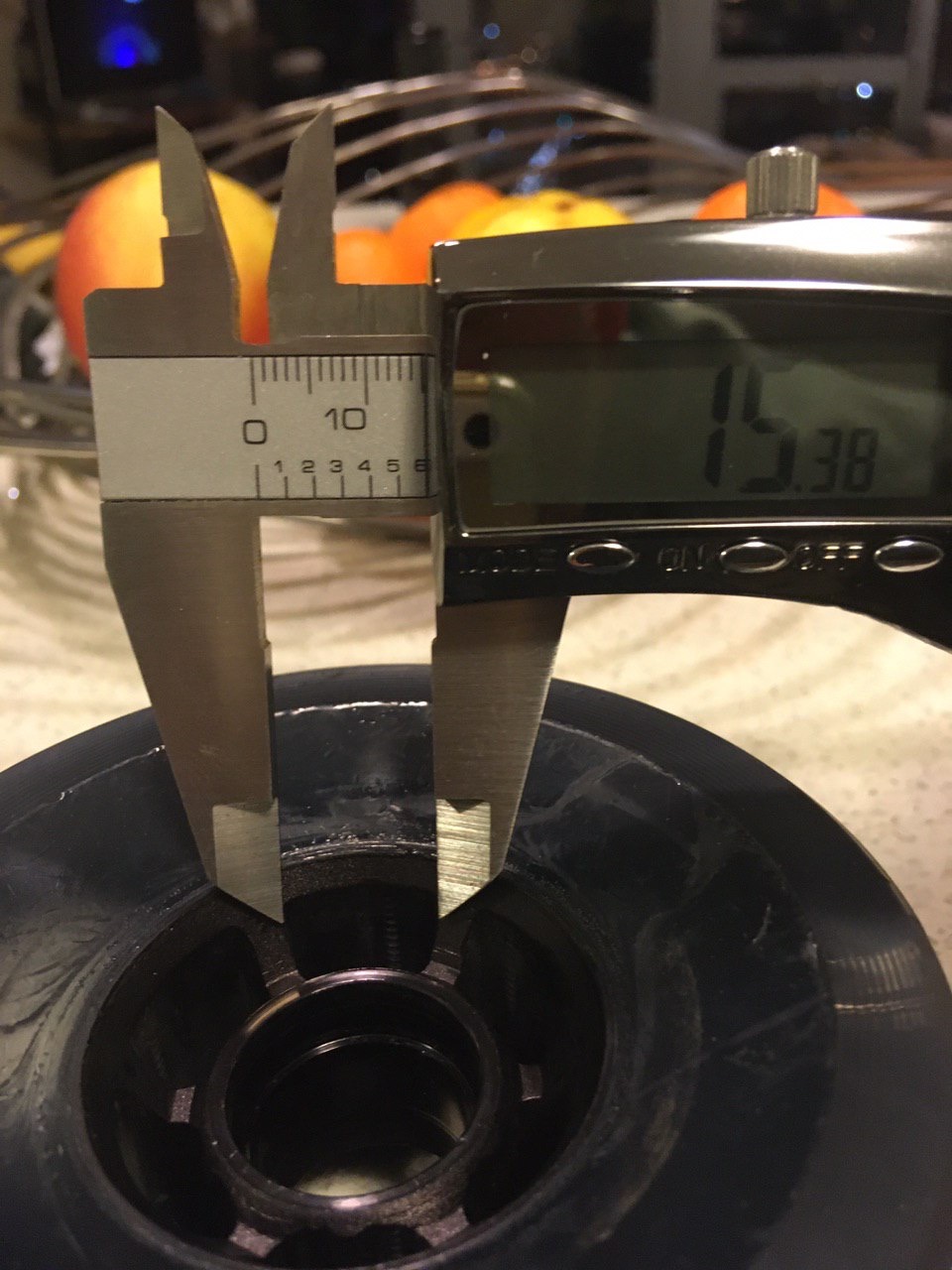

Buddy of mine has this problem where the adaptor is not the same size as the core abec pattered. Anyone else experience this?
Me too.

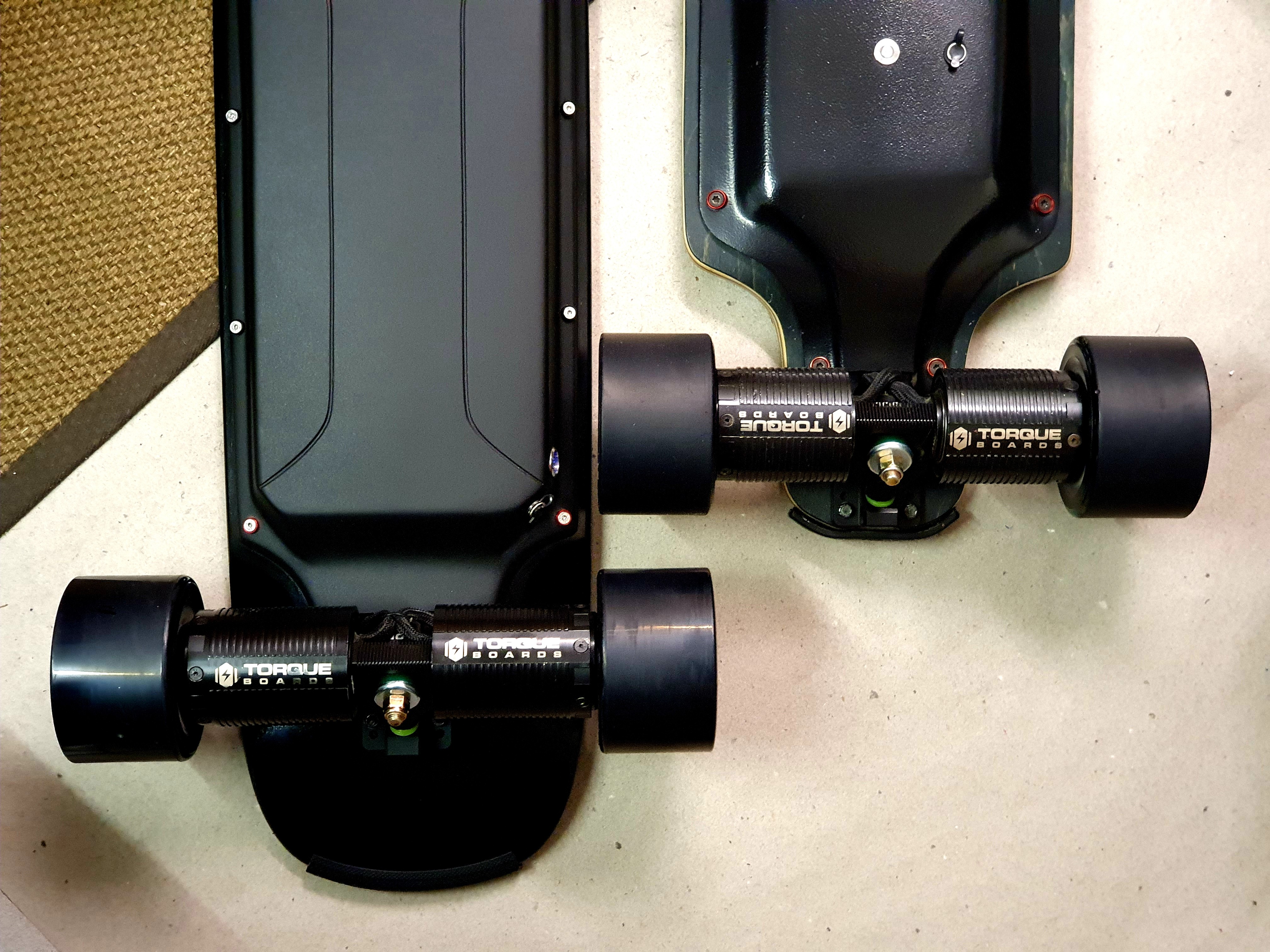

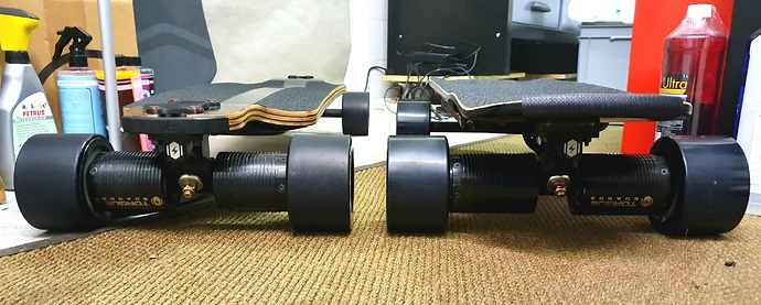

Standard TBDD vs. XL TBDD
new variant?
Yeah I’m gonna need some context for these and some details on the TorqueBox.
Same here. @McErono Enlight us !!
These big ones are a one off according to Dexter. The smaller ones are first batch versions without temp sensors and C-clip on the inner side of the big bearing.
They feel similar in strength but the big ones stay cooler I guess.
So the Standard were the 6355 vs the XL 6374 (which TB DD owners have) ?
I thought TB were about to release 6396 60KV, that would have been epic :wink: and scary for my wallet…
afaik my standard ones are the 6374, 6355 were prototypes only. the XL is bigger than 6374.
I chose 75kv for the big ones. I don‘t think Dexter has plans to sell them offically.
