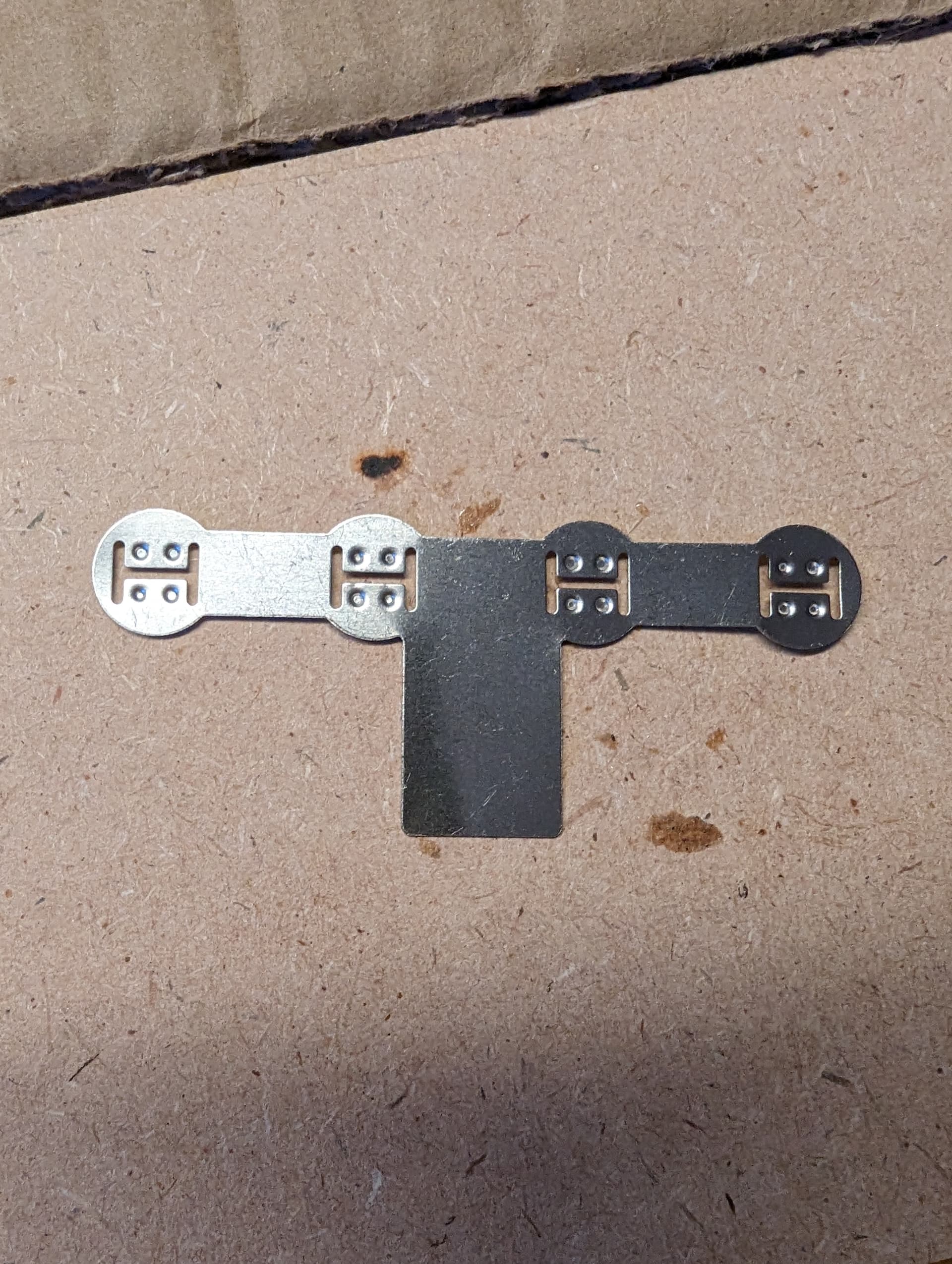

So a while back I got this kit:

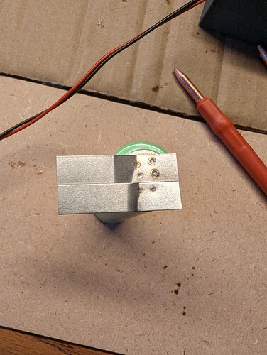

I know it might have its limitations and what not but since I have never built a pack or spot welded before I thought it would make a nice first project. So during the weekend I started to assemble things, got the spot welder (maelectrics.eu) running etc. Did a few tests on dead cells with some 0.2mm nickel strips from nkon.nl. All good. Strong welds at 20 ms. Happy times. Did some pull of tests and those tore holes in the nickel. (The electrodes tends to get a bit stuck to the nickel though, suggestions?)
So I start to assemble the real deal. The kit has exactly 20 nickel strips (yes, the exact amount I need, should have predicted what happens next).
I get a few good welds to begin with but things get more and more problematic.Eventually I realize that this nickel is actually 0.3mm. Anyhow… for reasons I can not explain I get holes torn where one of the electrodes are (top is one weld, and bottom is another, ignore the one at the edge…). I get this also at ~20 ms weld time, the same weld time that got me nice welds on the battery above with 0.2mm nickel. The nickel have passed 24 hours in salt water.
It’s now all a mess. I can not get the provided nickel strips to weld properly and even if I figure out I’m an idiot and did something wrong I only have 17/20 left.
So now the question is
What am I doing wrong with the provided nickel strips? Or are they simply too thick?
I would like to still use the PCB, could I do something like this with 0.2mm x 10mm nickel (preferably with one wider strip rather than 2)?
Other suggestions?

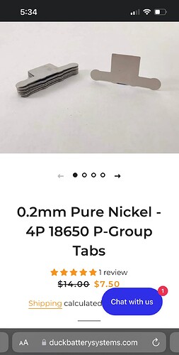

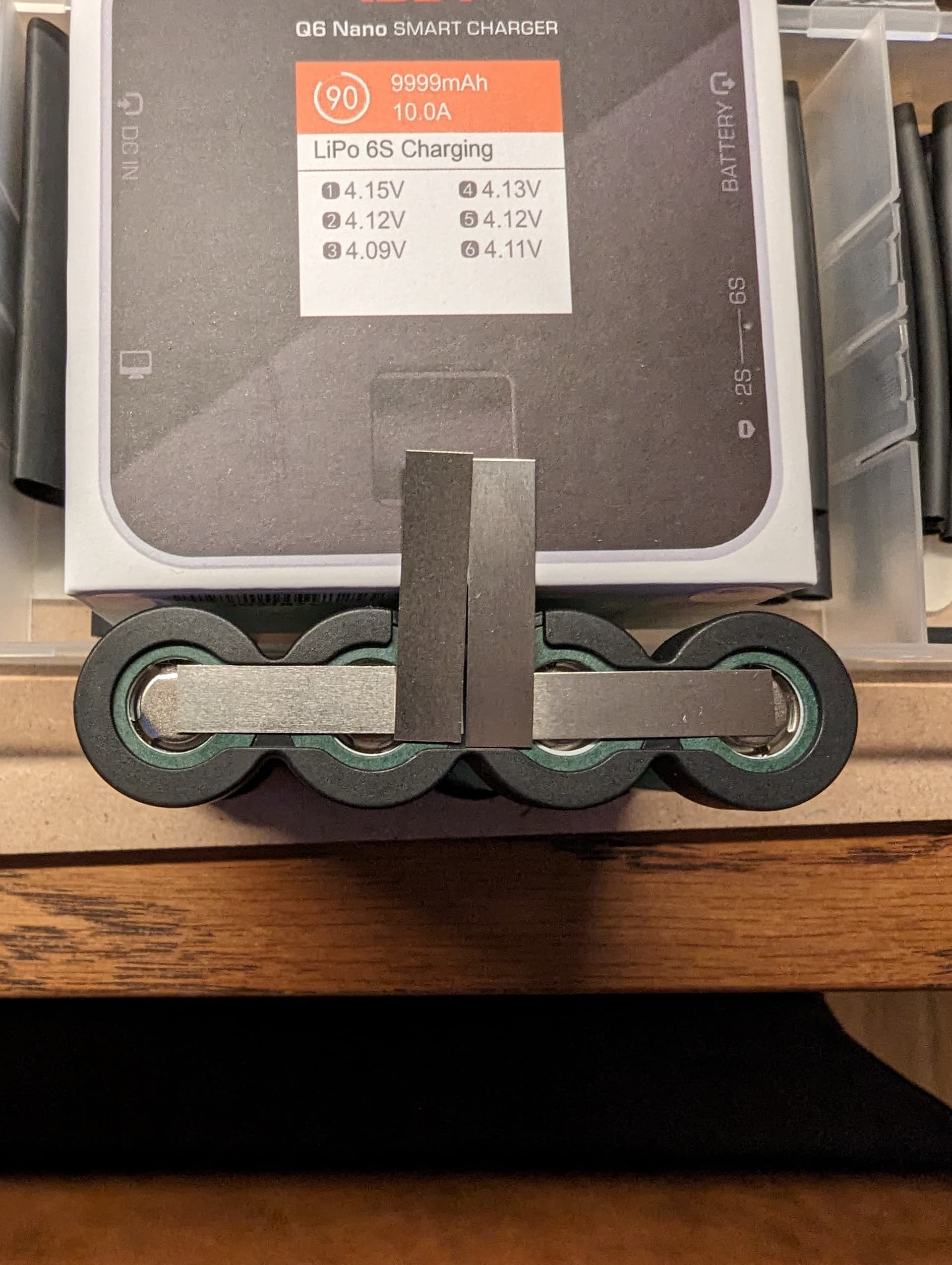

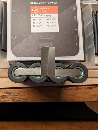

It is very hard to get good welds with 0.3mm nickel. I would recommend getting some more strips that are 0.2. I’m not sure where in Europe sells them but I’d just recommend getting new pre-cut pieces. I have provided a picture example.
I would also recommend getting some 30mmx.0.2mm nickel and folding it over in a way similar to the kit that you got. I’m pretty sure there are a few EU suppliers.

You would just have to cut the notches to the size of the holes in the pcb. You might not even have to cut notches at all. I would just be sure to round the corners but this can be done with common scissors.
Rouding the corners for the sake of my fingers not getting sliced in half or theres other reasons? Thanks for replying, I think the 30mm nickel is a better idea than any idea I managed to figure out during the day. Seems to be available at nkon.nl as well. If anyone has more suggestions I’m all ears!
That, it looks nicer, and you don’t want a bunch of nickel sticking out at the bottom of the cells once you weld. If you accidentally get anything in there, stuff will be less likely to make contact if the nickel does not stick out beyond the profile of the cell.
They are thicker, which definitely makes a big difference.
They’re also slit and dimpled, both of which are designed to make them easier to weld, but you need to know how to take advantage of those features.
You really need to be able to practice and tune your welding settings for the exact nickel you’re using, and it’s unfortunate that they didn’t send any spares to practice with.
With dimpled and slit nickel strips, you want your electrodes to be pointed enough to fit into the dimples and touch the bottom, and you want to straddle the slit. One electrode on each side, so the weld current is forced to go down, through the nickel, into the cell, across, and back up, rather than just across through the nickel without going down into the cell.
This current path helps get a good solid weld with less power on thicker nickel.
