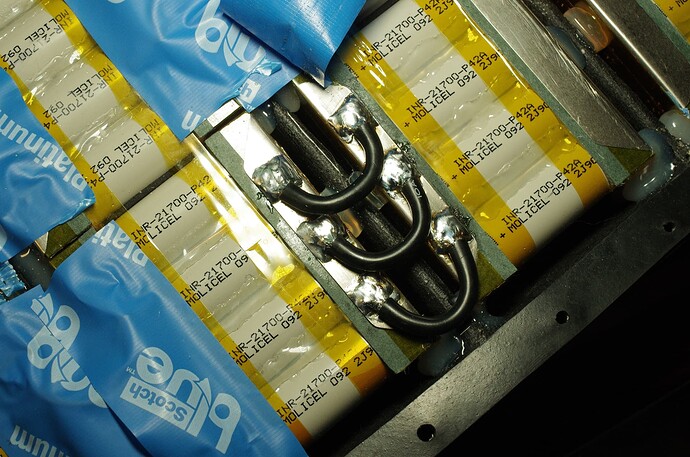

Just finished up my first brick pack. I didn’t have access to a spot welder (the one here at my school’s EE lab broke) so I used resistor legs as cell-level fuses, moving really quickly to heat the cells as little as possible. Anecdotally, they didn’t get noticeably warmer than they had when I tried spot-welding earlier, and I actually some fuses blow during a test run (with a worse enclosure) after one of them broke due to mechanical stress. I know it’s not really in vogue on this forum anymore but I’m pretty convinced it’s a good technique if you don’t have a spot welder.

I mean it’s not great, but it’s slightly better than soldering a 12awg wire to each
It’s like, you wouldn’t be as mad stepping on a bunny poo, than stepping in a cow pie. yknow?
That aside, the rest looks cool
should have known I’d get roasted coming in this thread :sob:
still proud of it for my grand budget of $0
Hey - I said the rest looks cool
