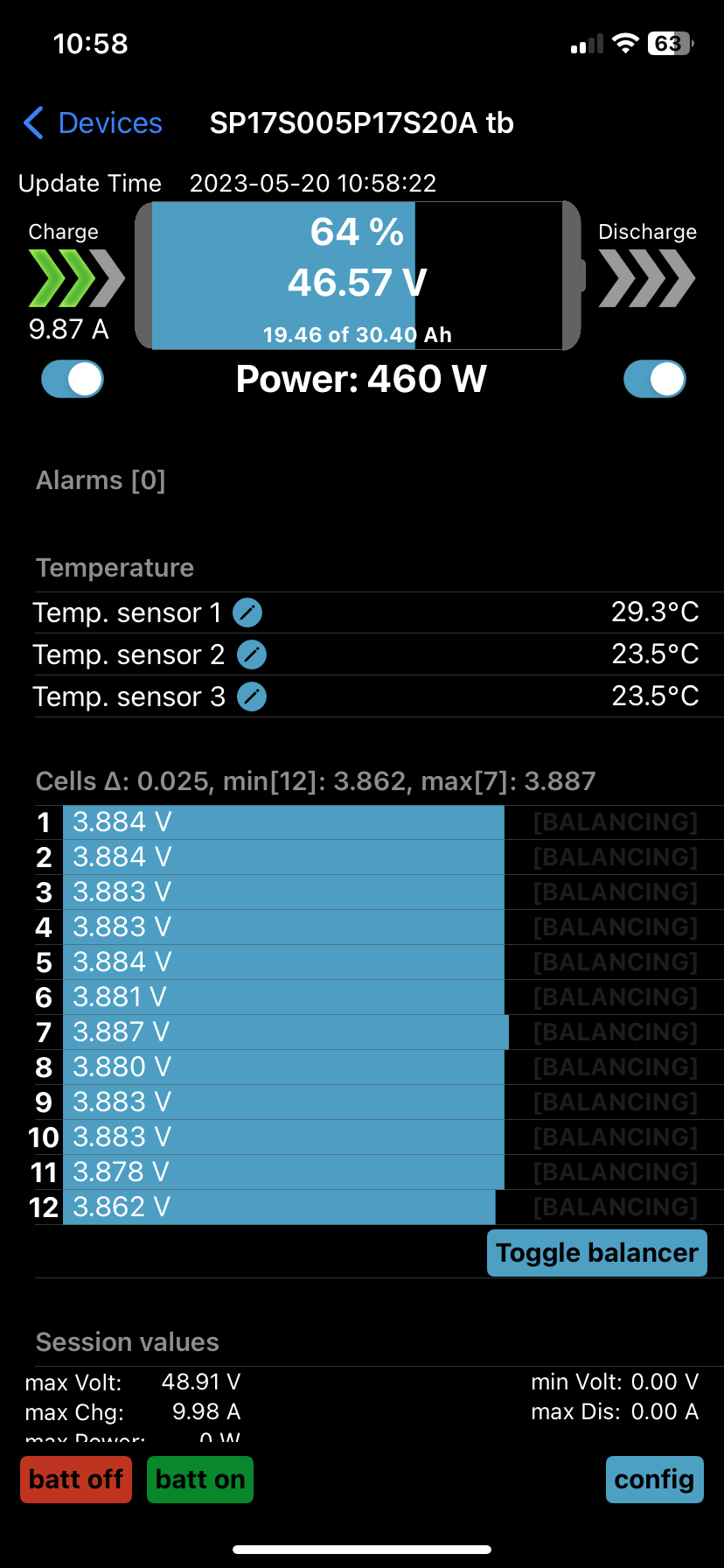

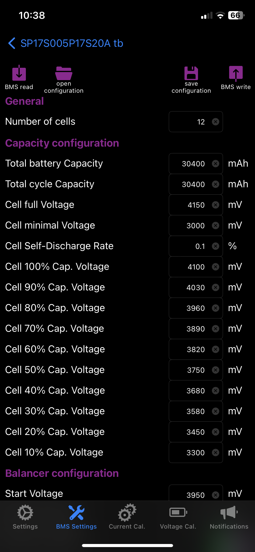

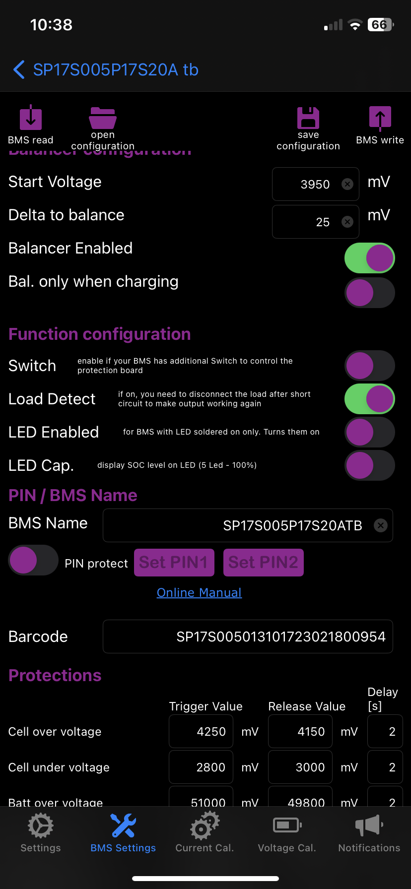

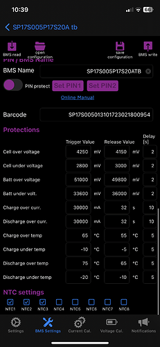

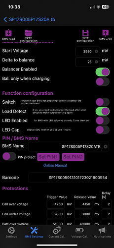

Board isn’t changing, anyone got an idea?
i get the above error when i try to change the status of the charge or output.
Edit: config on llt

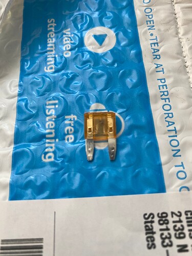

Never mind, inadequate fuse: proper rating fuse is in the mail

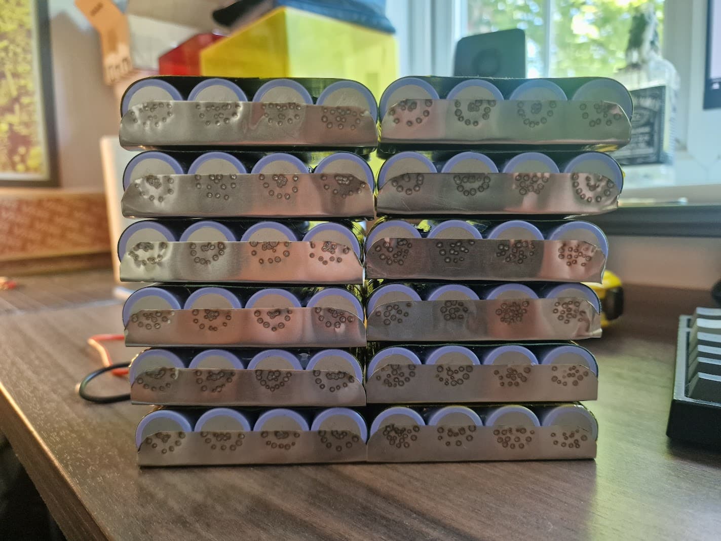

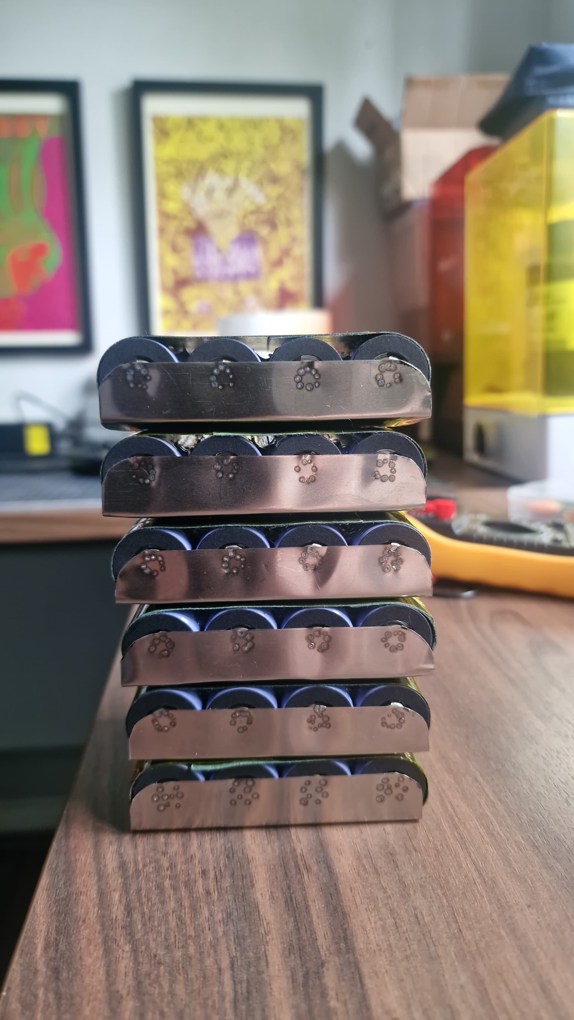

How are these looking?
You went a bit overboard on your neg terminals m8 lol. Also, you want to stay away from spot welding in the middle of the neg terminals. There’s an internal weld in the cell that can be damaged if you weld on top of it.
I’m assuming you’ve dialed in your current for the welder and the nickel has passed the pull test on a spare cell?
Crap, I just did the second lot and I had one electrode near the centre, the other near the edge and went radially 6-8 welds per cell. Voltages are all clear though, I guess time will tell if I’ve caused any internal damage.
Yep and yep, pretty confident that these will hold

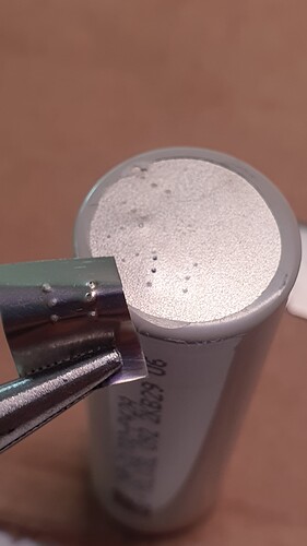

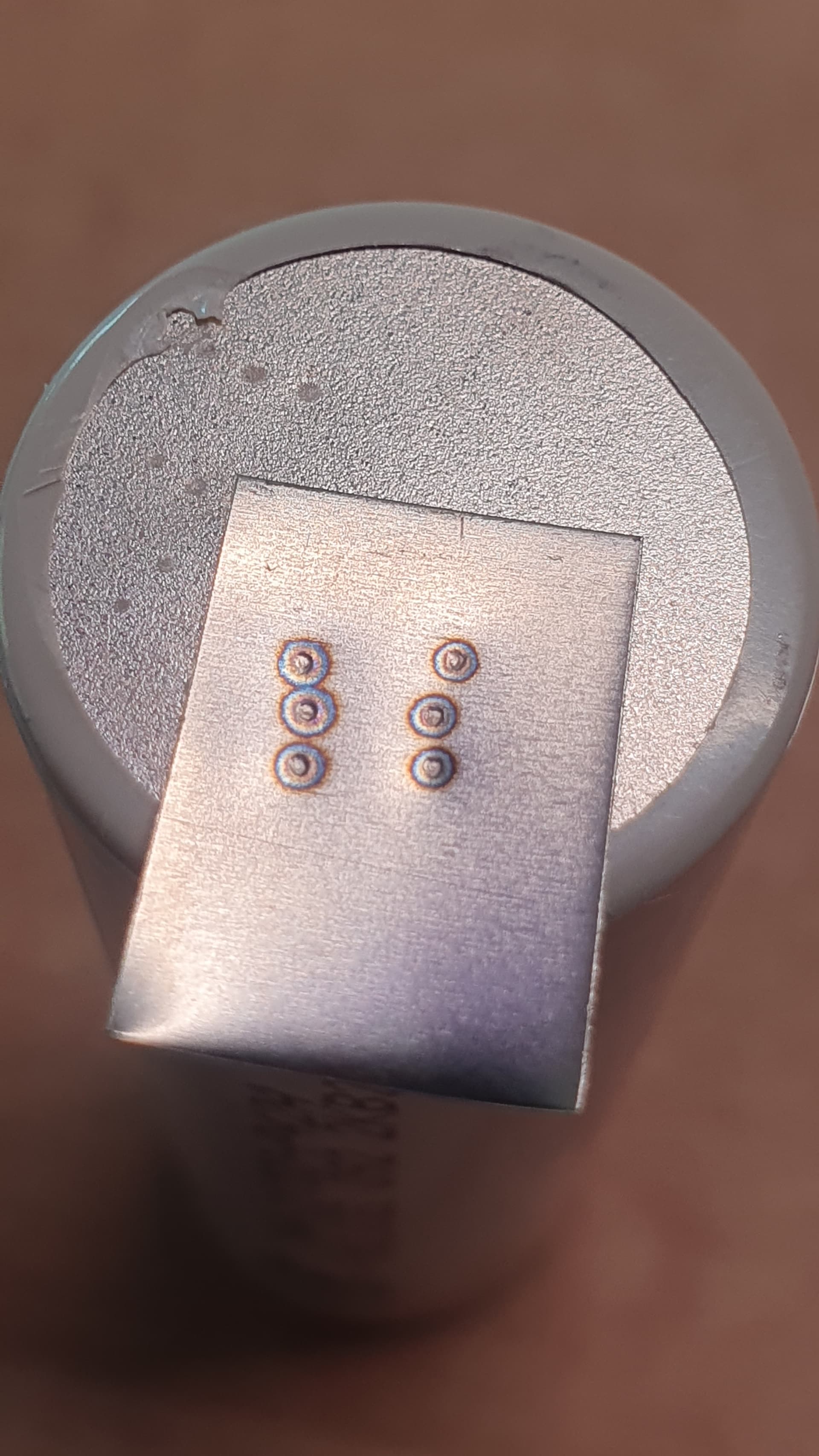

So ive done some more testing with a single battery, but im not happy with the consistency of the welds. I tried a bunch on the knife again and after on a spare cell. Sometimes a weld rips when I pry it off (which is good) but sometimes it doesnt rip and its a lot easier to get off. Im already at 40 or 50ms on the weld pulse and reading most posts it should be around 30ms. So I think I will order another battery to get some more amps.
Welds are supposed to get off with prying. Or at least they are solid enough, if you need to pry on them. That’s why you only do a pull test when testing. These welds should not transfer any loads, that’s the holder or glue for.
Thanks @Linesflag you prompted me to do some more research on spotwelding and found out I dont need much pressure on the probes. So now im just putting a small pressure on the probes and im getting better welds that also tear off when ripping the nickel off. Gues this should be sufficient but I will do some more testing to be sure.
Getting this with 35ms
Ideally you get little spikes of nickel left on the cell, try holding the probes a little closer together (I go for a 1mm to 2mm air gap between the electrodes with them 30deg from vertical) when welding, and stay clear of the center ~6mm diameter circle of the negative terminal
These look a little cold for my taste, but this also depends on how thick your nickel is. On thicker stuff you won’t get any tearouts without reaallly cranking up the heat. That being said, if you glue your cells together, they are fine. Professional welds look no different.
