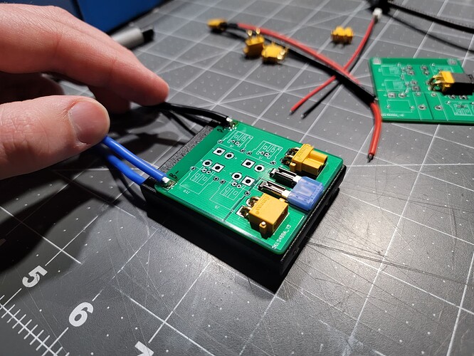

Ok so this is before i pot it but here is my fused charging port and buck converter splitter:

  • Looks ok

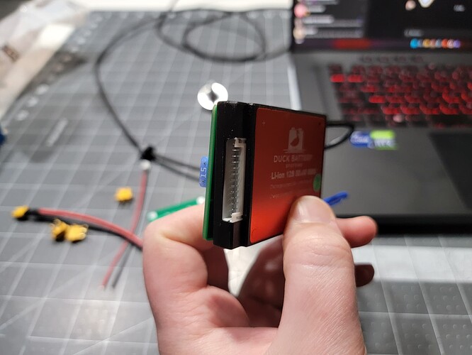

That looks slick af. New product? Is it good for 10a charging
Yes, yes, and yes :kissing_heart:
No promises on release date, I’m working on a couple new versions with more features.

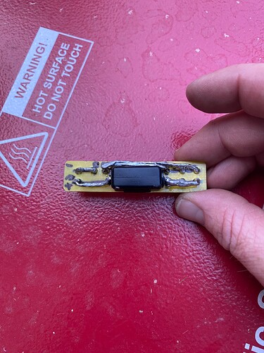

i got usb converter for my battery. 8-85v to 5v 3A with USB. , is it normal to see a little spark when connecting the 2nd wire to the battery? the unit works fine
Yes. Since there’s no precharge, anti-spark resistor to prevent it.
