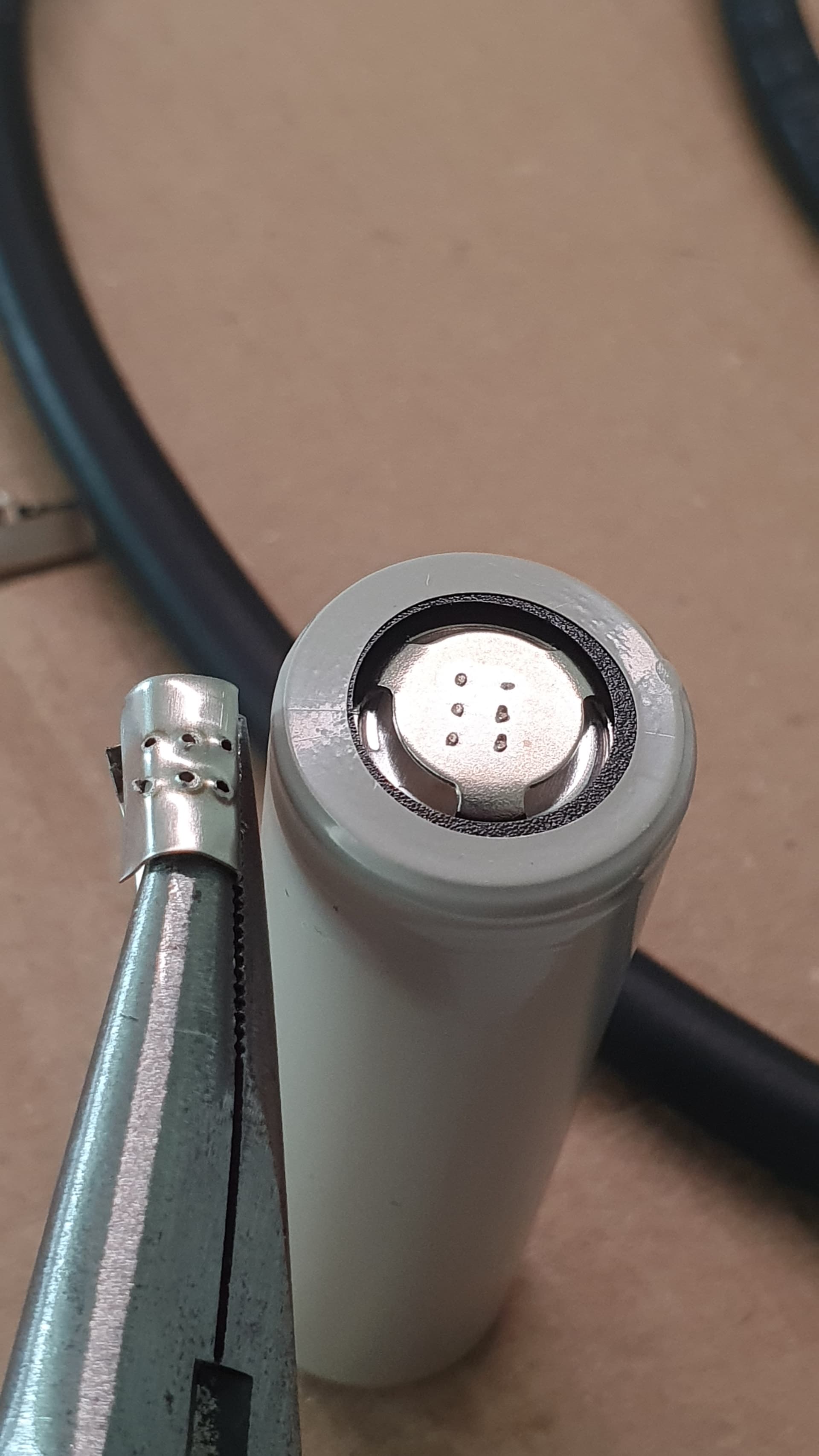

You should have the appropriate fish paper and shrink wrap, it helps hold the pack together which prevents stress on the weld/solder joints and protects it from shorting out on anything inside the enclosure when it shakes around

This is the stuff I’m using. Passed the salt water test and have had zero problems welding.

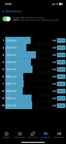

is this a bad bms? After connecting the unit one group shows much higher than the rest, i confirmed with a meter and there’s no pack with this voltage.
I set the pack to static balance but idk if its doing anything. I also don’t have the correct charger to give this pack some juice at the moment, can i use another charger, or does the voltage have to match even though I’m not charging to full?
I was able to manually set the correct voltage in this menu, is this a fix or will it there be issues going forward with this more than likely bad bms?

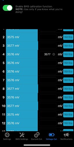

The LLT BMS I just installed is off by something like 0.15 - 0.165v per p-group, resulting in nearly 2 volts in total deviation across the entire pack. Is there a way to calibrate these things?
I haven’t messed with it but you should be able to set offsets in the voltage calibration menu to correct for that
That worked perfectly. I was expecting 41.92v after calibration, and got exactly that. Thanks.
