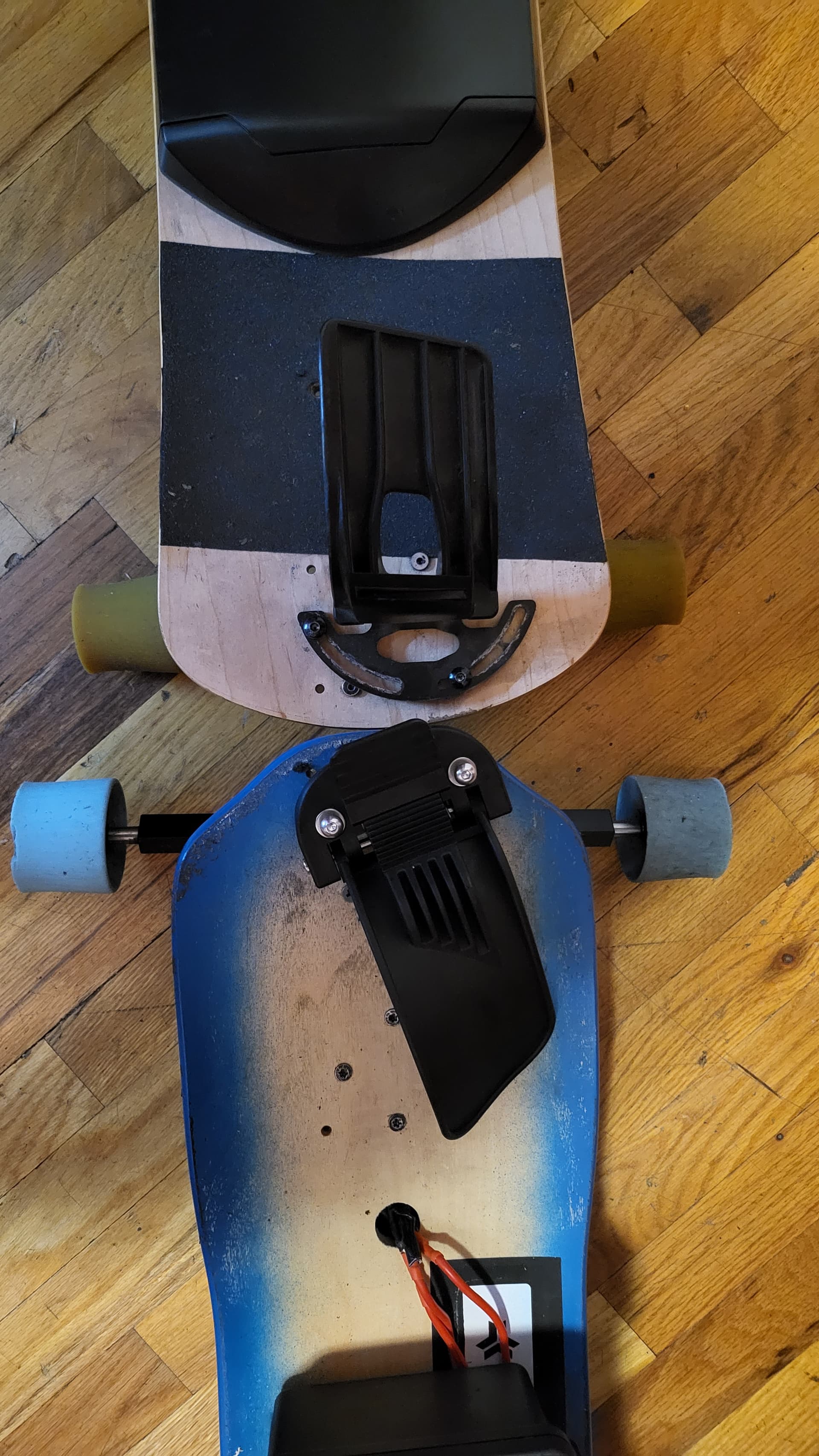

I wanted a more reliable summerboard so I replaced as many of the stock parts as possible. Still a work in progress.
Parts:
  • Stock SR360 caster.
  • boardnamics 270 hanger. No more wheelbite! better carve!
  • torqueboards baseplate. No more broken baseplates!
  • Xenith v2.1 ESC. Hopefully no more overheating!
  • Hoyt Puck remote. Stock remote is trash!
  • 12s3p. Finally a battery that Isn’t build like shit!
  • Orangatang fat free 65mm 77a blue. Better grip/rocker then stock wheels
  • Orangatang bushing hard. Better carve! Less speedwobble!
  • Freebord chaos maple 83cm. Quality deck that doesn’t start cracking the moment you step on it!
  • Tomiboi Ratcheting Toe-clips. Hopefully an improvement over stock bindings
  • MEIJIA waterproof hardcase.
weight 24lbs. sock weight 18lbs
Looking fwd to riding video!

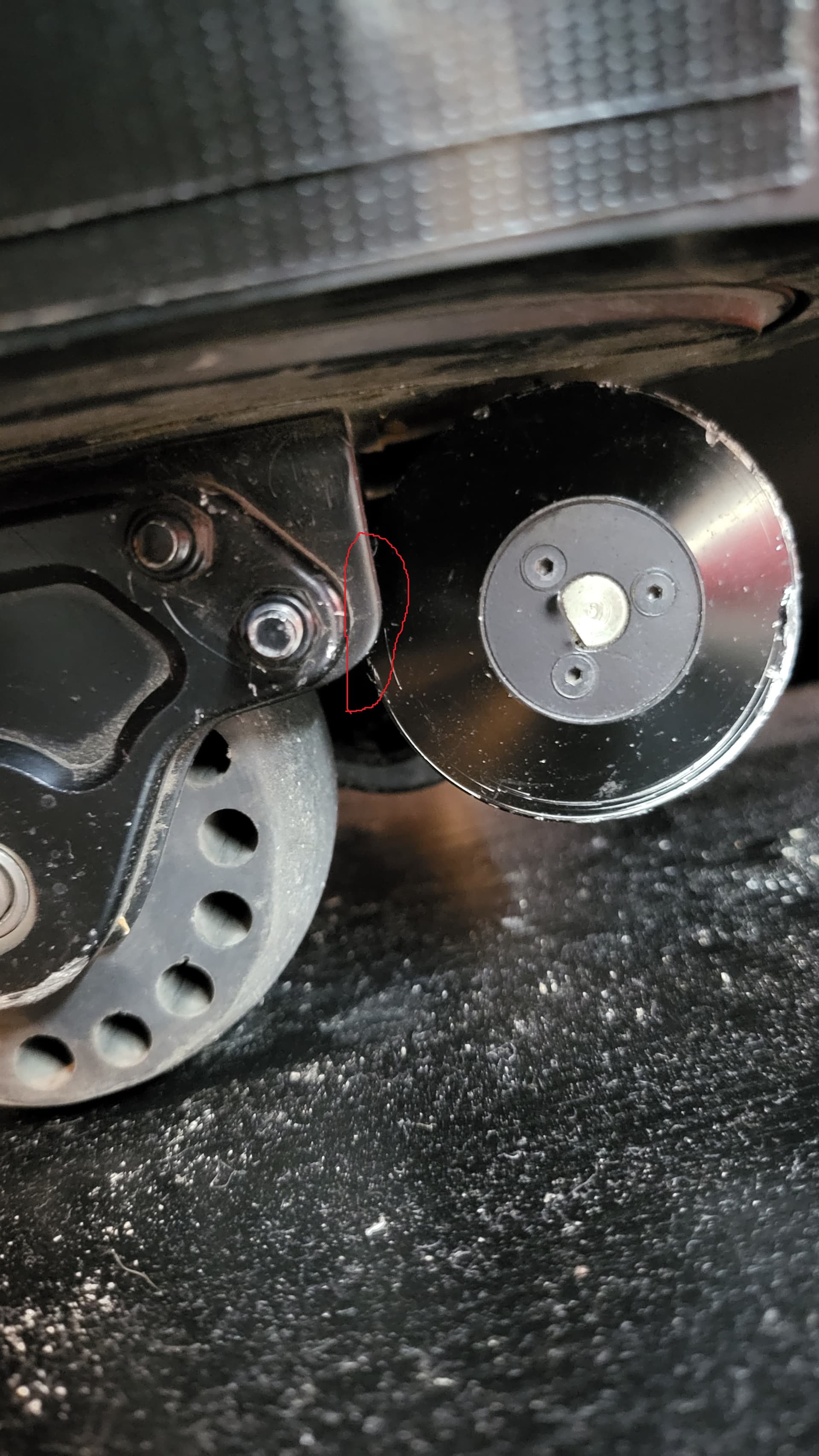

top make it fully top end wait for the restock of the new nylon castor slip ring bases… statoraid??? lmao
yeah I know they made new u-brackets aswell. I was also thinking about upgrading the motors but that would require cutting away some of the mount in order to fit longer motors.
you know if anyone has tried that yet?
Nope nobody tried. The thing I think someone might try getting higher KV motors to break some bones top speed records. That would require no hardware mods besides the motors.
