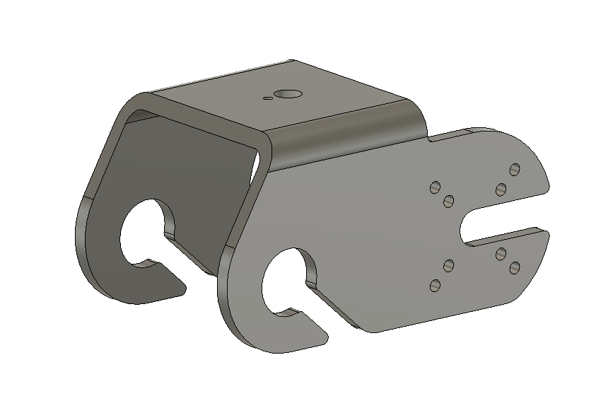

Update. Redesigned the whole caster bracket to be laser cut and bend into shape. same process as the original. Since everything is now once piece then it should be stronger and easier to assemble then before.
This design uses a wheel adapter that sits in the core of JMK wheel in place of the brearing. This adapter will get epoxied into place. The flanged bearings are mounted inside caster frame. The adapter will be keyd and this will allow the entire axle to spin freely. Spacers sit between the bearing and the wheel adapter.
Time to test sendcutsend!
Made the caster wider for more wheel options.

btw my thoughts on your interesting choice of bending your castor frame are that its probably cheap compared to buying large alu C channel extrusion and needing multiple CNC operations. My only concern is how accurate the 2 bends will be because that would determine how the drive shaft lines up and if the motor/wheel pulleys are exactly aligned as well. Very interested to see how well your belt survives testing.
Are the flanged bearing temporary? They do lend themselves to a very economic solution as you showed.

Damn forgot about this project lol. Yeah I plan to keep the flanged bearings in the final part tho.
Did you get the part and to what cost/delivery time and would you recommend them? Thickness and material?
Took about 2 weeks. Cost was like $40 per caster but I only ordered one and their pricing decreases with the quantity you order. Don’t remember exactly but I believe I used 3mm stainless 306 or 603.

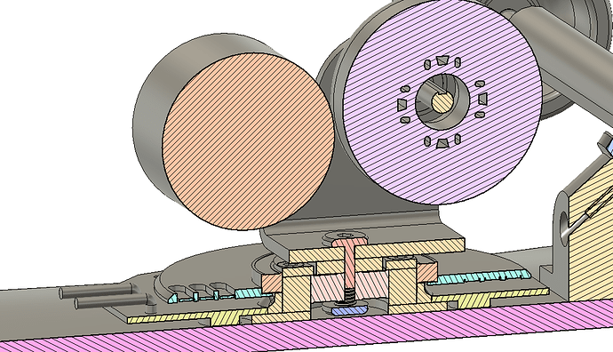

the original plan was to use a custom made slipring from moflon.com but after I realized the cost involved in custom making a slipring($150-200) I decided to use some of the old leiftech/sbx sliprings I had lying around. I do still plan to have a custom slipring made in the future once I have verified that all of the caster parts work.
I had a slipring with a broken housing with got me thinking. I could just print a custom housing for it. most of the issues with summeboards sliprings seems to come from when the brushes loose contact and ark/short against the rings. so If I could press the two half’s together in a more reliable way then it should eliminate some of the failures that come from the original design.
The design is inspired by the M1 Otherboard caster. Final version might even be interchangeable with only the fork being different.
I still got to make a wheel adapter and figure out how to lock the wheel/pulley/shaft together in a reliable way. Final design will have a pulley idler as well.

this appears to have a secondary bearing for sealing the SR360 disk plate, looks slick! totally makes sense why Aaron removed the pegs there, only the wires connect rotationally?
Any chance you want to share the sbx brush PCB CAD file?
I wonder if its worth putting some metal cover over the base/plastic slip ring part.
