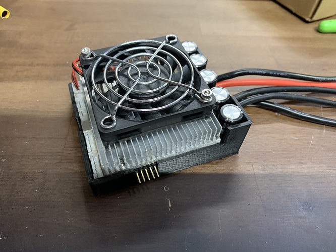

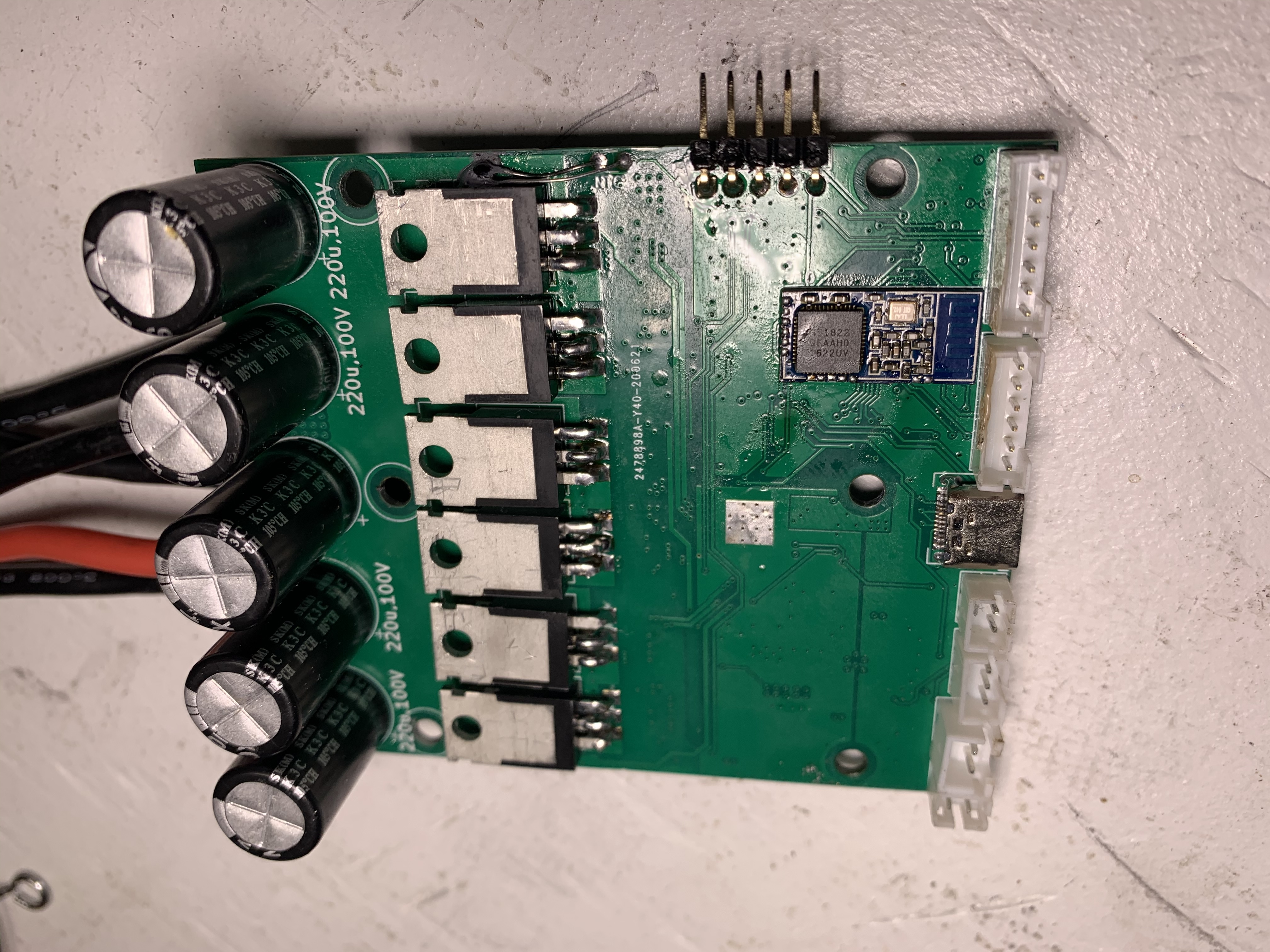

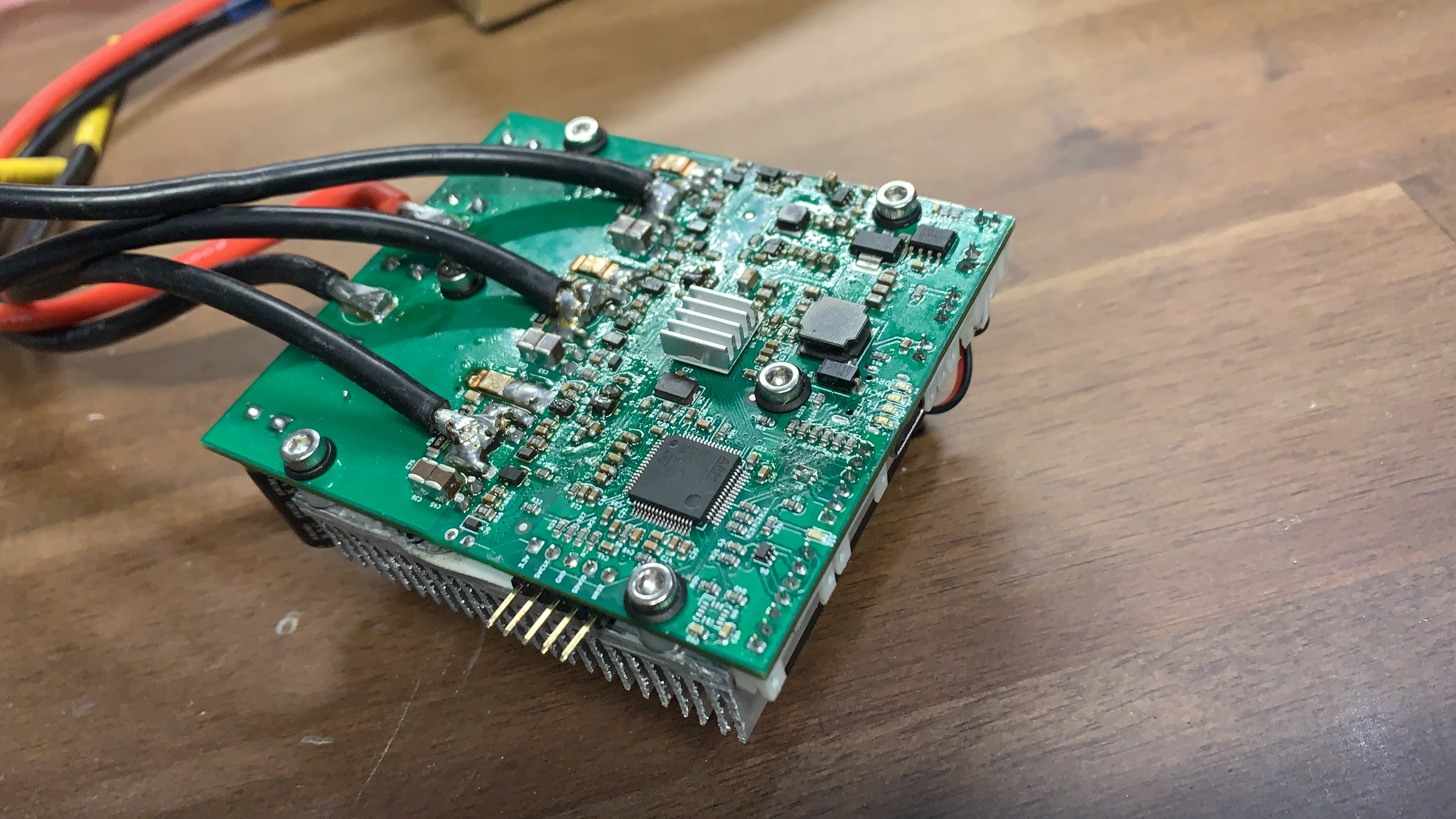

Been working on this revision. I decided to change the layout in favor of higher reliability for the gate driver and MOSFETs. The dimensions are 72mm x 84mm x 25mm(ish). This is overall a 16% smaller footprint than the previous revision with the caps mounted horizontally.
I just field tested this on my ebike at 70A 72V(20s). Ran great after dialing it in (upped the time constant and used motor sat compensation).
I tried to implement an NRF module but I messed up which pins on the MCU can be used for another UART’s TX and RX. Turns out it’s not arbitrary (I didn’t read the datasheet like I’m apposed to…) Will be seeking to fix it so an NRF module can at least be an option. The goal is to also allow the caps and/or connectors to be soldered on the opposite side if needed. Would be an option available for bulk orders.

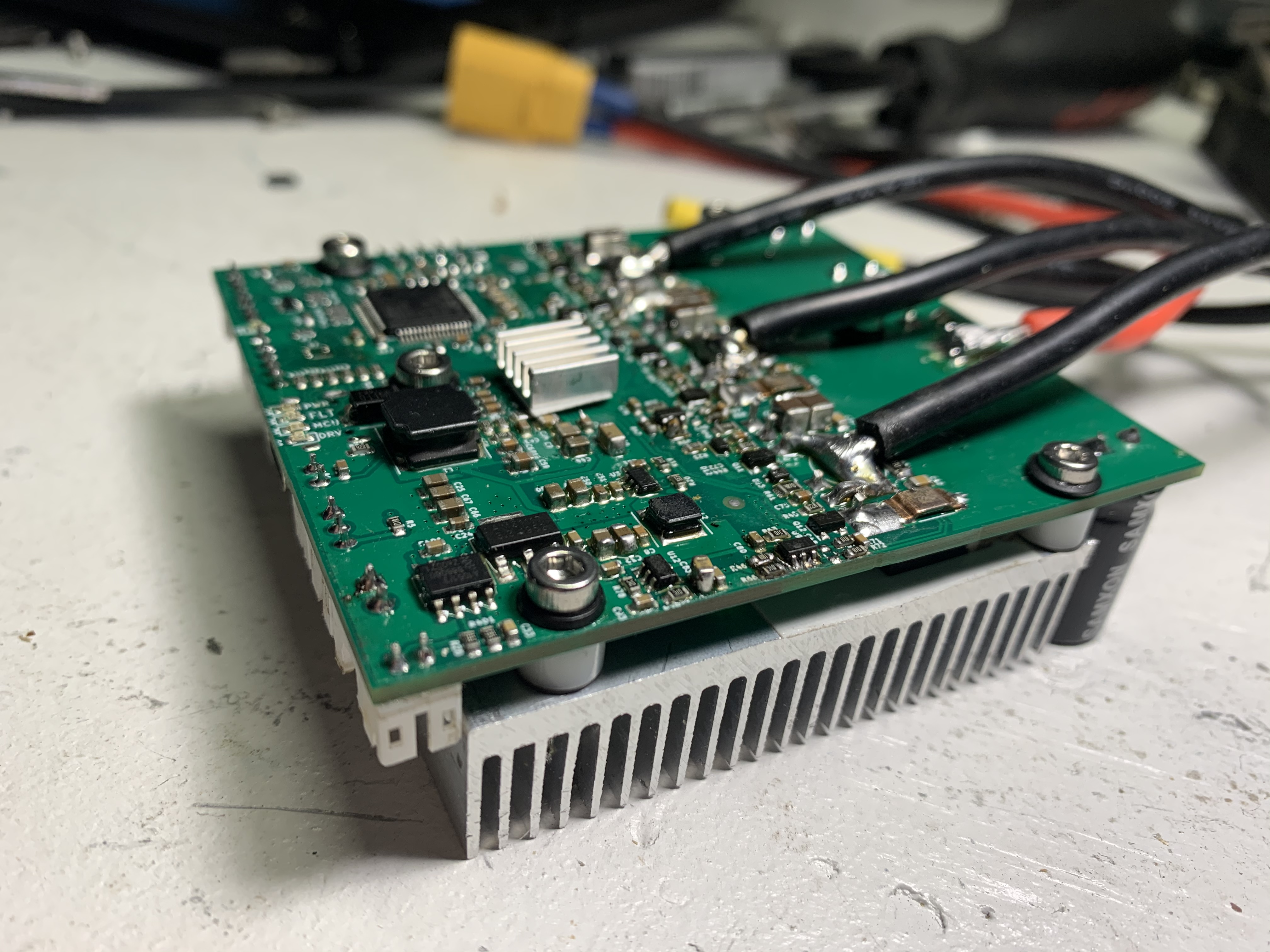

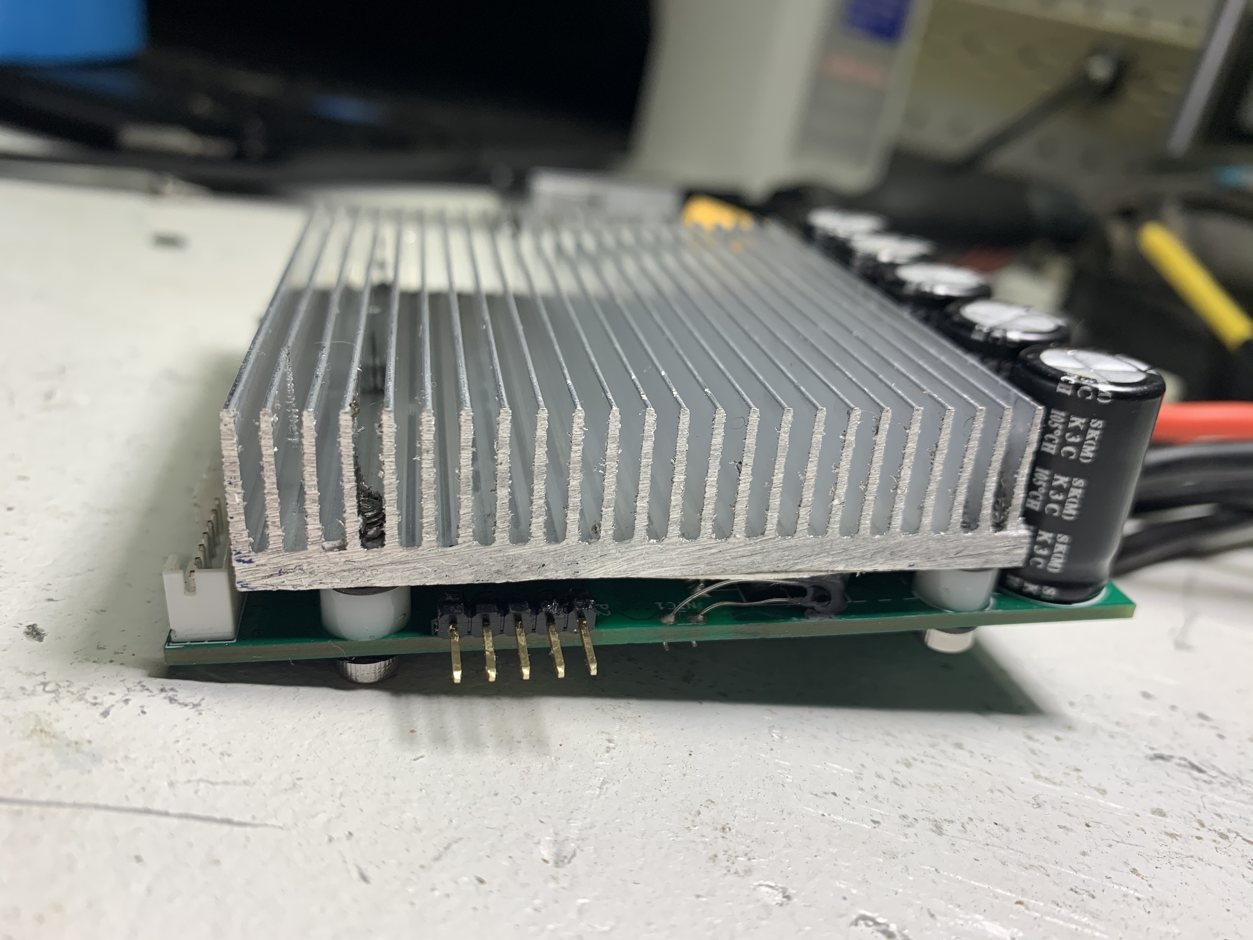

pics with heatsink to follow…

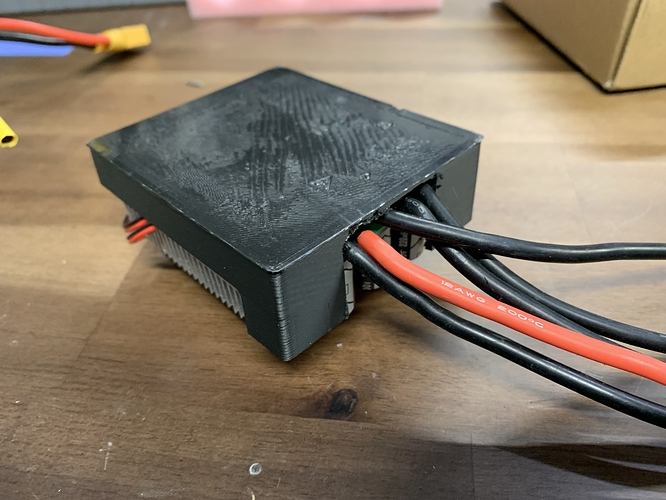

Beefy heatsink. The idea is that a top cap can be designed to fit over the top side. 3D printer, injection molded, or even cast aluminum for even more cooling.

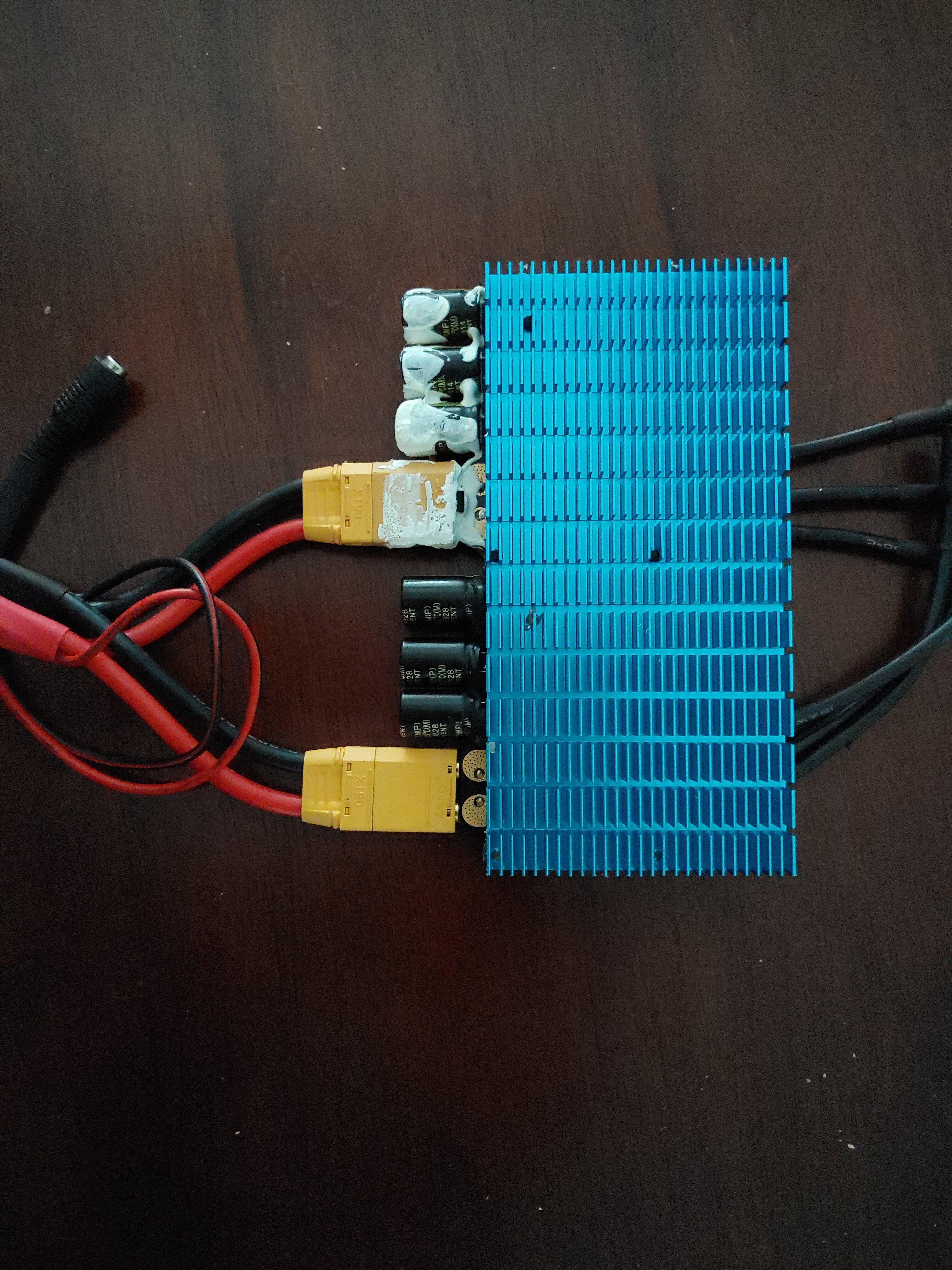

Someone posted this up the other day, not sure which thread but hope it wasn’t this one! This sink is 10mm tall stock.
https://www.amazon.com/dp/B07V7WQVB1/ref=cm_sw_r_cp_apa_i_gcKaFbECH3G5A
Sharing a single piece of heatsink(we dual ESC 97% of the time here) is more efficient than two separate ones afaik, maybe there’s a better heatsink out there but this is close unless there are FETs right up to the edge of the 84mm dimension.
It would help for the vertically challenged.
EDIT: I see the capacitors(Samxon 220uF which is 21mm long) make it no difference to go to a shorter heatsink. Maybe there is a shorter cap option in order to fulfill that remit? Something about 15mm-16mm tall, with a 10mm heatsink and 5mm(?) standoffs total height above pcb could reduce by 5mm.
And since there is components on the underside of the pcb, maybe there is real estate to have smaller Aluminum Electrolytic caps on the underside to equal up to a single Samxon 220uF.
So even shorter again on the flip-side, like so 12.5mm (could be ignorant here I’m no EE don’t punch me too hard)

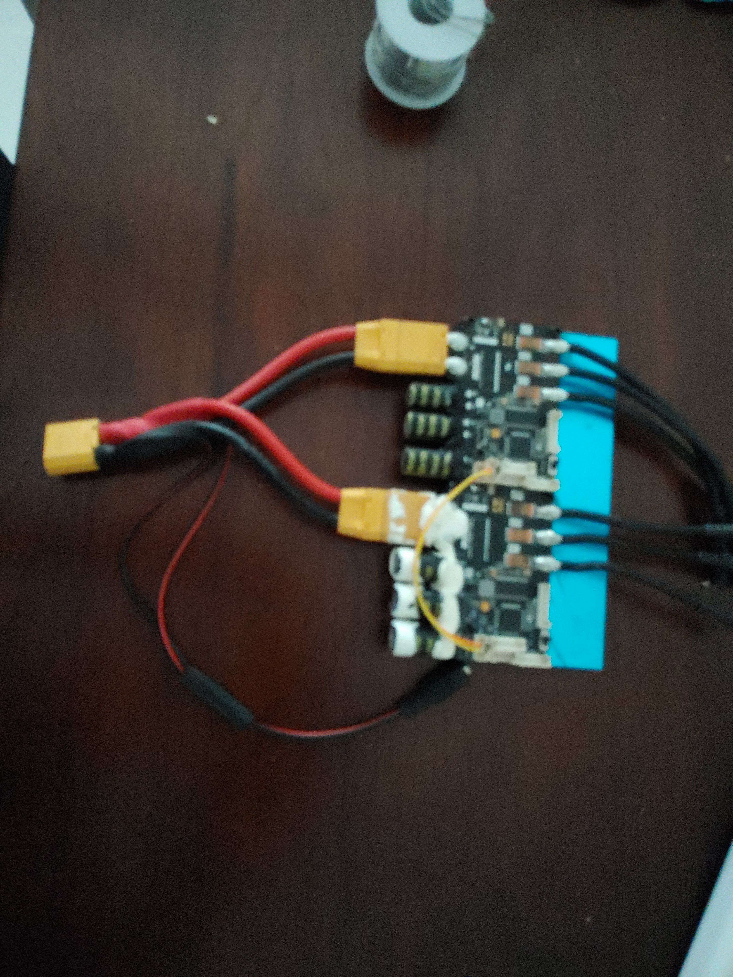

Is that a flipsky dual taken with a flipsky camera?
grainy AF
DIY flipsky dual it’s 2 X FS 6.6 I repaired there is a 20mm copper shim and heat transfer pads under the fets. Bad photos are my specialty.
I don’t want to reduce the amount of capacitance. I could possibly look at the option having the Caps horizontally like the previous revision but that will tack on 20mm of length. This would allow for a slimmer heat sink. What do you think is the more important dimension here to optimize? Length or girth? (giggity)
:laughing: The general consensus is one half a dozen of the other but the one thing that gets em riled up is too much height and too much length (or width!). For this reason dual ESC is favoured since that is the most used platform, hence the huge popularity of Unity.
So what we see here is 25mm-ish or more with additional cooling. The caps on their side would work and most do it that way, footprint notwithstanding.
A custom CNC’d heatsink is another way to offset height and this is what the other guys do typically, of course this ends up costing the consumer more nut yeah height would be the major concern. In saying that eFoil, eBike etc typically need one ESC and care little about that.
If you care about high voltage market adoption by esk8 it can’t be ignored in which case you need to research the high-amp VESC6 product range by these vendors (maybe include ZESC & Maytech as well)

Seems about 25mm of height is about right. One key property I’m trying to hit still is cost. This isn’t meant to be the smallest, or most powerful, or highest end controller. It’s meant to be the best bang for your buck while still fitting the bill for typical power needs.

  4. A case design is in development. Can be 3D printed, injection molded, or even be cast aluminum.
