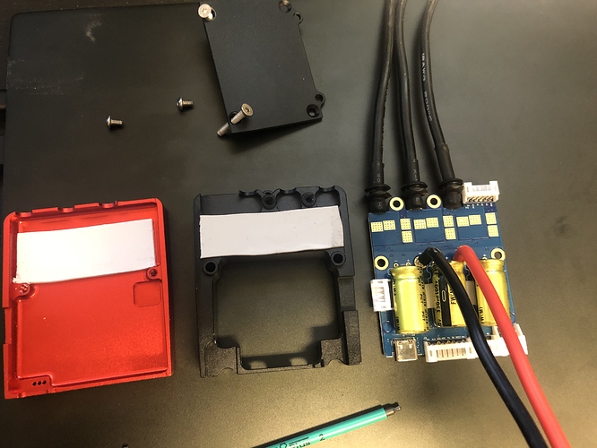

I only just got the production 100S and I only had one prototype 100S before. Here are some comparisons I guess
As for the 100D I’m not testing it in ways y’all would be interested in sorry

Sorry, I thought it was. I hope I’m not giving away any state secrets, as the 100S is essentially a 100D divided in half without the AS.
Also, the 100S feels cold to the touch, because the entire body is an aluminium heatsink.
