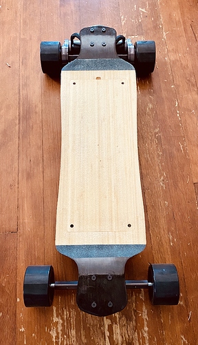

I’ve been been working on a hot-rod. Low, wide and fast… really fast. Here’s what I’ve got going on.
I designed a 37.5" deck with a 1 1/4" drop. It’s similar to my 42" boat the “Pale-horse”, just shorter and the styling is a little different. I used black stain on this one, not black paint so that I can still see the grain of the bamboo. Under the fiberglass lay-up it looks beautiful and is well protected from scratches and gouges. I went with clear grip because I liked the contrast of the natural bamboo with the black stain. There is some glow grip speckled in because I’m a dork.

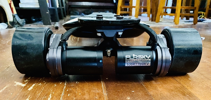

The drive system is 3D Servisas Fatboy SS Mini with helical gears (1:2.4) and 260 mm hangers. I went with the largest motors that the gear-drives and hangers could accommodate, 6384. These ones are Flipsky 6384 190kv. With the 1:2.4 gearing, this thing should be able to go really fast. As a suggestion, if you order gear-drives form 3Ds, ask for them to be assembled with the drives positioned properly for your build if possible. Red thread-lock is used, which isn’t meant to be unfastened like the blue stuff is. It is extreeeeeeeeemely difficult to adjust the position of the drives.

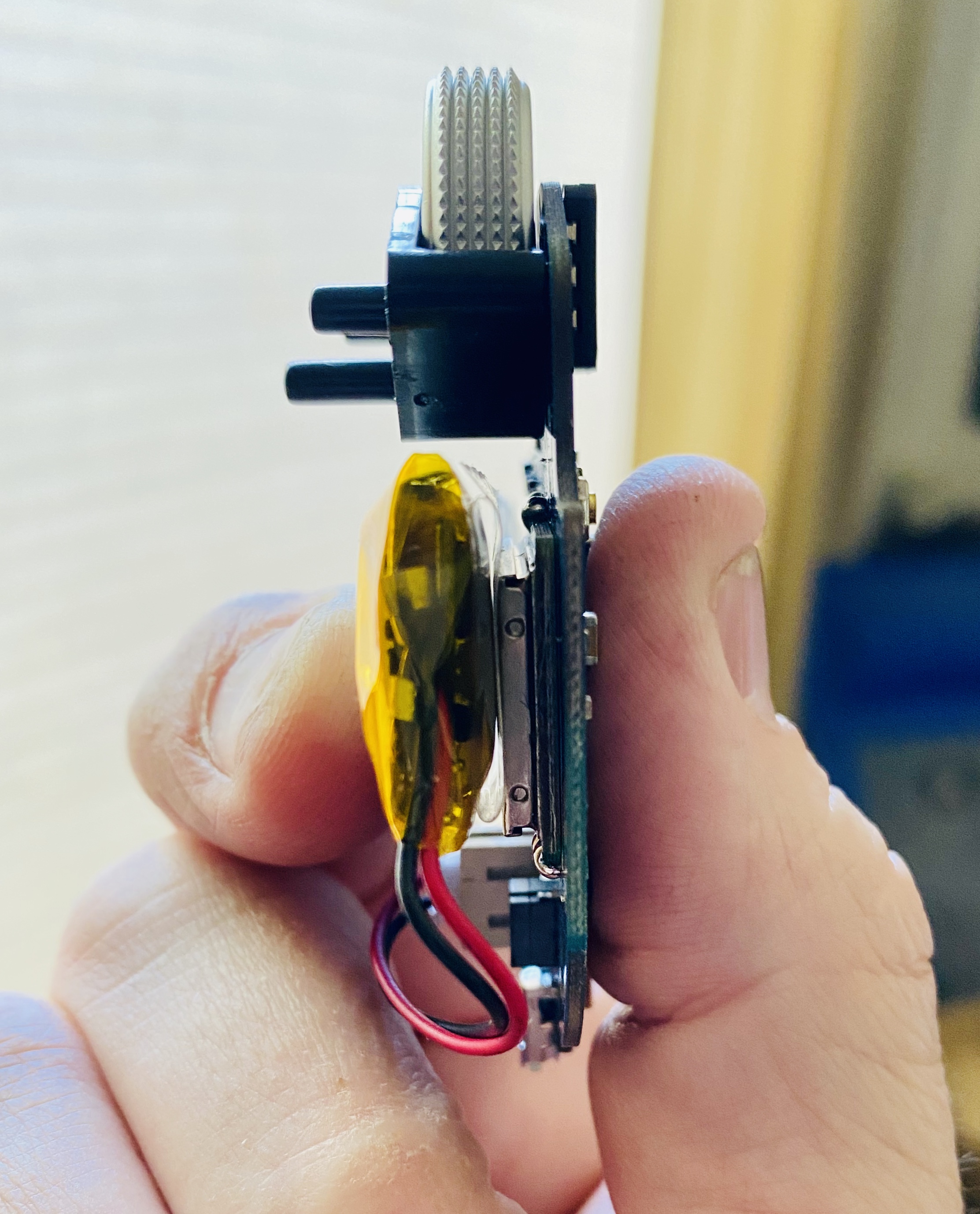

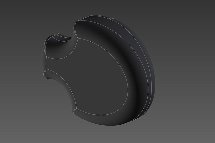

Hoyt has really gone wild with the puck. I hadn’t tried it until recently, and though I have my gripes, I mostly like it. A fatter thumbwheel with a bump on it would be nice and an oval remote shape would be more ergonomic, but then they couldn’t call it the “Puck”. Regardless, I’m having some fun with it. It’s solid and works well. Also, they have all of the colors and three different spring tensions, which is really nice for the DIYer. Lastly they sell the guts so you can make your own enclosure. So I am. I’m going to switch out the battery and remove the plastic housing to make it quite a bit thinner. Also, I’m going to use some really nice West-African Ebony hardwood to make the enclosure. This stuff is beautiful, exotic and rare. If it were any harder, it would be petrified. And it is jet-black all of the way though. I hope that I don’t accidentally fuck it up :drooling_face:
Now, the puck doesn’t have a little screen with all kinds of info on it, but I’ll survive. Honestly, I mostly only use the screen for battery-info, and the Stormcore button has me covered there. Also, the built-in Bluetooth on the Stormcore easily connects to Xmatic and the VESC app. So I’ve got telemetry covered.

Check out different Puck thumb wheel mods here.
And as @Jujo said, I recommend swapping the Puck shell for this one you can download here

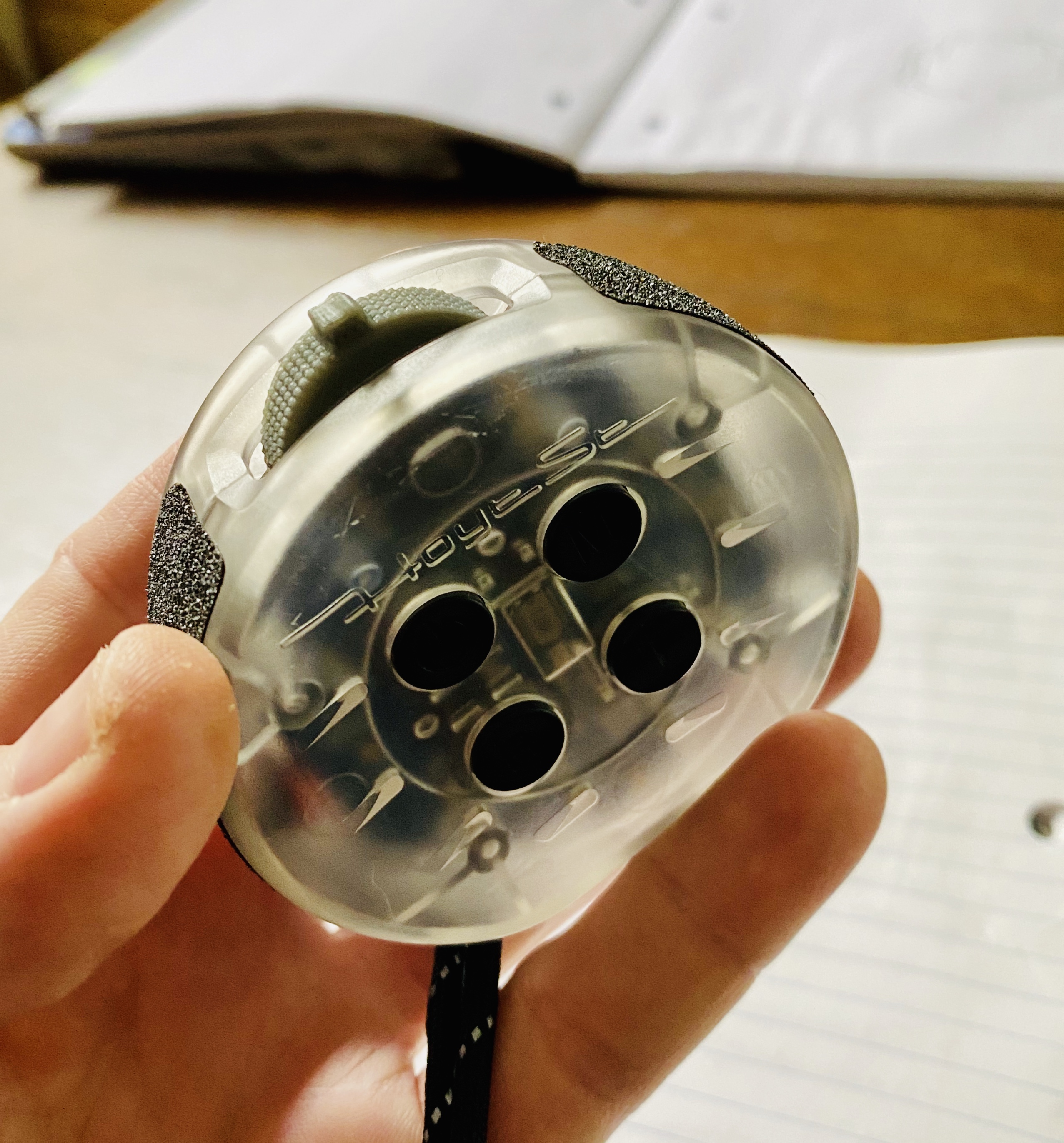

Has anyone tried printed the thumbwheel with flexible TPU filliment?

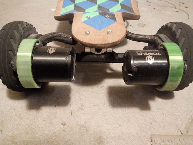

I need to print up some full-guards for my gera-drives. I had to put them in the lowest position to accommodate the motors. They’re hanging low and they are so damn pretty. I don’t want to scratch them up.
Not that I’m aware of, though I could see it working printing with 100% infill. However, I would feel more comfortable with a solid thumb wheel, just my gut feel on that one.
Regarding motor mount guards, I just printed some after realizing how often I rest the board on them. Now I don’t have to worry about scratching them.
I’m going to try the flexible filiment for science.
I bet you could do it with either a high shell count or high infill, the TPU I have is pretty hard if it’s fully solid

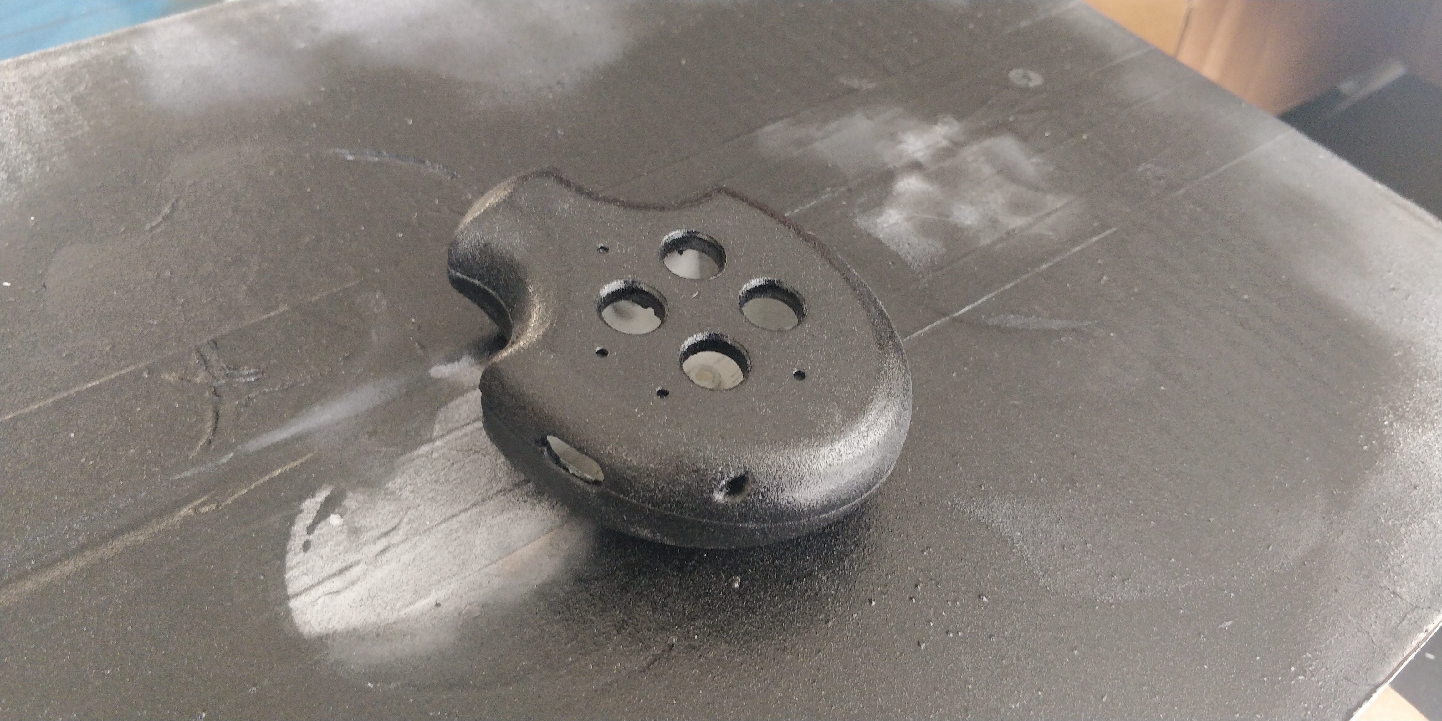

I printed a thumbwheel with a bump for my puck and it is a definite game changer. This one was printed with flexible filament and a 30% fill. It’s a touch more comfortable, but the most noticeable improvement is with regards to grip. It’s definitely grippier. I tried it with 20% fill and the thumbwheel was too flimsy.

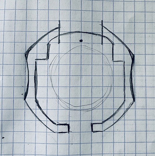

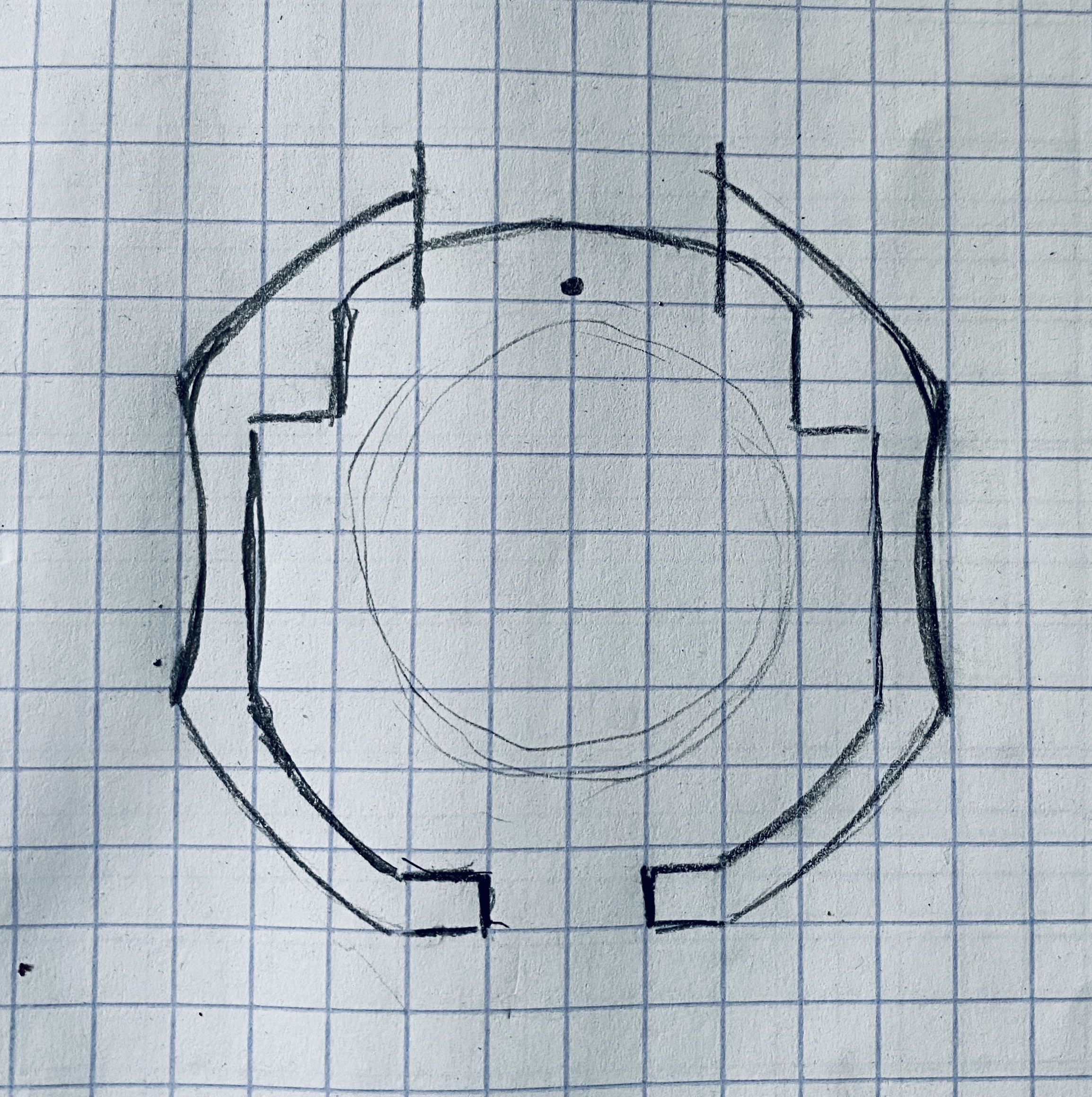

I’m starting the CNC milled enclosure. By removing the battery housing and replacing the battery with a 600 mah lipo, I should be able to make the puck 1/3" thinner. I’m also going to make scallops in the perimeter to fit the meat of my palm and fingers. Something similar to the shitty drawing below.
Hopefully, I’ll have a battery by the end of the week and Sizzle-pants will be rolling. I’d like to get some riding in on this one before winter comes :cold_face:

wow, that clear puck looks gorgeous!
