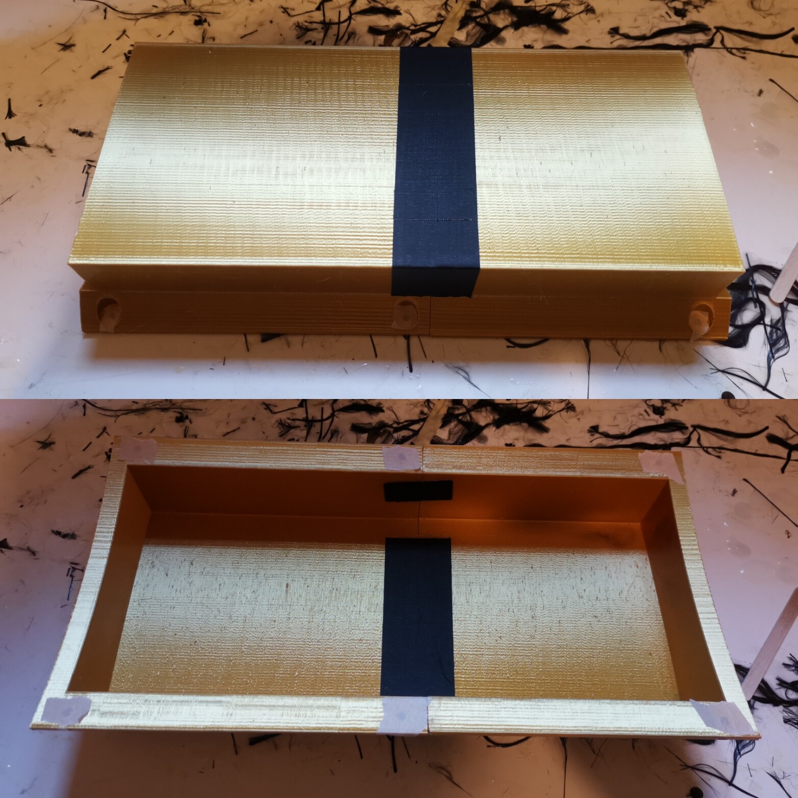

I printed this in PETG. Not sure who originally made the STL for it, but I cut it into 3 parts in Shapr3D.
Excuse the messy print, it was a first try on that material and first enclosure I’ve done. I don’t like the gyroid infill artifact that shows on the surface.
Will reprint middle segment.
