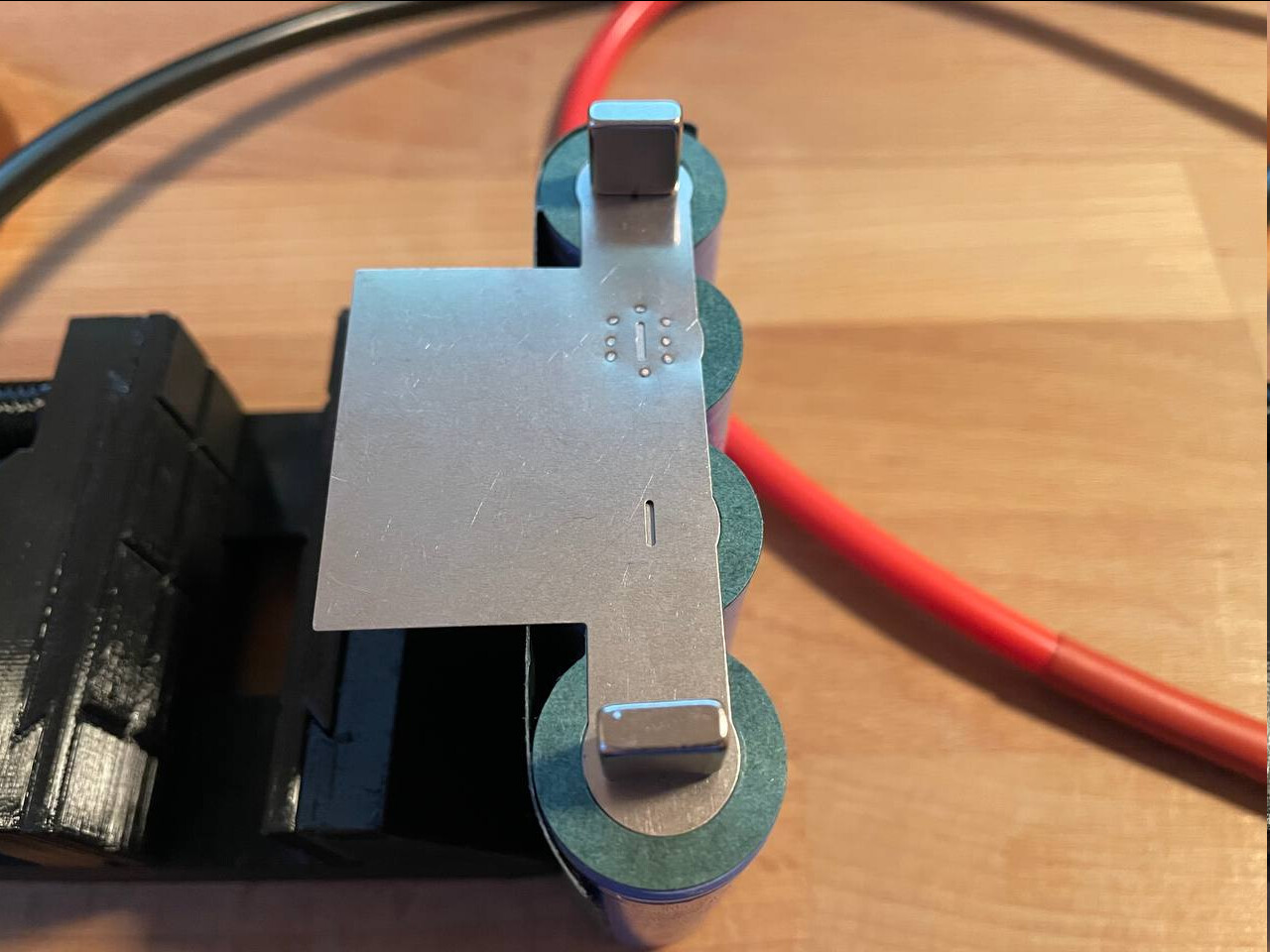

You passed the “fish paper between pgroups test”

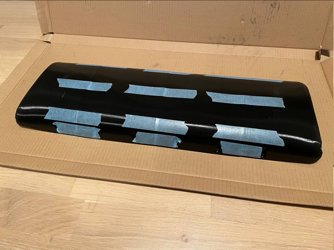

Is that a FG sheet reinforcement on the enclosure?
Yeah, the 4 parts were all over the place with gaps etc… fibreglass/epoxy did the trick.

I hate asking that like a leech but would you mind sharing the file for the enclosure ?
We have the same deck and I’m not satisfied with mine (I had to go with huge gasket to accommodate the shape)
How did you make the curves on the enclosure in cad?
I’d like to make a round of improvements since some parts (where the bolts are) are not strong enough at the moment (ie. light cracks can appear).
I can share the current state though, just don’t expect 100% awesomeness yet.
@YeetMeat I used lidar to scan the deck and design around that in Fusion 360.
You have a 3d scanner ? nice !!
have you reinforced the hole with fiberglass also ?
iPhone12 Pro, no fancy scanner :shushing_face:
https://www.prusaprinters.org/prints/65930-skateshred-b41-enclosure
I would recommend reinforcing the bolt holes on this first version with fiberglass, yes.
Part 1 can be printed twice instead of part 4, if you don’t want the holes for XT90 loopkey, esc switch etc.
