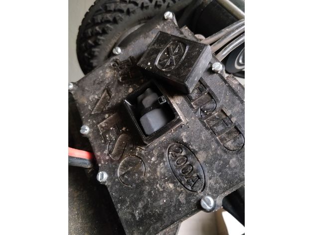

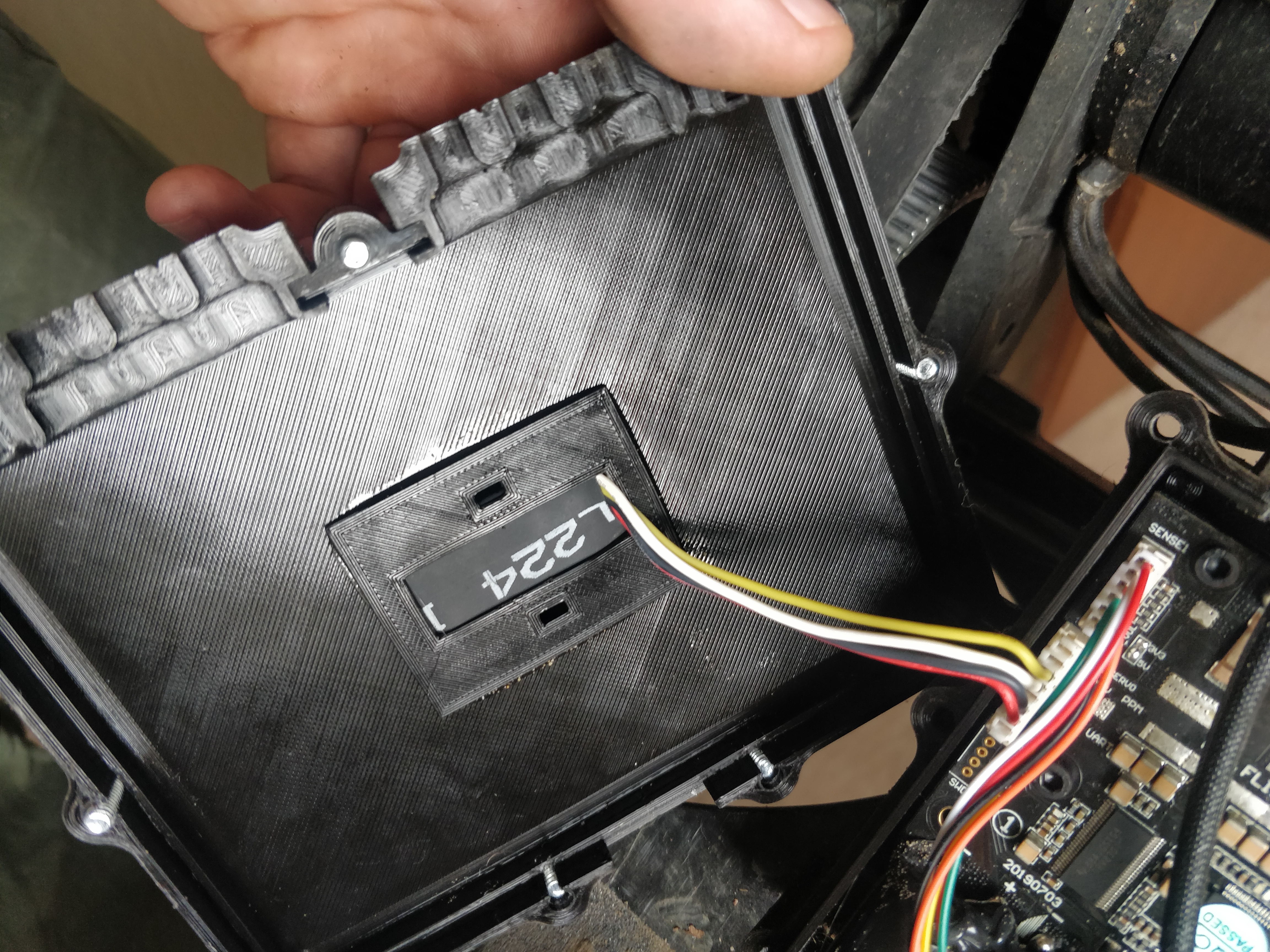

Started with 3 printed parts glued together. 6 layers of carbon fibre cloth later its near indestructible.
Single print enclosure for my mini cruiser:
Can fit a 10s3p and a lingyi esc
Build thread: Portable mini cruiser | Landyachtz dinghy | meepo hub motors | meepo esc
