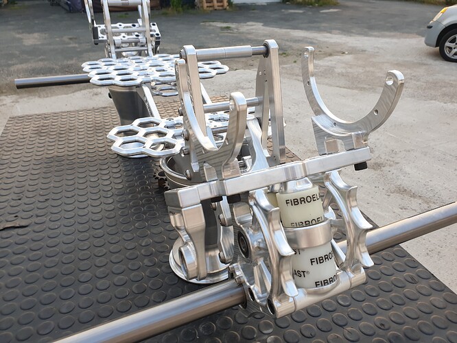

DRIVEN TRUCK - like a UTV the complete AXLE works as “Hanger” and is driven through center chain
2-stage
FULL AIR SUSPENSION : NOT with crossdirection whishbones BUT with longitudinal direction whishbones - PROS : you need just 2 (not 4) and the complete steering principles stays the same
VERTICAL CHASSIS PLATES - 2MOTORS-4WD-LOCKED DIFF , just the consequences of it (-:

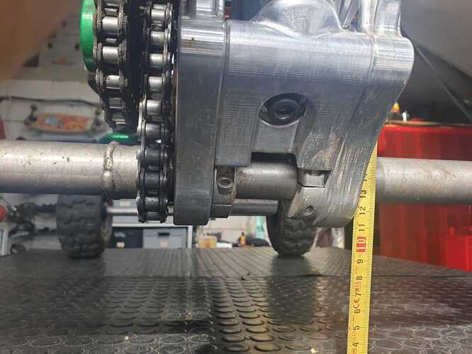

OUTER SPURWIDTH 780MM
GROUNDCLEARENCE under TRUCK 110MM
GROUNDCLEARENCE under STANDS fully expandet 170MM
GROUNDCLEARENCE under STANDS fully COMPRESSED 55MM
GROUNDCLEARENCE in MIDDLE / DROP fully expandet 200MM
WHEELBASE FULLY EXPANDET 1020MM

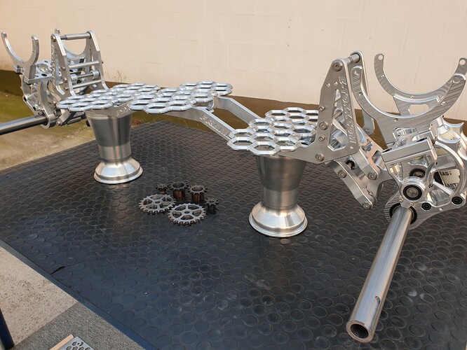

You will have a complete Chassis Kit, looks like this :
(SPROCKETS AND CHAINS ARE NOT IN POSITION ON THIS PICTURES)
FAT AND FLAT IN NEUTRAL POSITION - LONGEST WHEELBASE
FULLY COMPRESSED - THIS IS SLIGHTY MORE THEN WITH MOUNTED ROCKSHOCK POSSIBE
FULLY EXPANDET- THIS IS SLIGHTY MORE THEN WITH MOUNTED ROCKSHOCK POSSIBE
KNUCKLE BATTERING RAM / STEERING UNIT
UNDERSIDE COMPLETE (WITHOUT STAINLESS SKIDPLATE)
UNDERSIDE COMPLETE (WITH STAINLESS SKIDPLATE)
STEERING UNIT FROM UNDERSIDE - INTEGRADET SKIDPLATE -
HONEYCOMP MADNESS
HOLLOW AXLES
Besides from the 30 CNC Parts we have alot Rods, also lathed and drilled
made from Precision Shaft Steel Material CF53, Hardened and Ground , bothsided Threaded
Alloy Chassis Connectors and Spacers for Rockshox

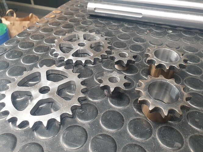

Sprockets ISO08 size better known as 428, Motorcycle stuff

30 CNC PARTS FROM 7075 ALLOY
26 RODS
1 STAINLESS STEEL SKIDPLATE
2 HOLLOW TRUCKS 660MM WIDE
8 SPROCKETS
4 CHAINS
4 SHAFT COLLARS - CLAMP COLLARS DOUBLE SPLIT
4 SPHERICAL BEARINGS
4 NEEDLE BEARINGS
8 BALL BEARINGS
76 CYLINDRICAL BUSHES,SELF LUBRICATTING
4 THRUST WASHER
8 ELASTOMERE BUSHING
ALL SCREWS ETC
SPROCKETS WELDET ON DRIVESHAFTS / TRUCKS
THIS PACKAGE COSTS 2970€

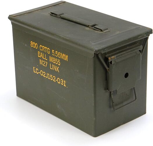

BATTERY BOX
AMMO BOX SIZE 3, from US ARMY
800 Patronen Kaliber 5.56 (Größe 3)
310x175x220 OUTER DIM
300x170x210 INNER DIM
30€
