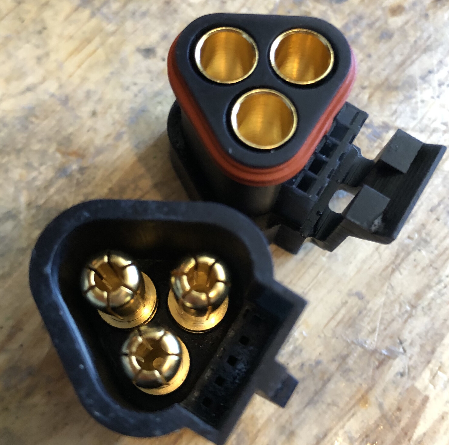

We divide 8awg wire to 4mm bullets @ the Trampa but with this application we have only the wire between the rider and the motor. A clean disconnect seems ideal. We plan to pour polyurethane boots on the connectors so they last. I don’t want to get stuck 20 miles out -20C
We tried multiple bullets but when crashed they yanked out. Hours have been spent in the snow trying to arrange them properly.
As to the gearbox we have felt 2400rpm and dont want to drop it
If we can’t get the DD to work we will add planetary interchangeable gears.
*Normally connectors are designed to lock. We need a break-away connector that won’t break when yanked.

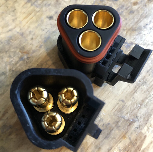

They are currently 5 pin but could be 6 pin. (Thought to put them on amazon)
They do lock but the lock has a 50 degree tab vs 90 degree, so it take some force to lift over.

Are the data pins water resistant also, or just the power pins?

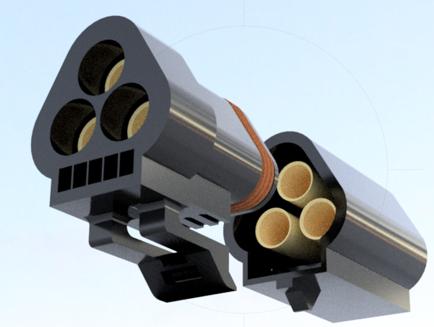

We are making a boot mold to pour the back of them sealed in polyurethane. I want to be able to literally yank them and not effect the terminals.
The data wires are not sealed inside the plug only the current. (We use a common deutsch seal)
The 3 XT150 provide a snug fit.
We spent over a week on broken prototypes… I am sure we will need to tweak them with a few more revisions.
6 data pins would be a lot better though
not a dealbreaker for me
think I can change a 5 to a 6 in the cad file
I’ll make you a few when I know they work. (The internals on the JST terminals are a pain to reverse engineer)
