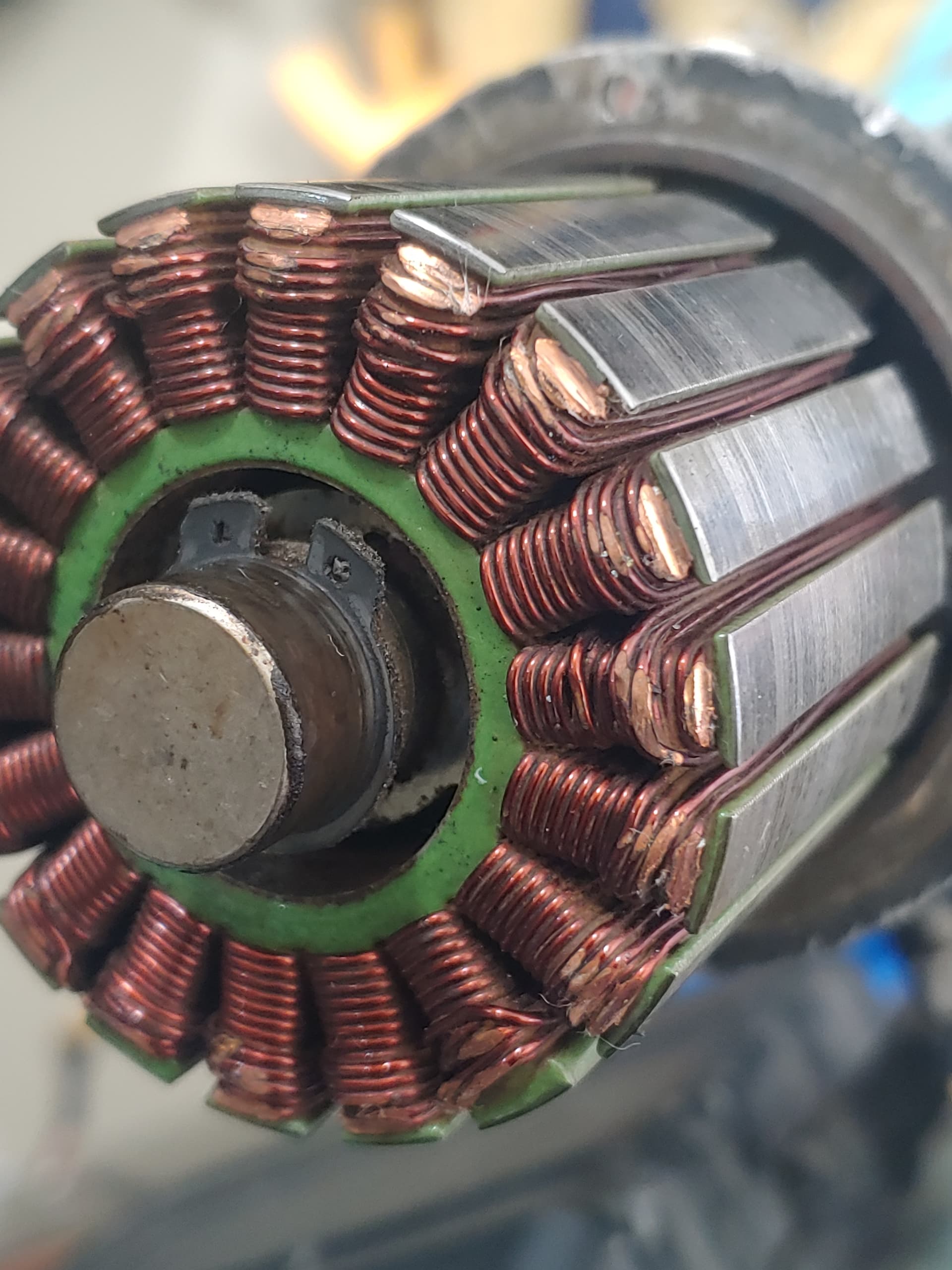

Also holy shit I was cutting it close with my hub motor last night. Any more use while the washer was broken in half and in it and the winding would have gotten cut through completely
