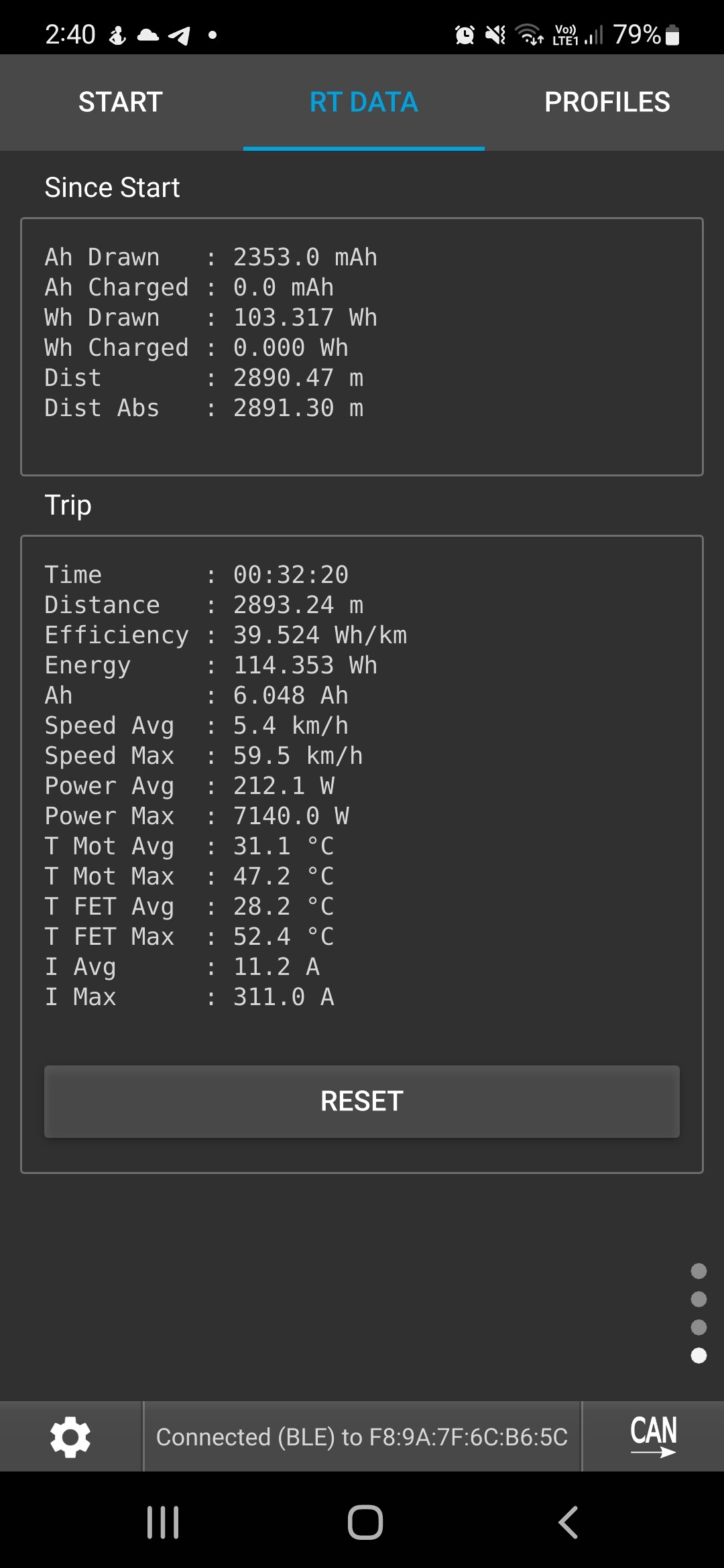

Over 7kw actual power

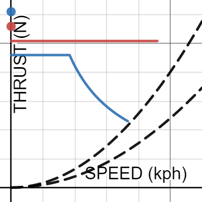

Alright, if SRB has a flat torque curve and the max motor current is the same as the 225A max battery current you posted before, the peak performance looks like this vs my bikeboard:
(I took your calculator and rescaled it to Newtons of thrust, and added standing/tucked rider air resistance for reference)
I’d like to see how other builds look like graphically, the numbers are a bit much to digest lol
