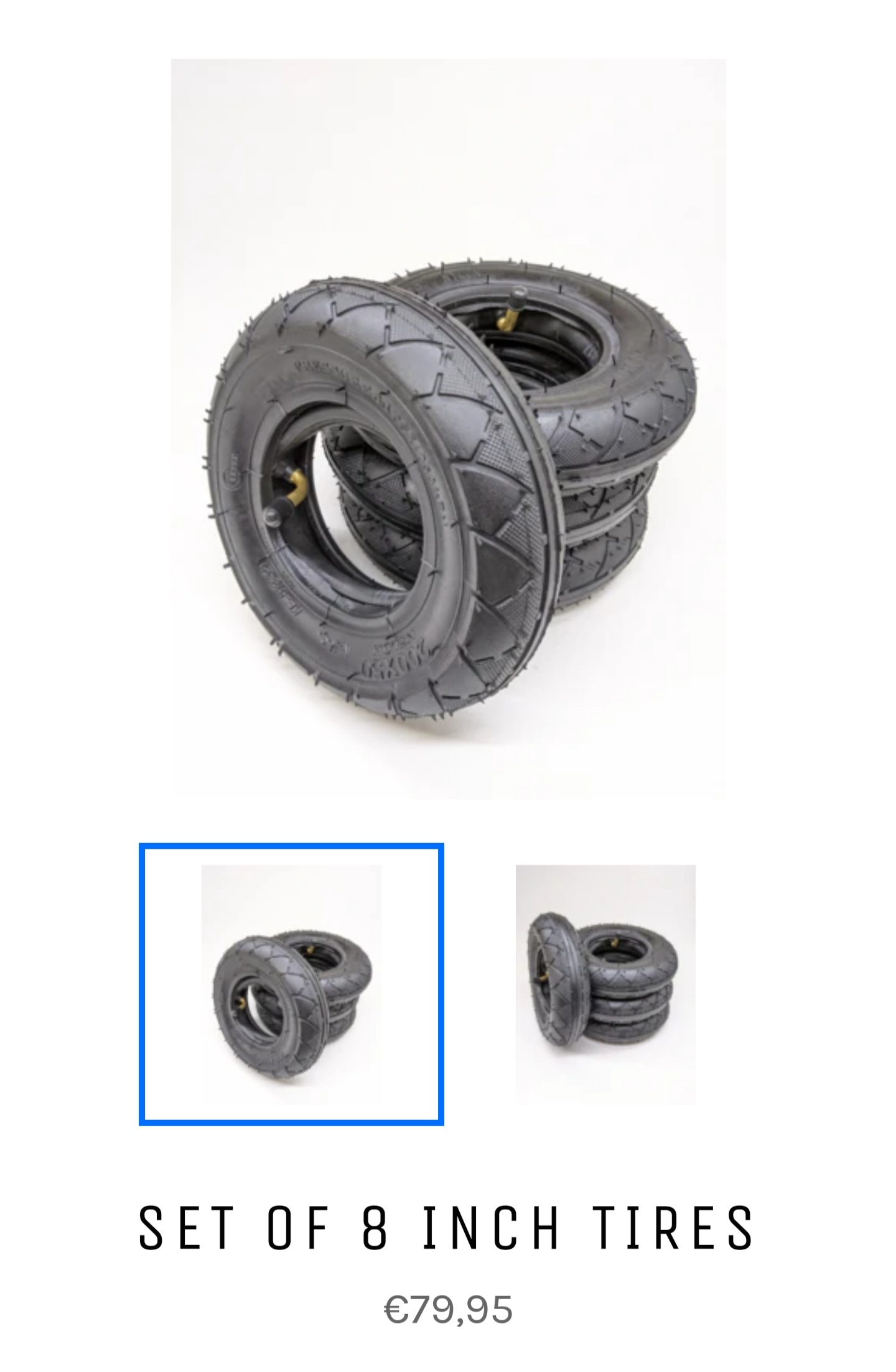

Anyone ever tried these tires, not branded on the website so I can’t tell what they are. I figured someone could tell me that too.
Hover on the label.

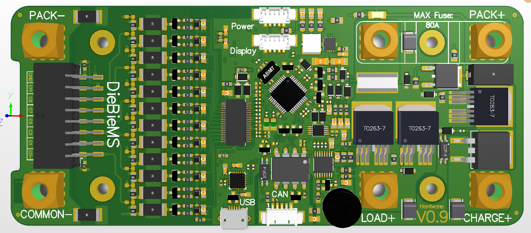

While discharging one p-group always gets out of balance even after replacing it, could I work around this somehow if I go charge only?
If I go charge only, I would have to change the load+ to pack+?
Or is definitely something wrong with the balance wires/a balancing part on the bms?
my diebie did this, but when doing nothing. does this also happen if you just leave the board sitting overnight?
yes
so yeah…
